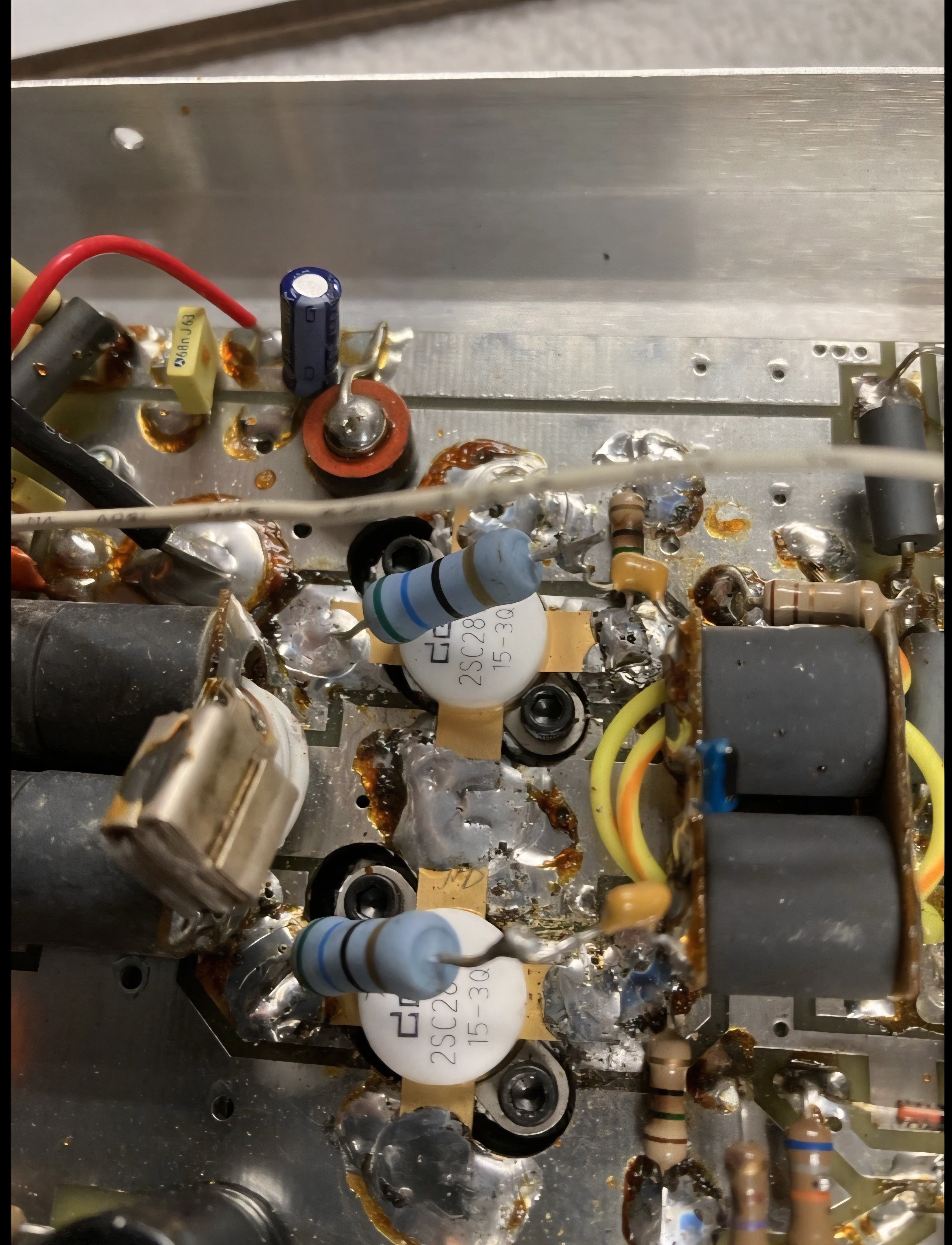

I bought the amp knowing that it does not work and all the seller could tell me is that he was told that it does not transmit. It's currently heading towards me but I have a few pictures from the seller that lead me to believe that the pills are cooked to start with.
I'll use this thread to update but I'm no guru so I'll more than likely be reaching out the wwdx knowledge as I move along. I've repaired, modded many radios but never a full on repair of an amp so here we go.
Right away I see r5 and r7 cooked so I'll go ahead and assume the pills are more than likely toast. I've got a matched set of hg2879 that I had stashed away and this just might be their calling.

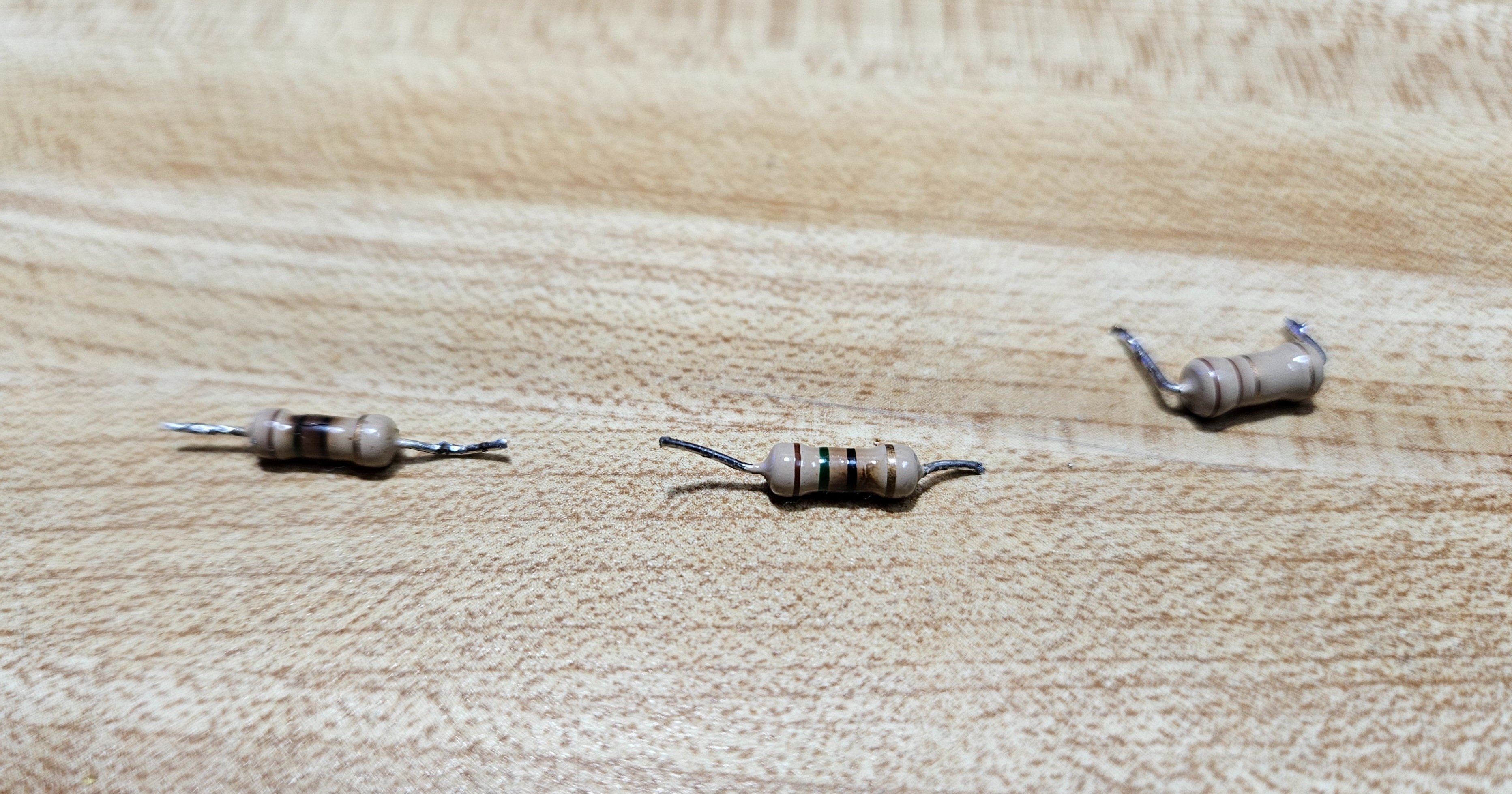

Now it gets interesting after removing the obvious failed parts. Someone has been in there but had only attempted to swap a couple parts.

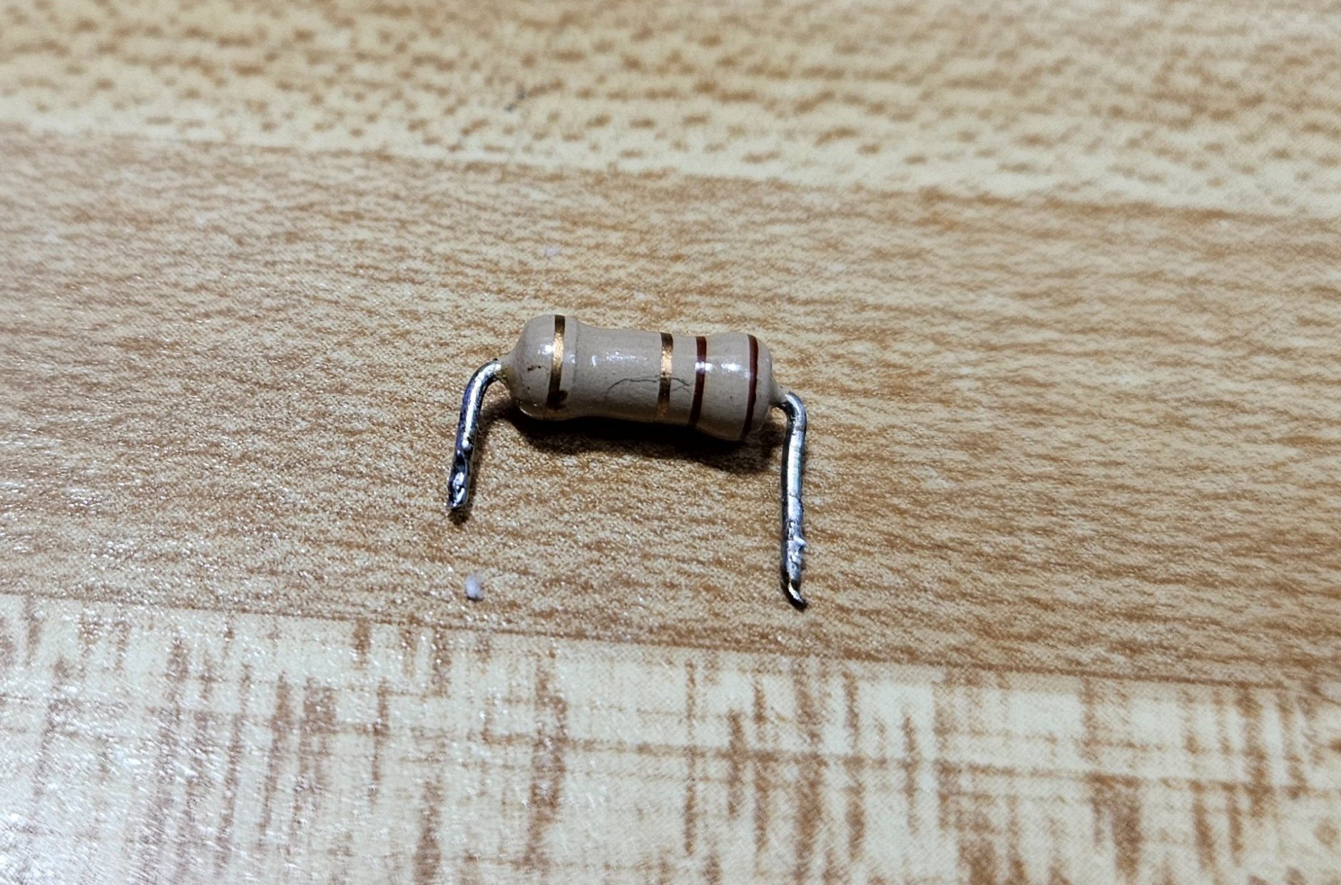

R6 and R7 are toast and not the correct value either. Instead of 10 ohm they were 15 ohm....
R8 was the most obvious as they had simply cut the leeds and attached another incorrect value in its place. Instead of being a 1.6 ohm half watt, it had been replaced with a 1.1 1/4 watt...
The rest of it including the pills was all original as the soldering told the story.
I tested all the other resistors, caps, diodes on the board to see if they are within the correct values and all else falls within spec.

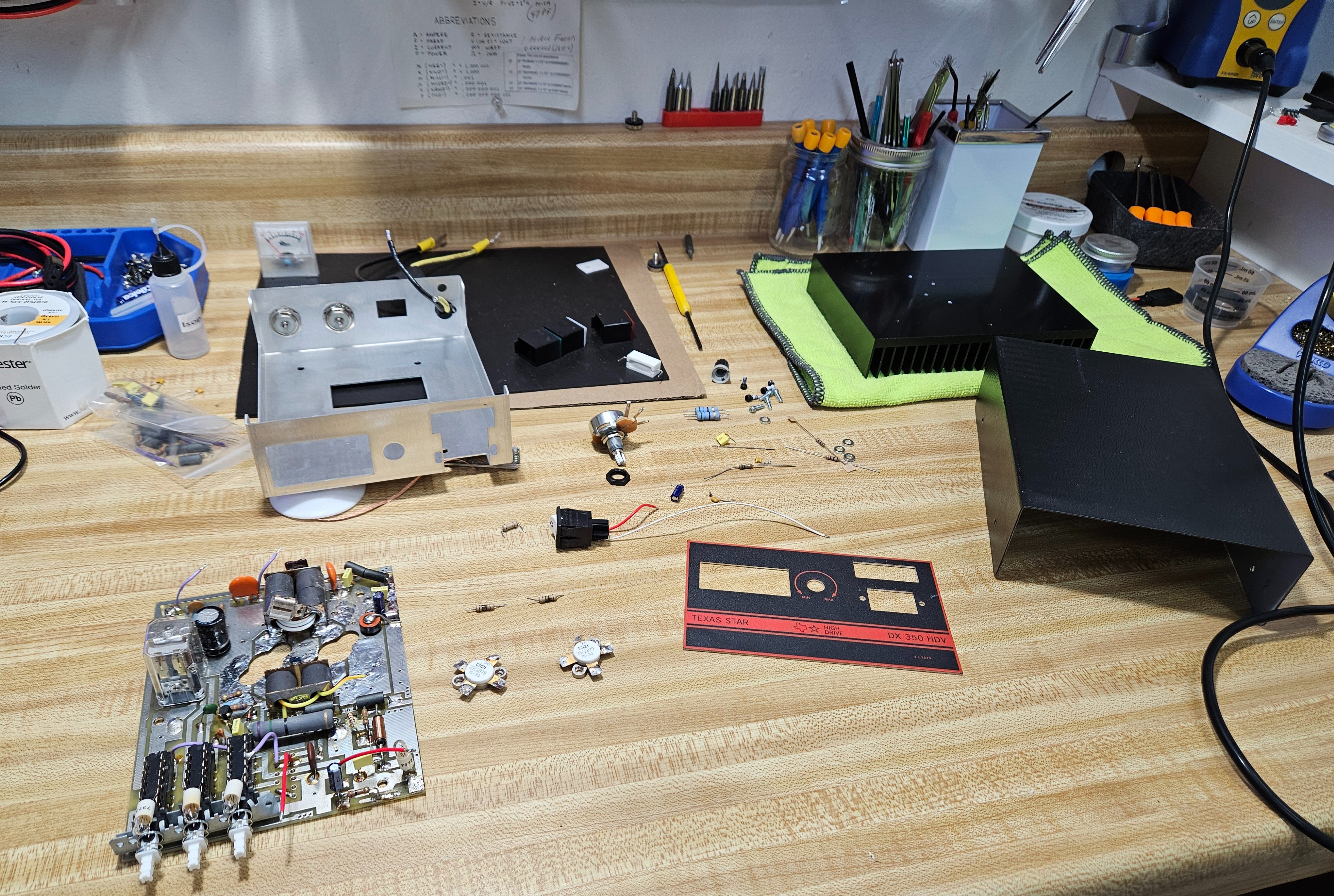

Anyway, I had everything in parts except for the one 1.6 ohm 1/2 watt for R8, go figure.... so now I'm waiting for it to hit my mailbox before I can finish or get it running again.

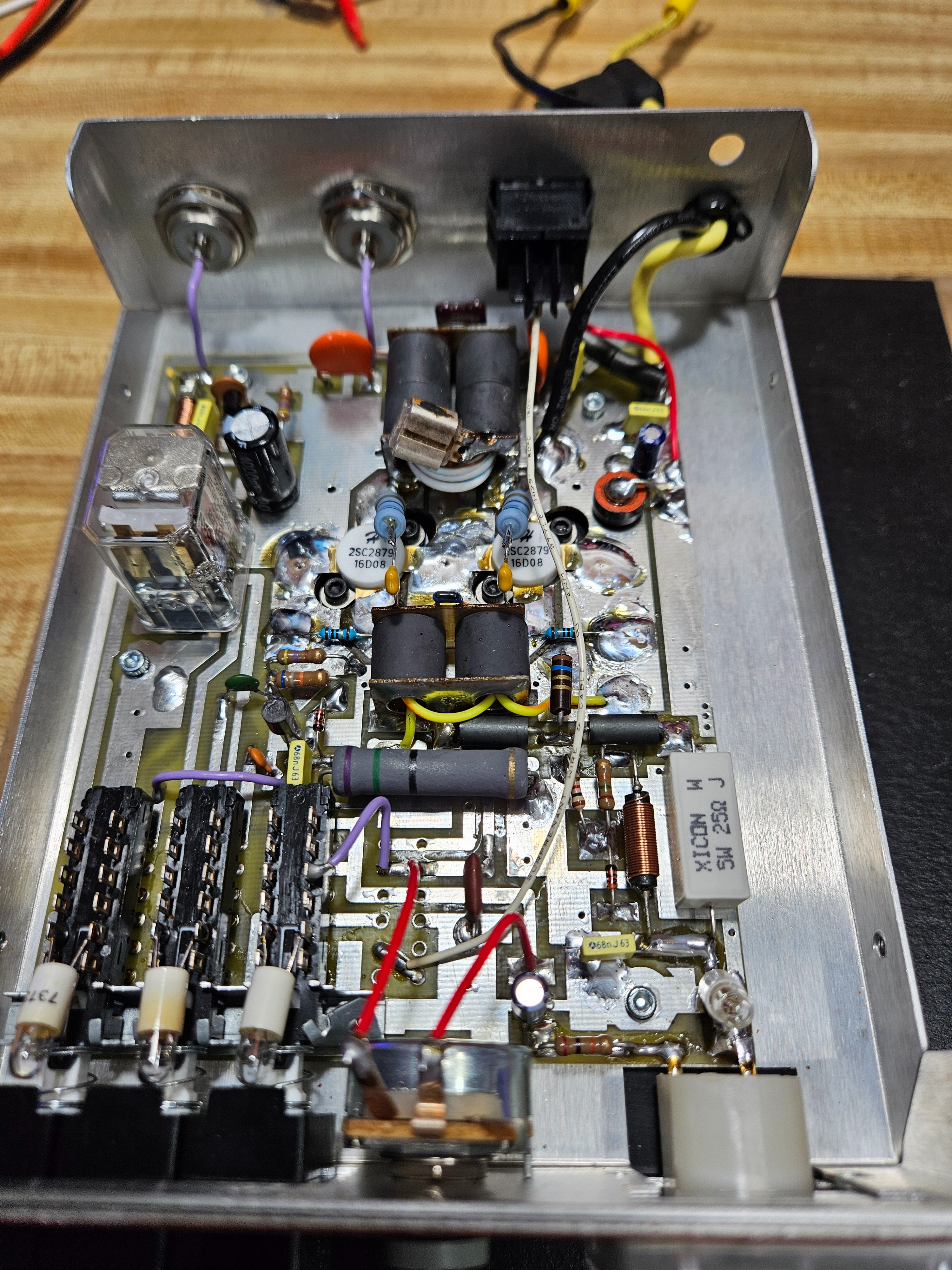

Here she be, in pieces to inspect the underside of the board and for a good cleaning because the original TS builders don't skimp with the flux!
More to come!
Ok gents, I checked tons of parts and swapped out the ones that were not within tolerance. Lots of cleaning and finally got it all put back together this evening with a fresh pair of Hg pills.
So now I'm going through to check bias and I'm stumped a little bit. According to Texas star, from the base of the transistors to ground I should have about 1.3 ohms and I'm seeing around 1.5 on my meter. The 2 10 ohms are 1% tolerance and the 1.6 is a 5%.
Now the second part is while manually keying the amp with no rf, from the base to ground I should get .61 or .62 volts but I'm seeing about .66 or .67 volts.
So I realize that my bias voltage is a tad high.
Comments, suggestions? Your help is appreciated.

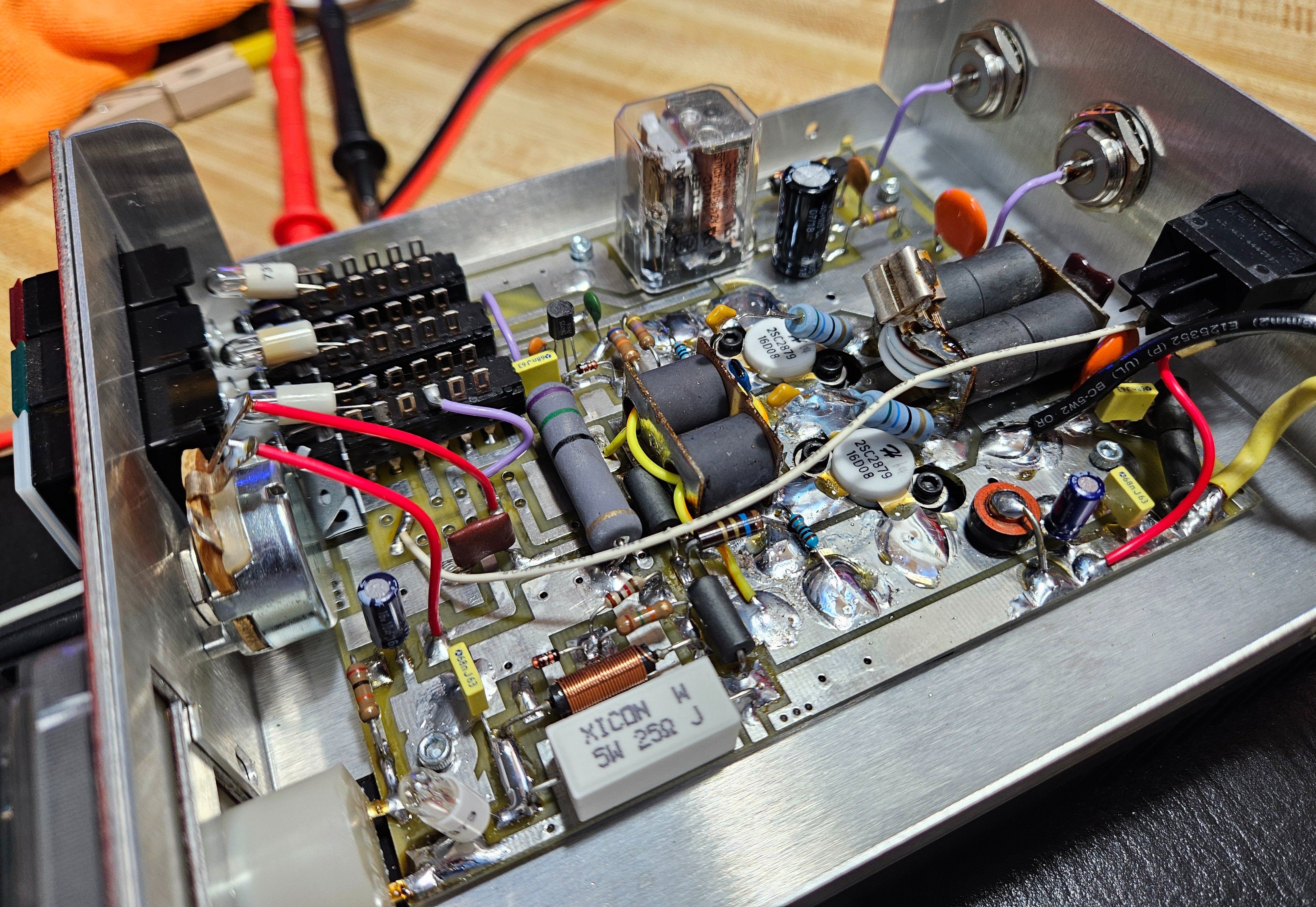

Reactions: Shadetree Mechanic
What really matters is the current the transistors draw. Each pair has a 25-ohm 5-Watt resistor as the base-bias current source. Unsolder one end of each of these resistors. Put a current meter in line with the positive power supply wire. Use a gator-clip lead grounded at one end, and touch the other end to the NON banded end of the black diode just to the rear of the relay. This will key it. Read the current and you'll see what current the relay and the lights alone are drawing. This is now your reference current, the equivalent of zero transistor current. Now hook one of the bias-source resistors back. Key it again with the gator lead and read the current drain. Subtract your reference reading and this is the zero-signal bias current for that pair of transistors. Should be under a quarter of an Amp (250 mA). Now connect the bias resistor on the other pair. Key it. This reading minus the previous one is the idle current for the second pair of RF transistors.
Texas Star chose not to provide an easy hookup to measure idle current. This is the method we use.

I would say you are okay with those measurements.......
I have seen the same variations using Toshiba's and you will see variations using the HG's.......
Key the amplifier up with a 2 watt am drive input .......
Only 1 pair of transistors in this amplifier.....
Yes sir, it's a 350 hdv so a pair 2879's.

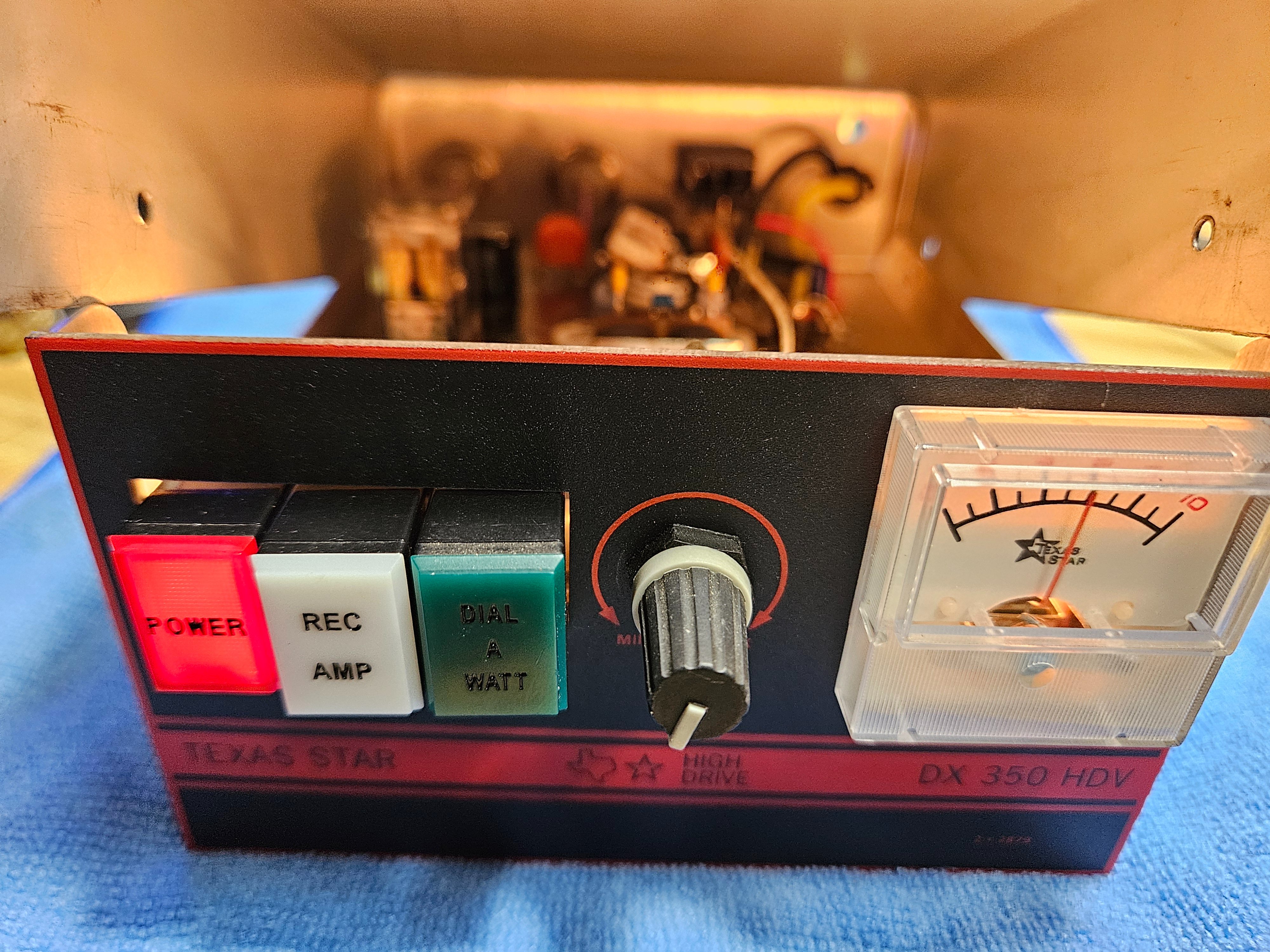

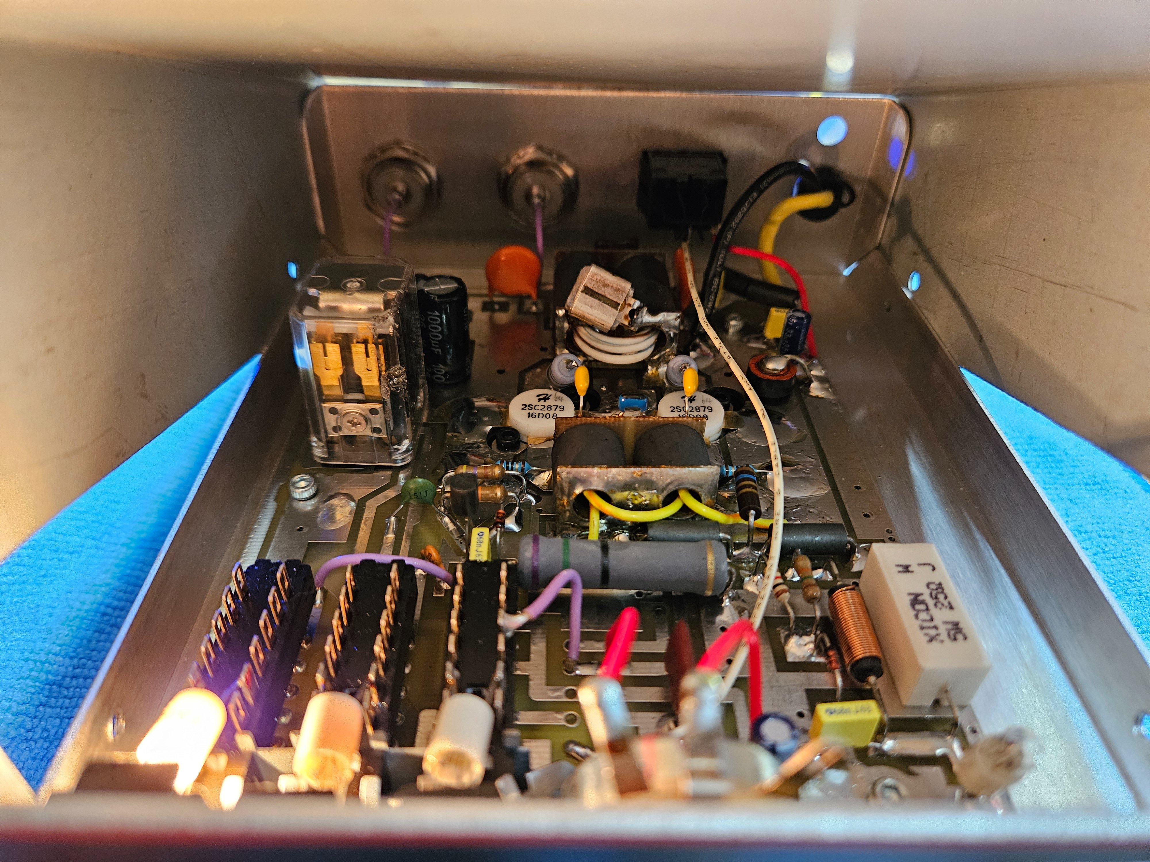

Well gentlemen, I thank you all very much for your expertise. You guys are some good people, you can't not love the world of wwdx!
I had the supply voltage set at 14.8 so I brought it down to 14.2 and all my bias readings went down even closer to what Texas star suggests.
I put rf into it this evening and it is working really well. Pass through tune is flat, input tune is pretty flat, pre-amp works (not like I'll ever use it), the dial-a-watt works like it's supposed to(won't use it either) and the ssb delay and output is on target too. Not bad for a toasted 100 dollar cosmetically mint amplifier and I thank you all for helping me out

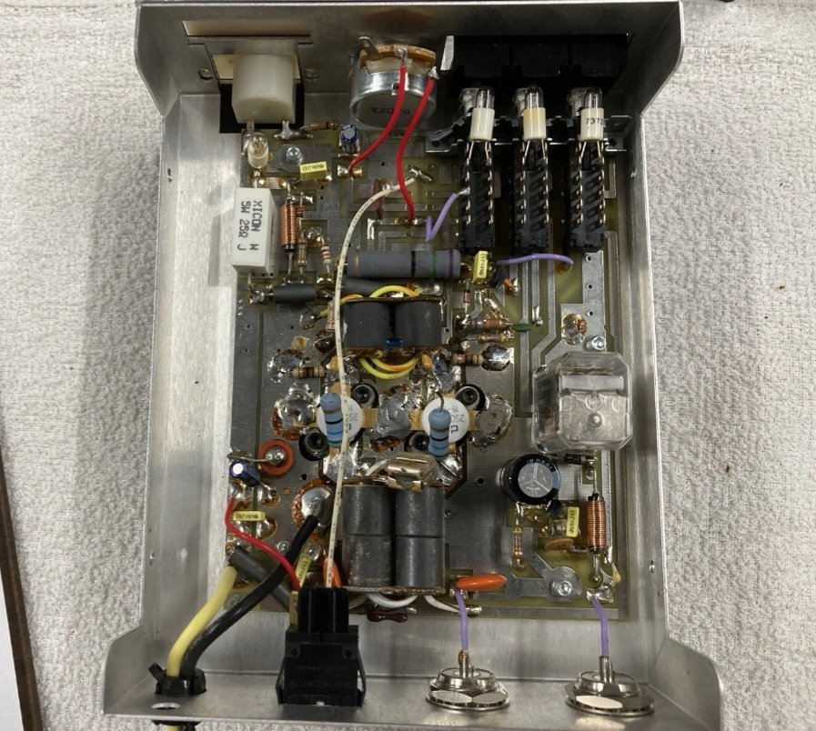

Here she be
