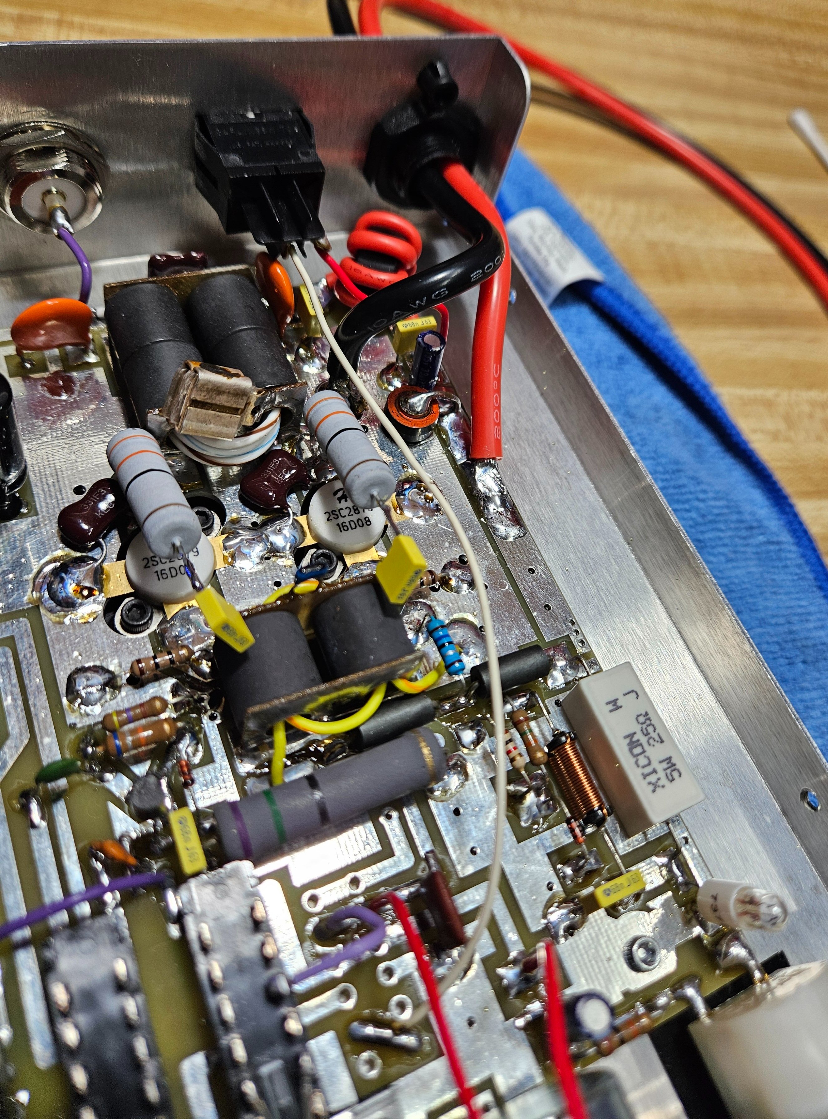

I finally had a little time to dig into the amp and I think i may have found the short. @loosecannon and @nomadradio , I think you fellas nailed it but I can't absolutely verify until I get back to it tomorrow.

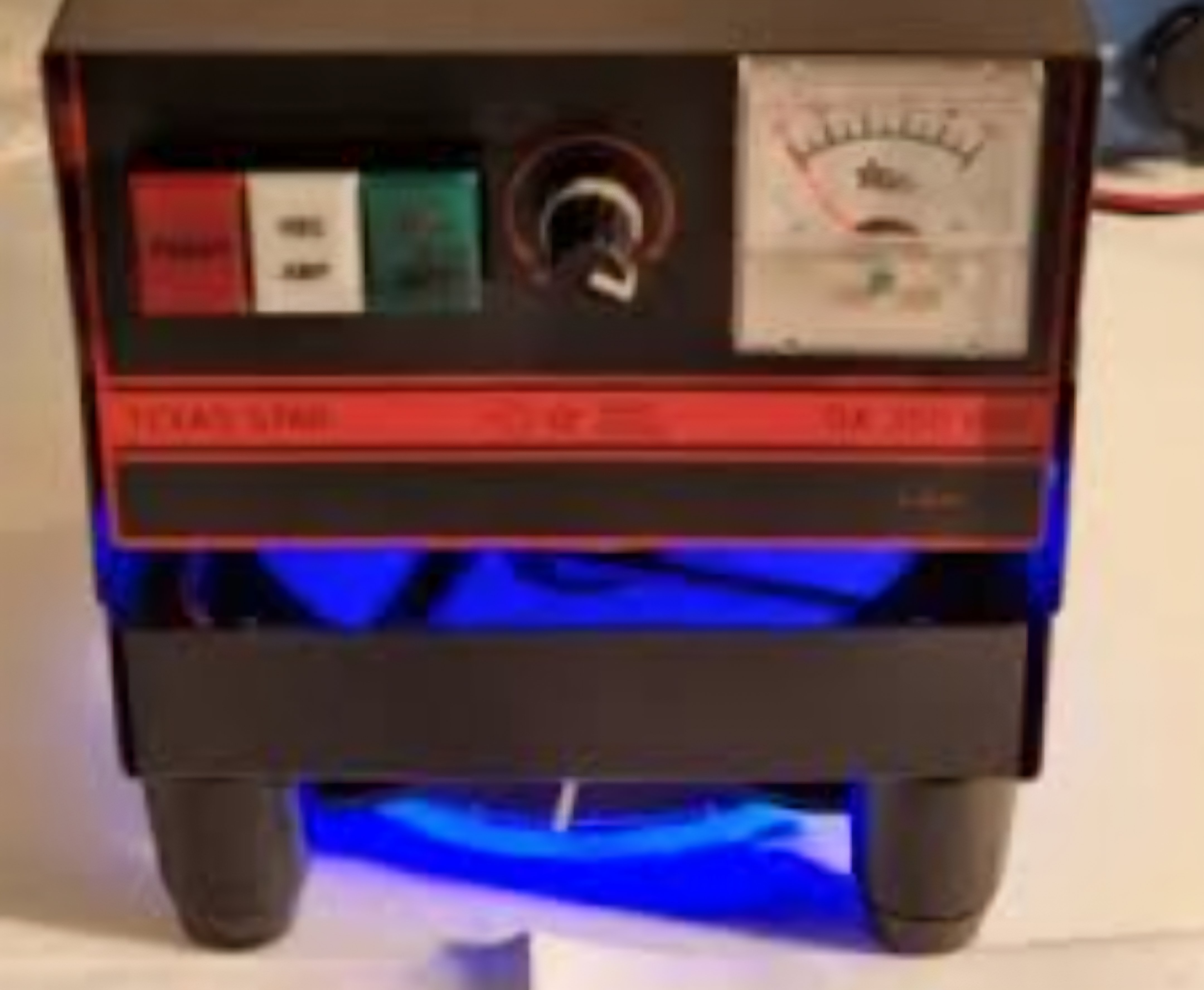

I'll add a little back story that I think factors into this equation. So when I put the amp to use the day it began having issues, I had installed a fan kit like this one
Now the Texas star is a 3 part aluminum case or housing. The faceplate and chassis bolt to the heatsink via the 4 screws and washers along with the pills and then the top cover screws to it.
These fan kits bolt right to the existing top cover holes and the amp sort of hangs there by the screws and it puts a tension on the housing causing it pull upwards or towards the pcb board.

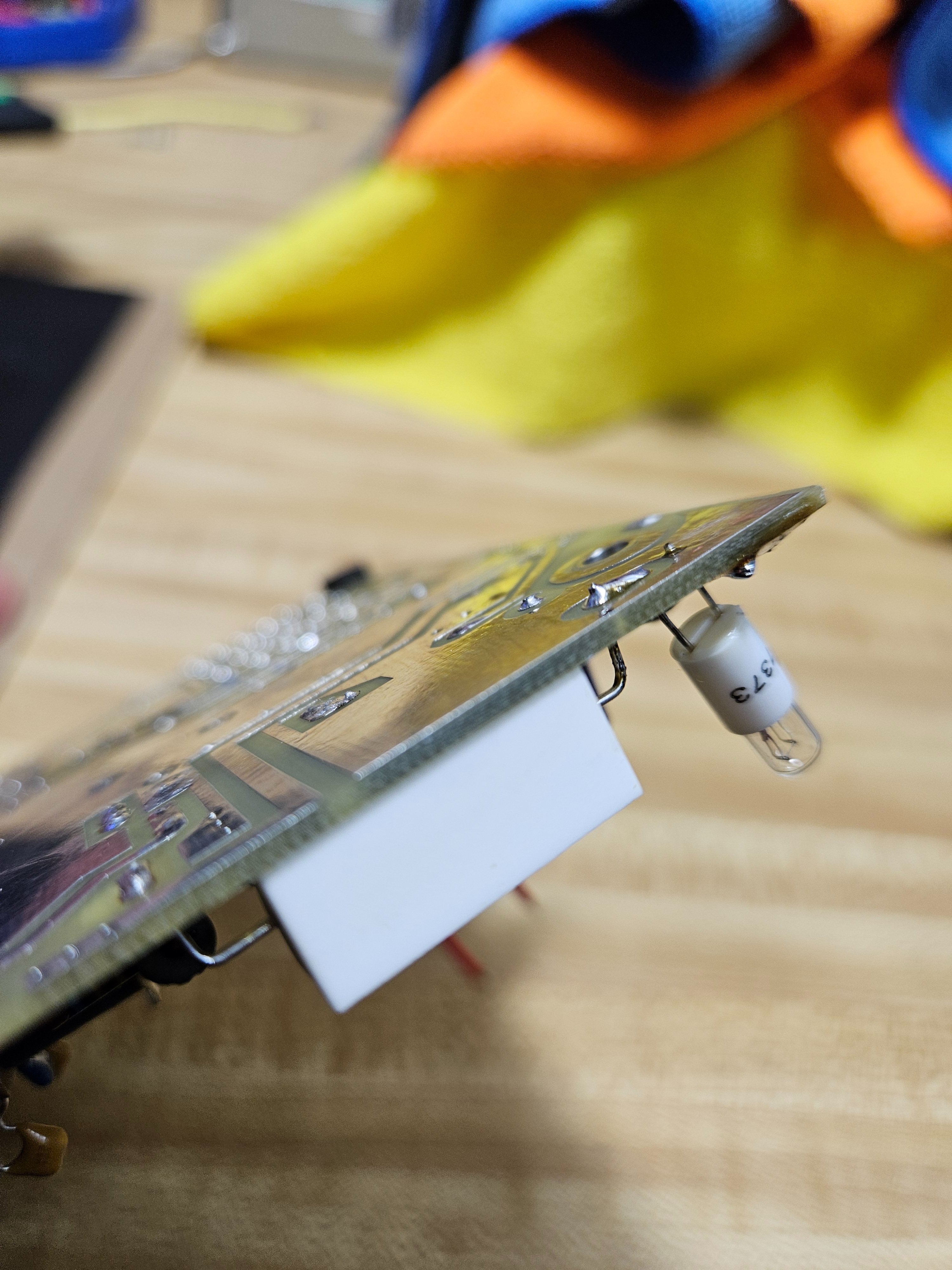

So in this situation, when I assembled it before I soldered the meter bulb after installing the meter to avoid accidentally touching the bulb housing. Well guess what, there was a tiny solder sag on the bottom side of the board. Add that with the fan kit putting tension on it and I believe after it all warmed up it made contact unexpectedly.
How I've come to this conclusion? A very minor discoloration to the aluminum cabinet right underneath where this solder blob is.
Here's what I'm talking about on the underside of the meter bulb.
Hopefully nothing else took a hit during this issue.

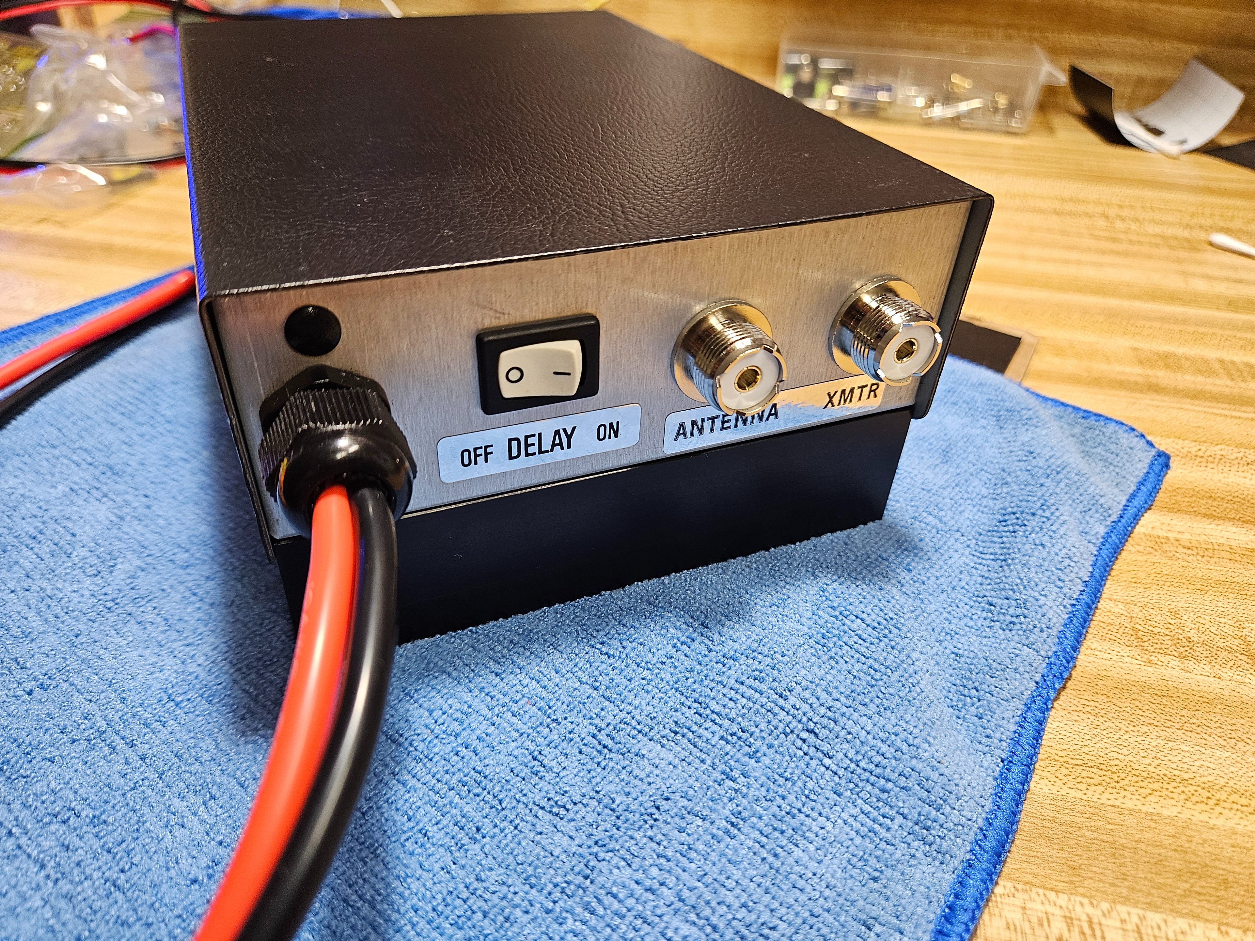

Well fellas I got everything put together. Powered up, bias impedance and voltages this time were right where they are supposed to be. I was going to call it good for the night but couldn't help myself so I put rf into it to verify that it is in fact working like it should. I'll do some power checks this evening and push it a little bit to make sure it is going to hold up.

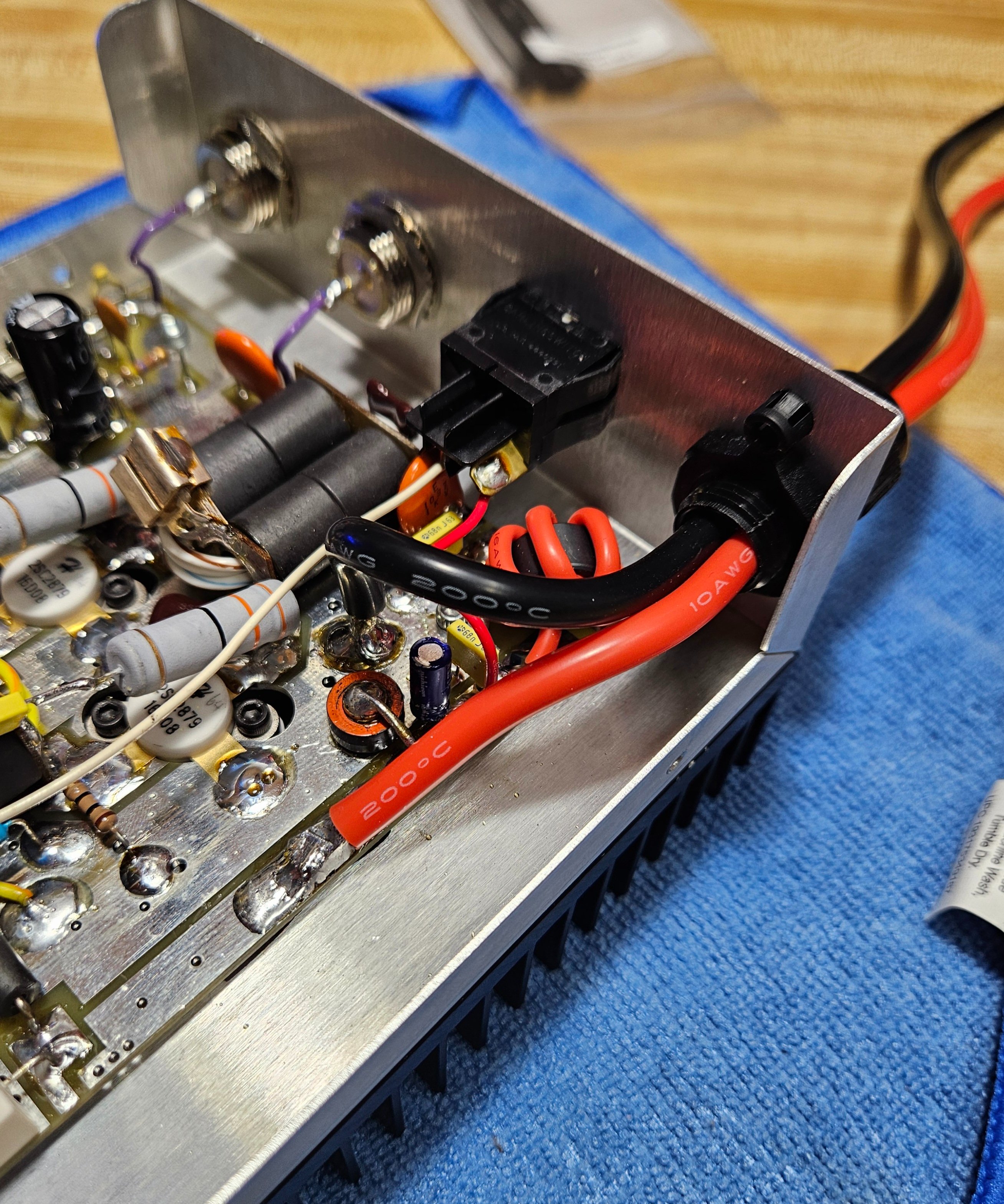

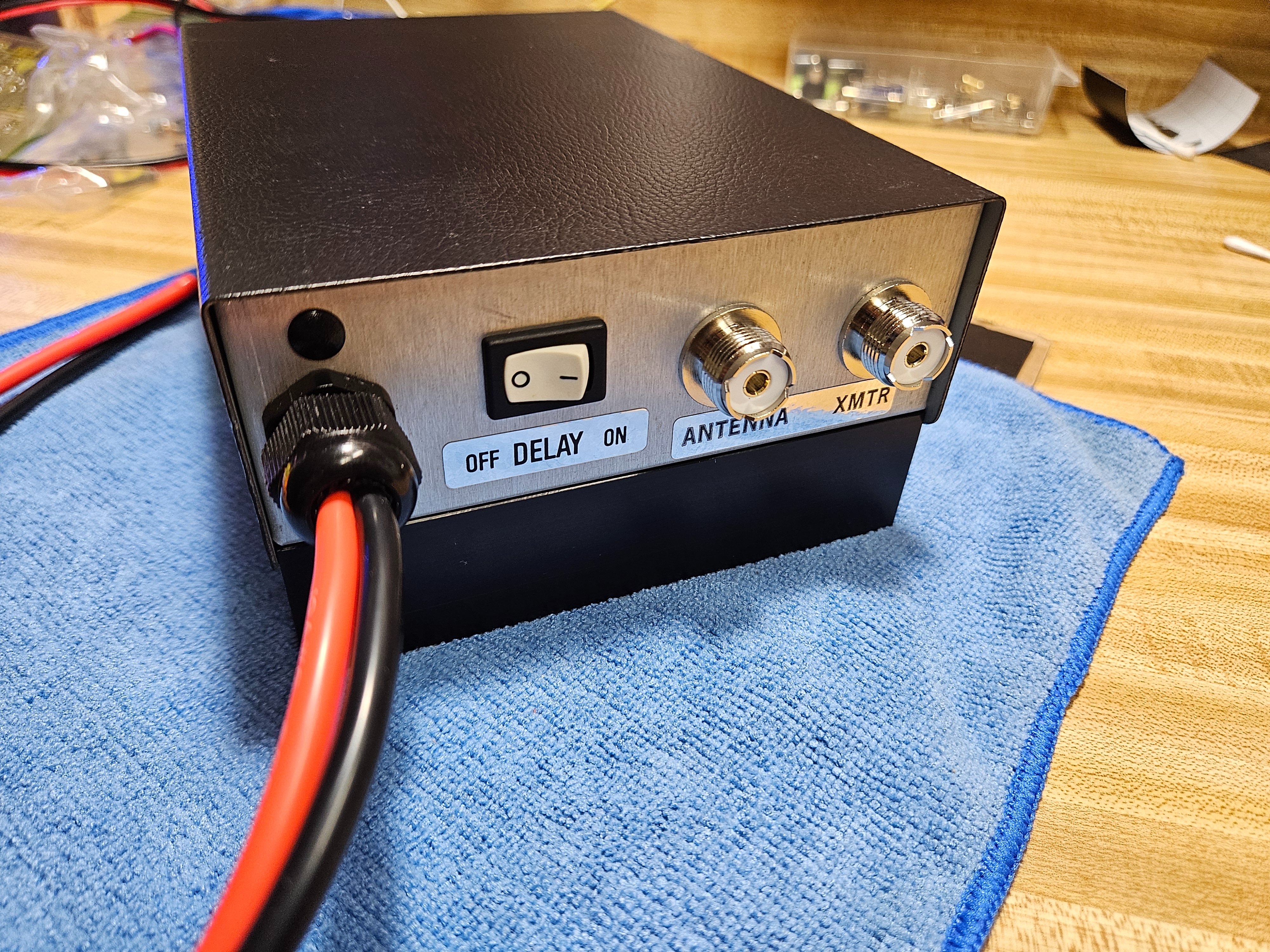

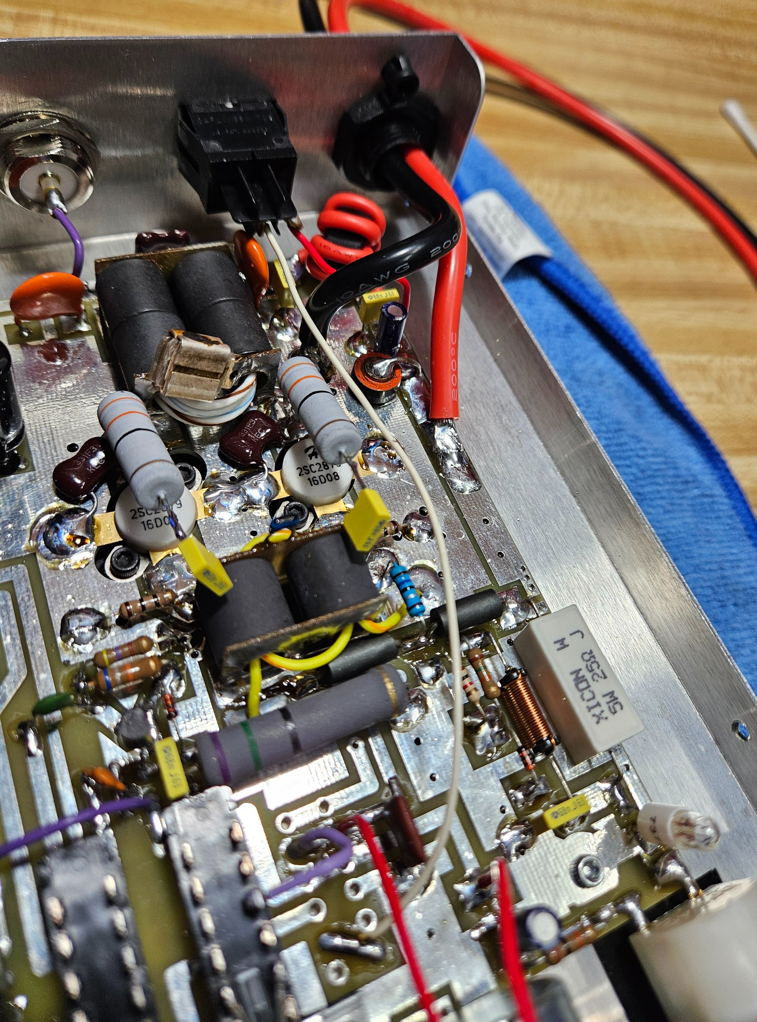

Gentlemen, I know this thread has been long and drawn out so this should put it to a close. I finished up the amplifier this evening and put it through its paces so I can say it's definitely doing the job once again. New feedback circuit, added C11,C13 new bias circuit and pills. Pass through and input tunes are great and power is where it should be with hg pills.
While I was in there I also did the power wire upgrade and replaced the so239's to make it "mo betta".
Did I install a faulty pill the first time? Who knows.... but it's working really well with the help of you fellow wwdx forum members.

View attachment 73849View attachment 73852View attachment 73851
When you say "new" feedback and bias circuit, do you mean new design? Or, replaced? It looks like the factory TS design to me from the photos.
