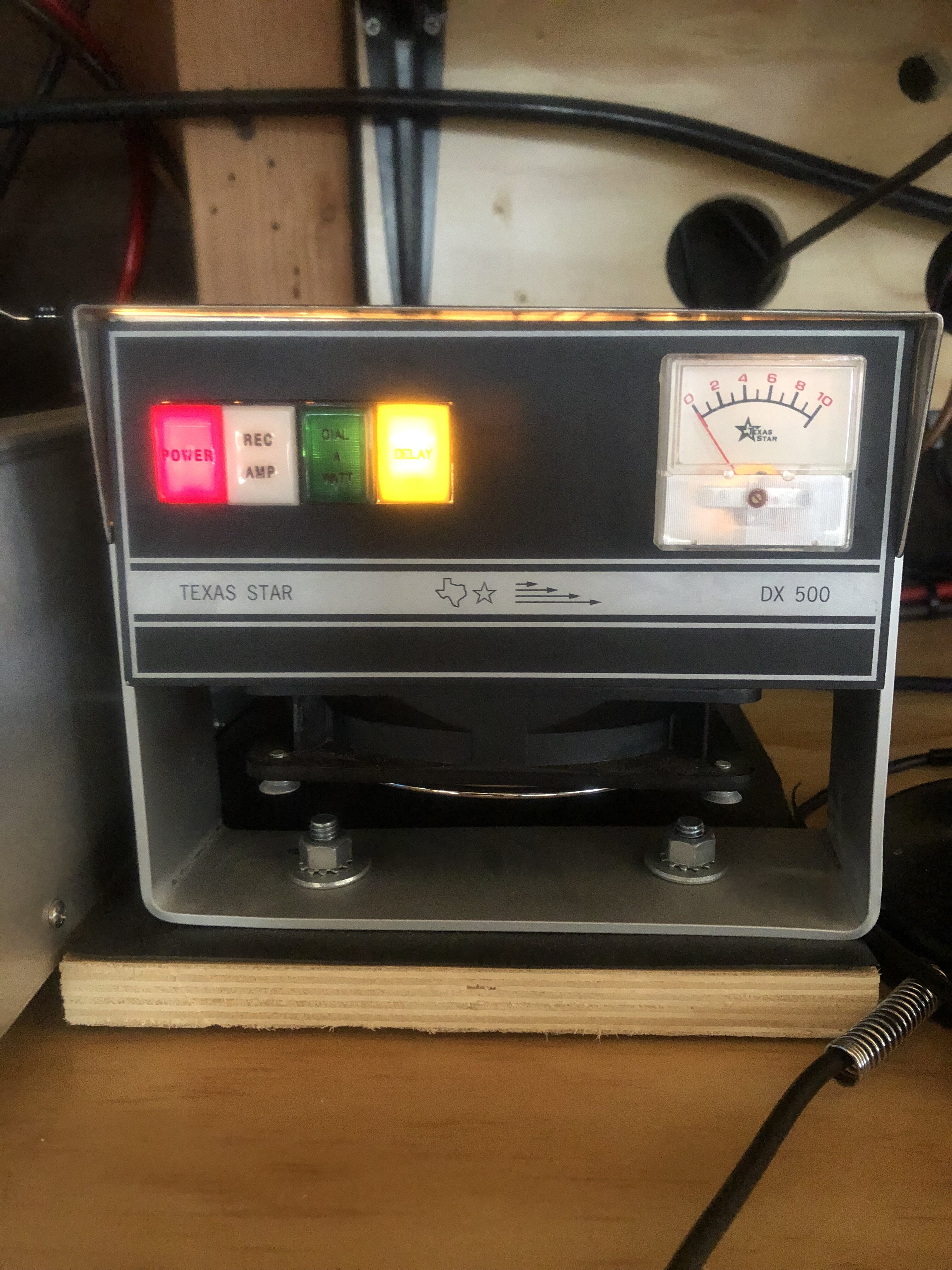

I have a Texas star DX 500
What would be the maximum watt input to drive the amp? I have heard numerous conflicting stories . The amp has been modified, removing the 10 gauge wires and fuses , and instead installing four gauge wires with an external 50 amp fuse ,
