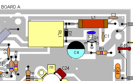

More than likely, the capacitor, RF diode or transistor in the keying circuit. I doubt it's the relay. You could measure the voltage being applied to the relay coil, by checking it across the black diode that is in parallel with that coil. If it's under 10.5 volts with the microphone keyed, and the relay has not pulled in, it is the circuit.
Reactions: skiman1
Thanks Shockwave, I'll check it out. So C4, D1 and Q1?
With keying the mic and relay not engaged, it was a little over 5v, when the relay was activated, it was a little over 2v.
Not sure it mattered, but this was with the variable turned down and the Dial-A-Watt depressed, so there would be no output when it keyed up.
The capacitor I was thinking about will look more like C1 C2 or C3. It's the one that feeds our RF into the keying transistor. Also check L1 and L2 to make sure they are not burnt looking. In this case, D1 will not be burnt out but it is the diode you could measure across to check the coil voltage.
This rules out the relay and makes the circuit suspect. I remember something about if L1 or L2 were overheated, it reduces the sensitivity of the RF keying circuit.
