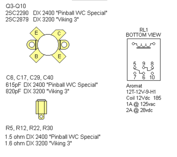

1.5 ohm for WC Pinball
1.6 ohm for Viking 3
Talking about those resistors, it's been a while since I worked on a Texas Star, the last was a DX1600 in 2004. If I remember right those are the Bias resistors, I was thinking 1.8 and 1.6 ohm, maybe I am not remembering it right. I think I have some of those around here.
