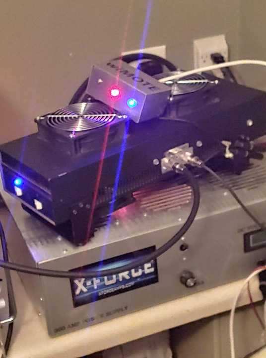

This is my neighbors Gatekeeper sweet 16 with HG 2879 transistors. I saw a 40w dk with a swing to 1800w pep on a PDC700 meter driving with his 2995dxcf base. Hes 15 miles north of me as the crow flies and hes loud, very clear but he says he bleeds a little. Ive never heard him bleed me at home but I guess folks closer to him have had problems. There was a small church across the street from him at one time and he mentioned problems there too breakah breakah hahaha.
He loves the amp but it isnt used daily.
