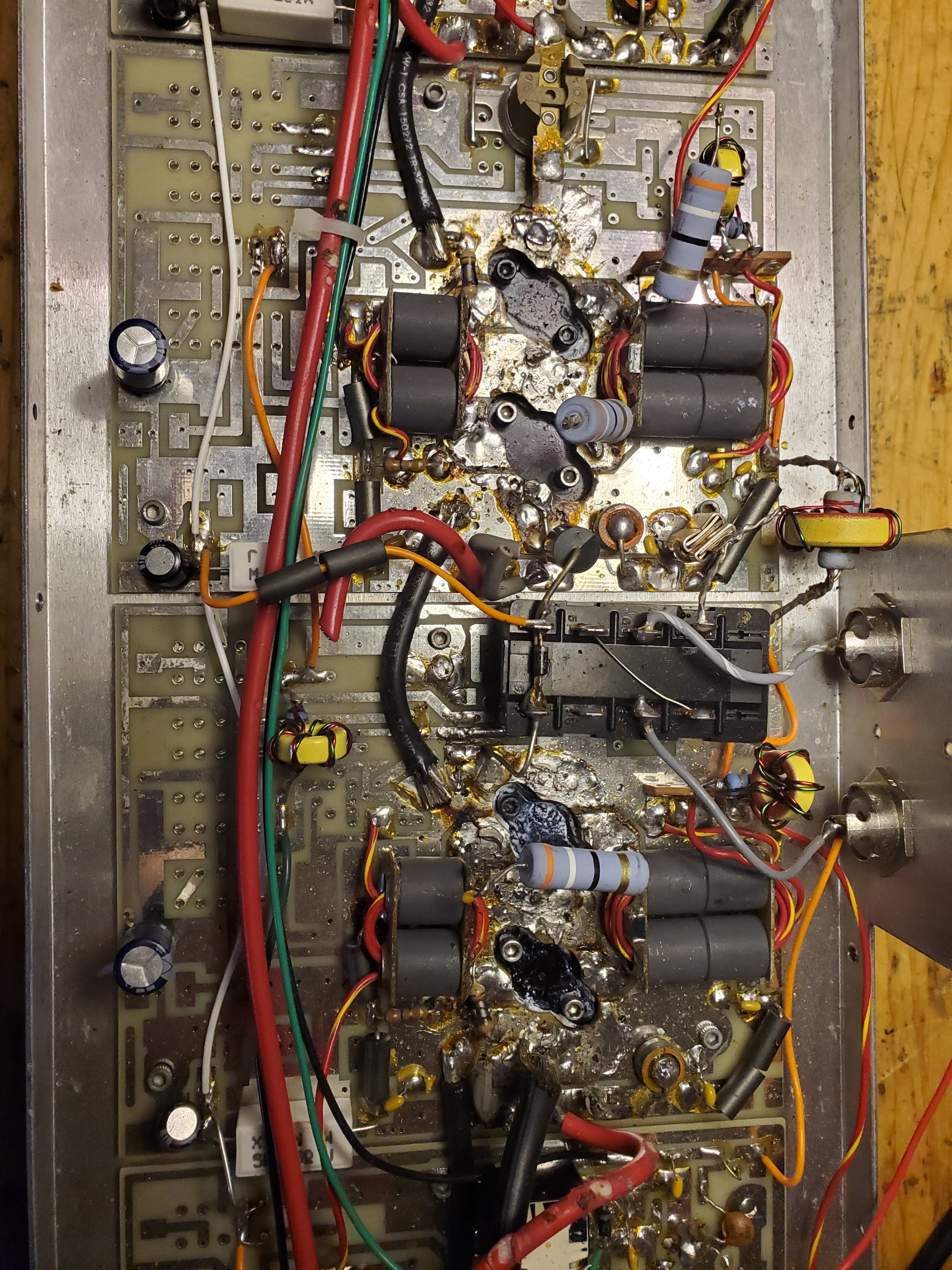

Hello all ! I was recently given this sweet sixteen that needs alot of help ! My skills and or knowledge with the pill amplifiers lacks a bit so I am going to need a little assistance here. When I recieved this the transistors were already removed so I do not know for sure what version it is or what was previously in it but by the looks of the 10 ohm resistors they blew it up pretty good ! I am assuming this one had the Toshiba 2879 in it . I went ahead and purchased a new set of matching HG for it and would like to know what should be swapped out to run the HG's and the values for the capacitors on the input and output transformers ? I am currently kinda going by the schematic on cb tricks but I think this schematic was for the Toshibas ? This amplifier has the surface mount capacitor on the output transformers, should this be replaced and with different values ? I have heard the HG's will tune differently and my tuning knowledge on these pill amps lack when not adjustable. It's going to take some work and funds but I am going to bring this one back to life one way or another and those skimpy power wires are going to have to go ! Thank you to anyone with advice and suggestions as it will be appreciated ! Thanks 20250327_192033.jpg20250327_192052.jpg20250327_192532.jpg20250327_192549.jpg20250327_193715.jpg
Well, you definitely will have a project on your hands........
It has definitely had more than one set of transistors in it, probably several sets....
Can it be restored ? All it takes is lots of time and money.....
Yeah, but it really needs to have some very experienced hands in there......
I see lots of wires cut and missing...... Lots of missing parts.......
And I see a couple of badly buggered up traces.....
All the old solder will also have to be cleaned out......
That thing has a looonnng way to go before tuning it even comes into the plan......
And NO, that amplifier was not manufactured with Toshiba transistors in it.
Several things on the boards indicate it came originally with DEI transistors......
Good luck on your endeavor.....

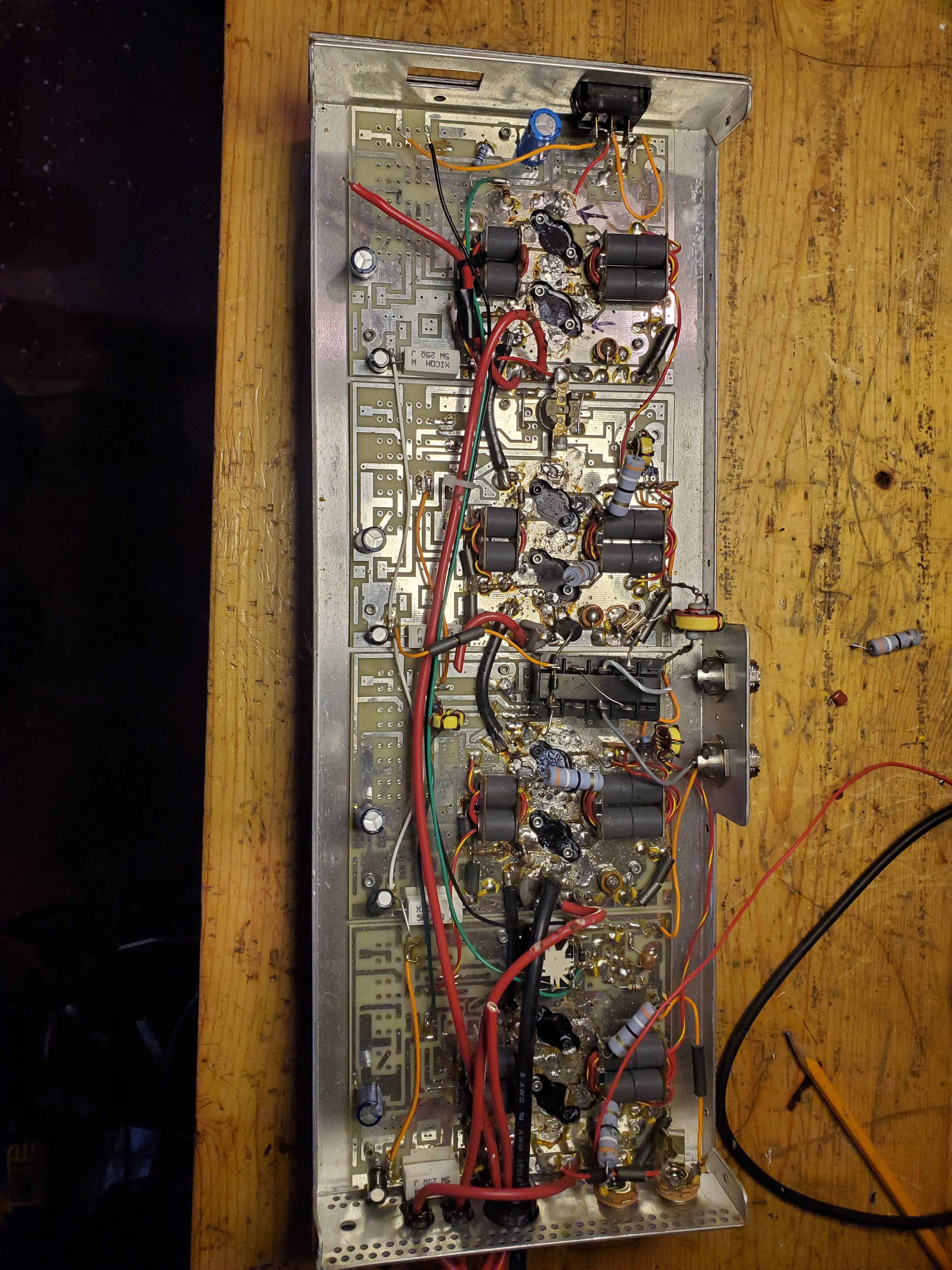

Well, I got it finished up last night and put a 2 watt key into it and the amplifier keyed and shut my power supply down in one second time, to my misfortune it blew both transistors on board #4 so now I am not sure about finding the issue but obviously there is a short somewhere while it is keyed up. Not sure where to go on it from here but sure don't want to damage any more pills

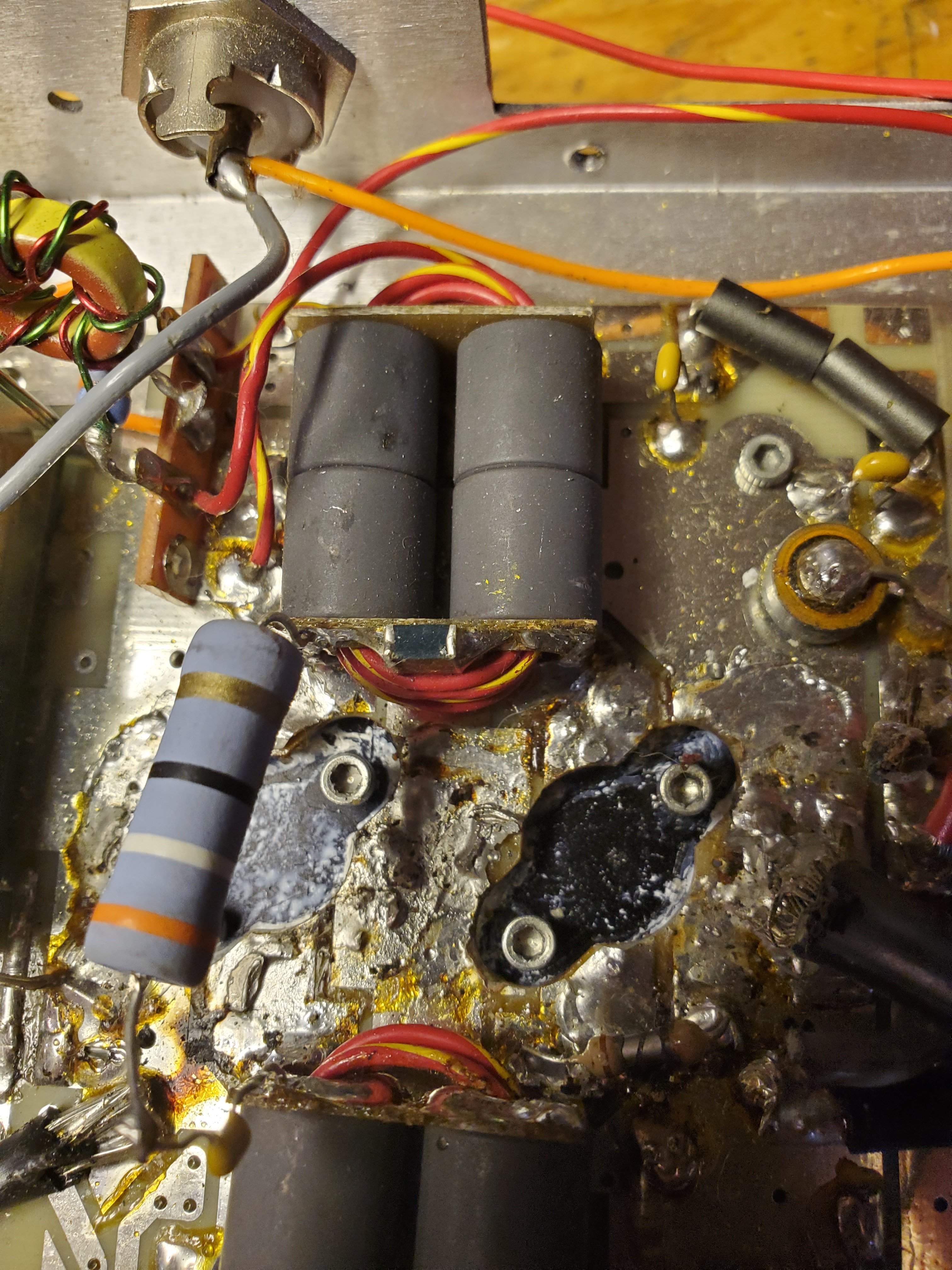

As much solder that I see on the board in your initial photo around the transistors, there is a possibility that some solder has "leaked" through the small weep holes and dripped straight to ground........
When I am rebuilding/refurbishing an amplifier, especially any Texas Star amplifier, I always pull all the boards out so I can inspect, and/or repair the under side......
I have found many issues that way.......
I also would suspect a shorted resistor or shorted capacitor, or both.......
