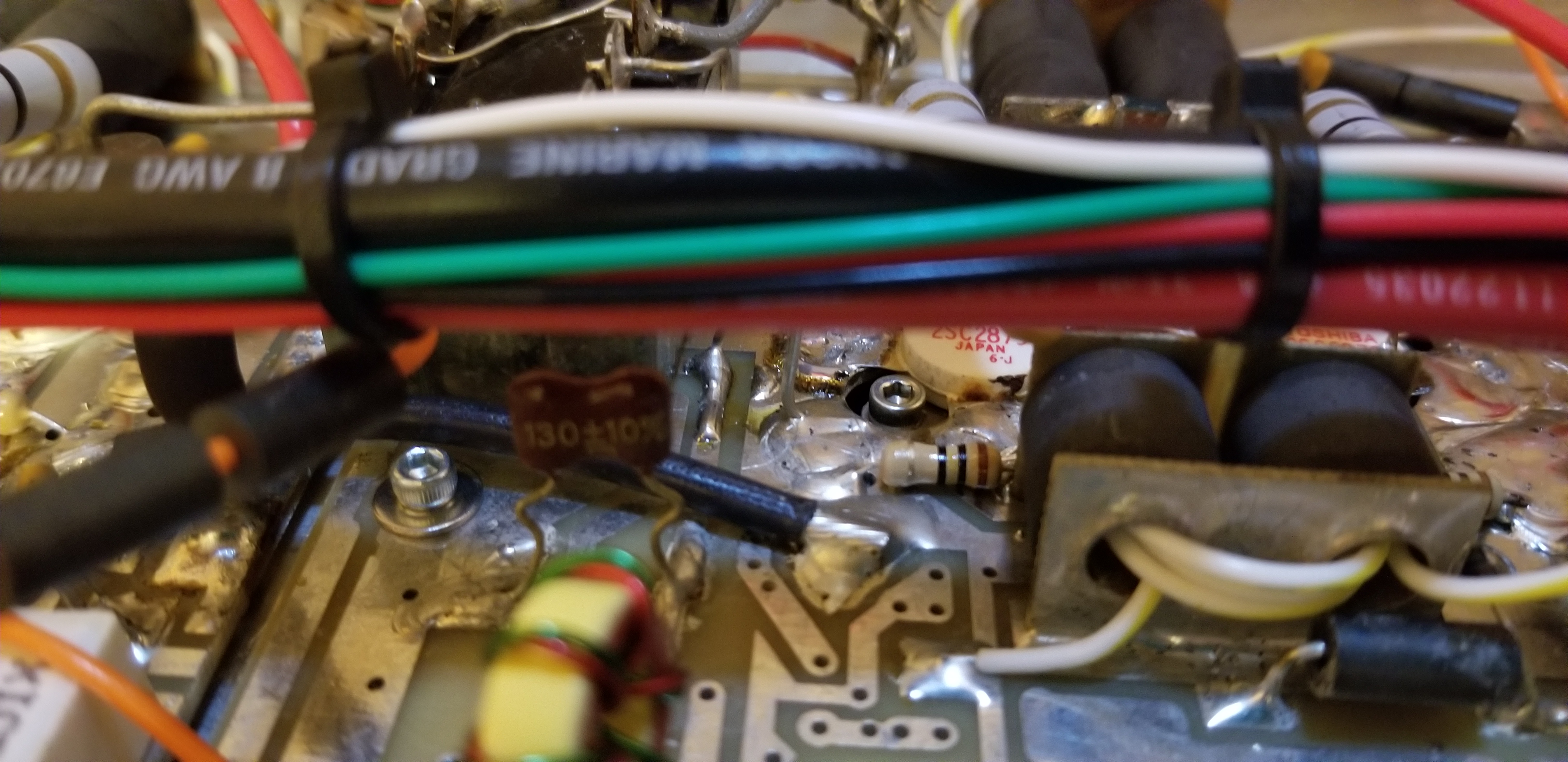

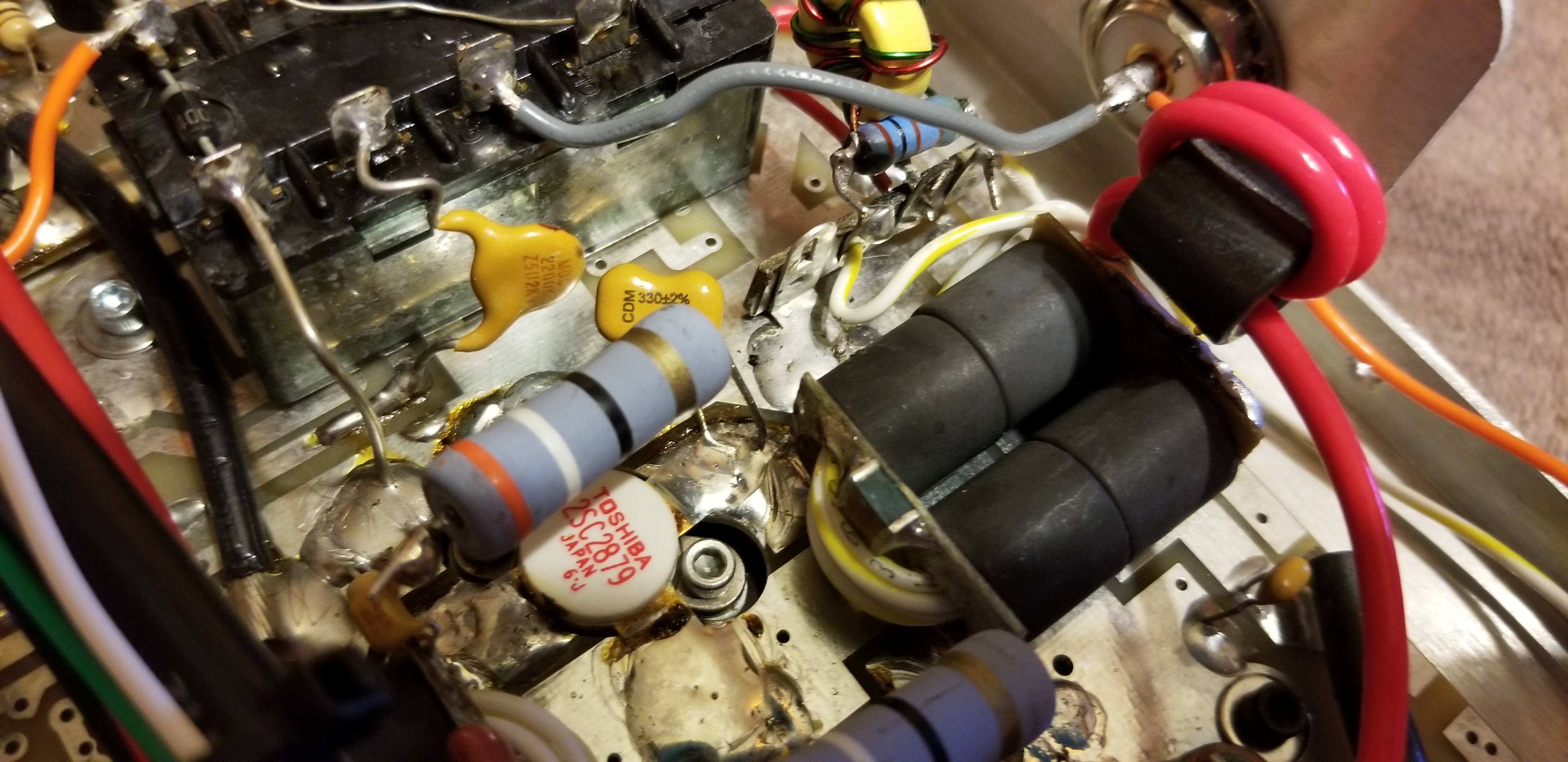

Above is the input "bandpass" filter capacitor that is missing in your amplifier.....
This is the input tuning capacitor above, tuned for lowest VSWR on the input from radio into amplifier......

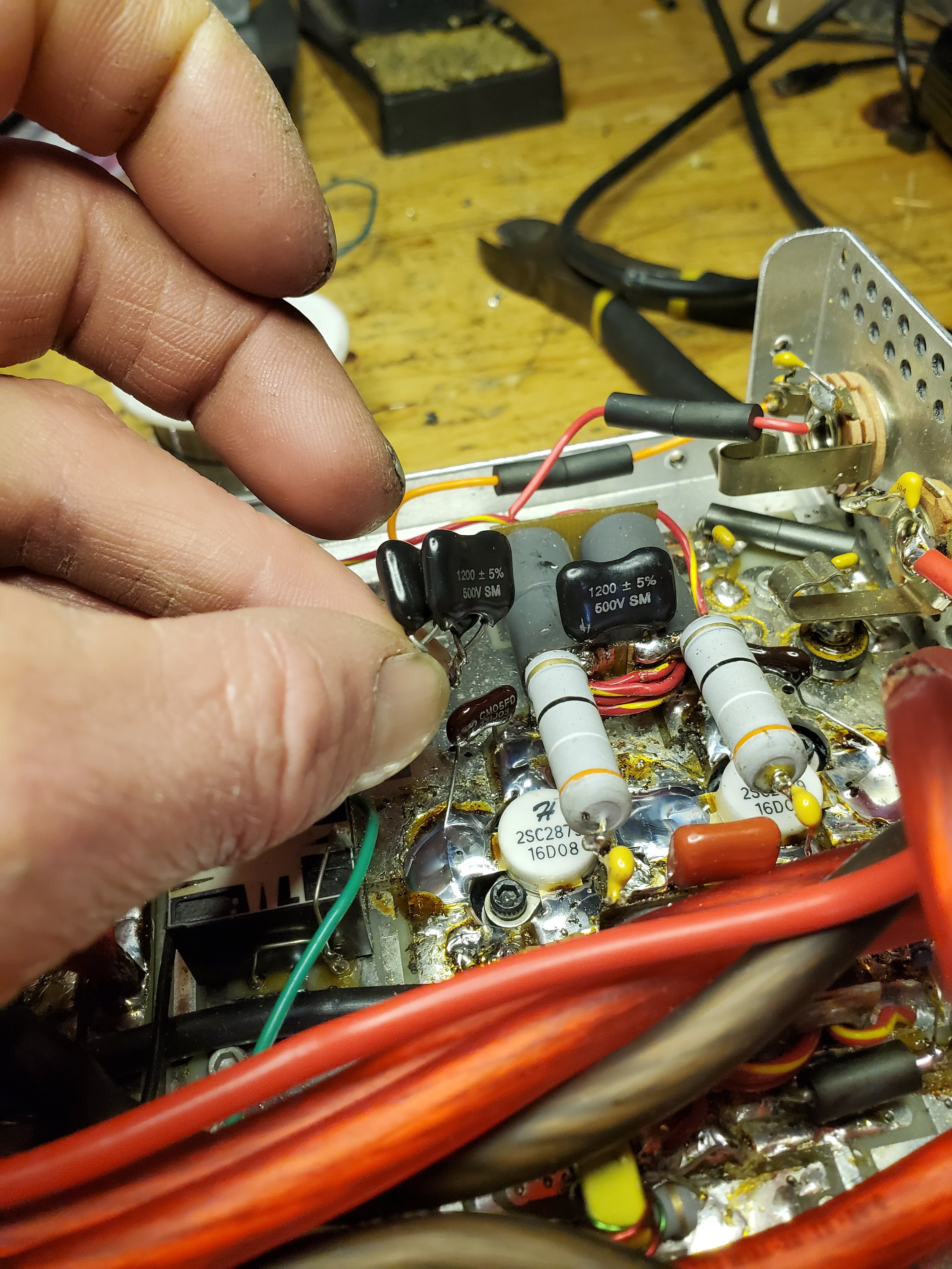

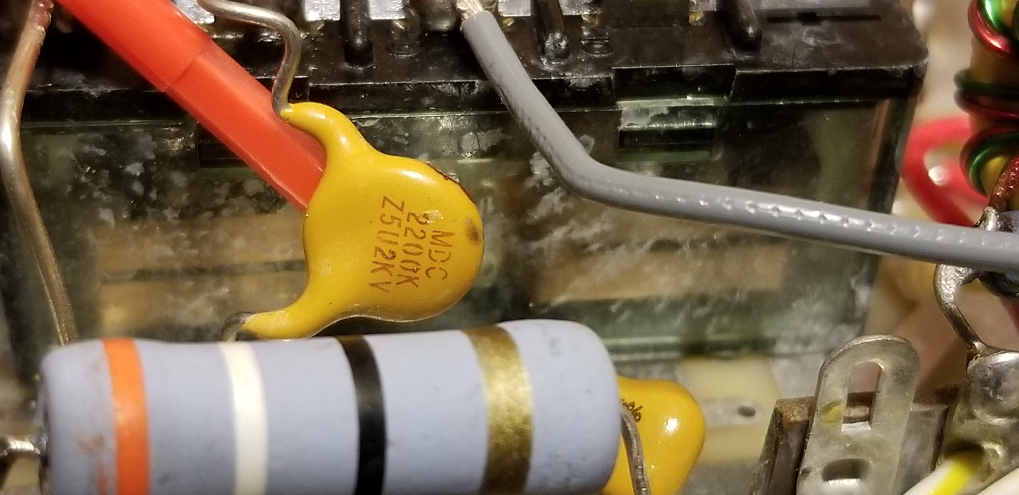

Well, Ranch55 stupid me ! I found out what I had wrong I wasn't really thinking and I have seen them this way before and I saw the term "stacked" in the parts list just like they had with the 2 resistors on the output combiner and I had these stacked which doubled the value 17447721557856223734461975629236.jpg amp seems all good now will check for tuning
Well, Ranch55 stupid me ! I found out what I had wrong I wasn't really thinking and I have seen them this way before and I saw the term "stacked" in the parts list just like they had with the 2 resistors on the output combiner and I had these stacked which doubled the value View attachment 72570 amp seems all good now will check for tuning
I was gonna say that 2400pf was quite a lot of capacitance on the output transformers.
