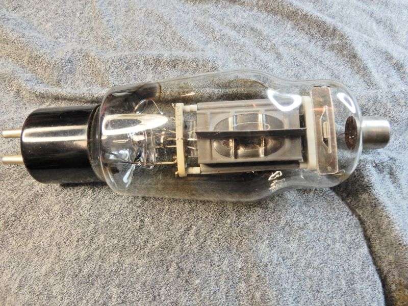

The 811A tube in its native condition. Blown to Hades.

I was gonna list this 811A tube on fleabay, mostly for grins, not so much for profit. Yet another listing that starts with "It's dead, Jim".
Just a bit better than cluttering the local landfill. Until it rolled off the bench and onto the floor with a resounding "POP!", tinkle.
One bright spot, it makes the carnage a lot more visible with that pesky reflective glass out of the way.
I have come to see this as the natural state of the 811A tube. It's rare to find a user who treats it gently enough to survive service in a ham linear.

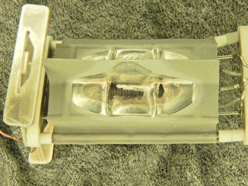

The oppposite side of the anode isn't quite as clobbered, but still has a hole in it.
But if you hold the light just right you can see the grid wires through the blow hole.
Probably not suitable for fleabay now. But definitely easier to photograph.
They have not made an accurate equivalent of the original RCA 811A tube, in over 30 years. The 811A tube became completely worthless as soon as the six radiator fins were removed from the anode and replaced with a flat fold on each side. That is not the way the original tube was constructed and that is why the new tube fails regularly. Avoid 811A tubes in any application that has a carrier and replace them with 572B tubes.

I put 572's in mine and never replaced another tube after that.
Jeff
811A have the thinnest plates of any transmit tube. I would use one above 150 watts output SSB and 100 watts peak AM.
