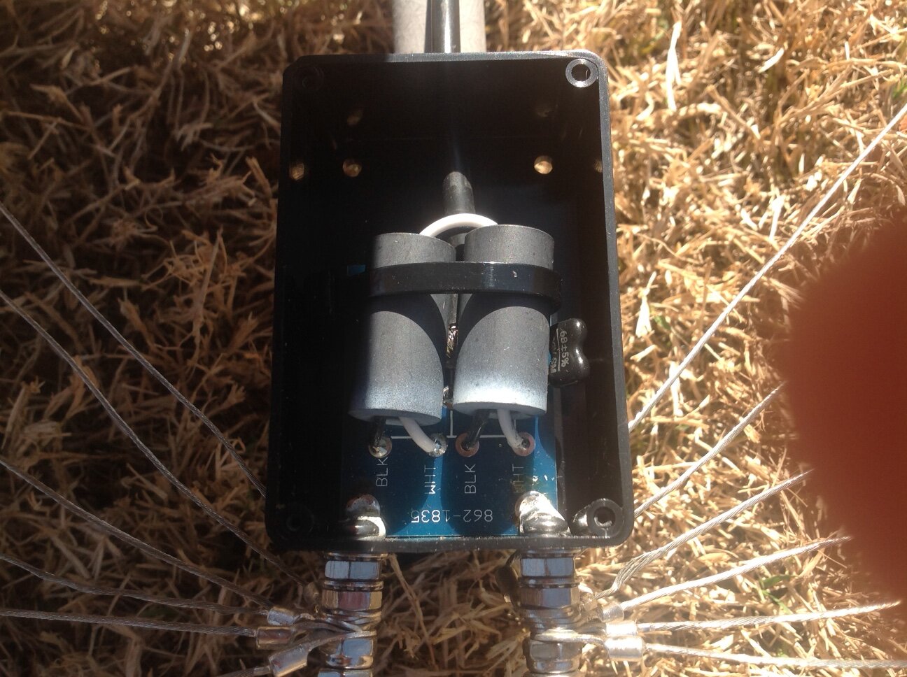

Did you open up the transformer to see if things looked ok?
Appears to be.

The transformer/balun most likely has traces on bottom of board to make connections
