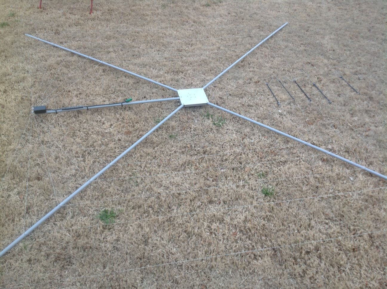

Got the cobweb 80% done. Just have to add wire for the 6 meter portion and go through the tuning process.
Everyone says these are a snap to assemble but it took me the better part of an afternoon and still not done. That said, it looks good and is actually smaller than what I had pictured in my mind. Am excited to get it put up.

Installed all wiring.
Began tuning on 20 meters. Yes, kept equal lengths on both sides.
