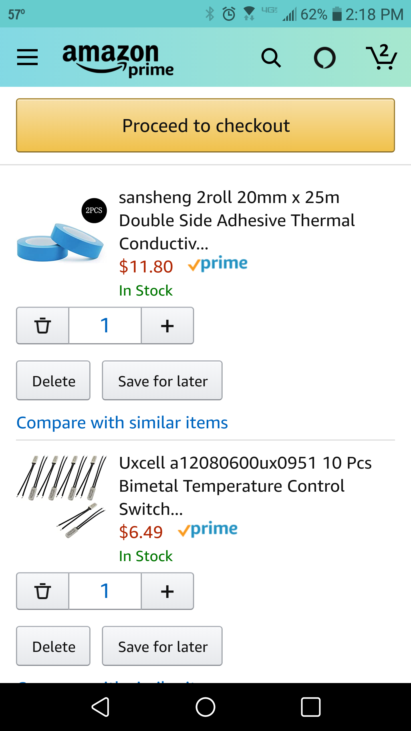

I have an amp I put an old brushless computer ps fan on, but want to make it thermally switched. I found some thermal switches online, was thinking to use thermal conductor tape to attach it.
Would you put that right on a pill, or on the external heat sink?
Is 45*C sufficient?
Let me know which one you use I was looking at some of these the other day.
I was thinking these switches and this tape.
