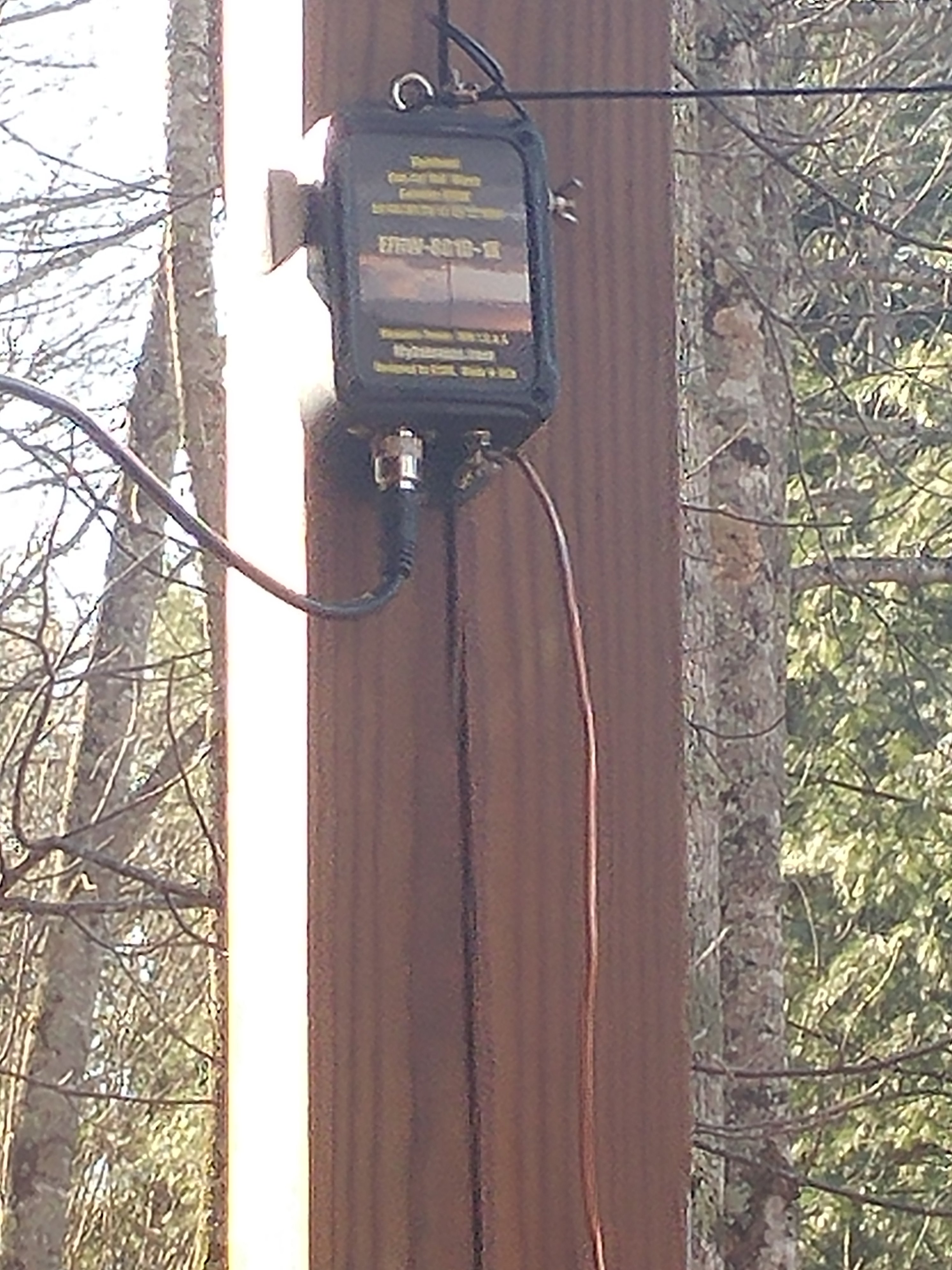

I got the My antennas EFHW 1080 up in the air yesterday. I hung it in a Inverted V. Feedpoint is 9 ft off the ground going to a tree branch at 30 ft then to a post in my field at 9 ft above ground. Both sides are about the same at 70 ft long.
It works as advertised. 80 meters I can only tune from 3.800 to 3.891 with my Icon 7300. I was able to make good contacts on 80,and 40. Not much happening on 20.
SWR is flat on 10,12.15,17,20, and 40m. It would be nice to get more out of 80m, but I'm real happy with it.
Happy, Happy, Happy. After 6 years I'm finally on HF, and I can now say I have a real Station.

I got the My antennas EFHW 1080 up in the air yesterday. I hung it in a Inverted V. Feedpoint is 9 ft off the ground going to a tree branch at 30 ft then to a post in my field at 9 ft above ground. Both sides are about the same at 70 ft long... edit...

139 ft long. End Fed. Coax from your radio goes into the magic box using standard PL-259. From the box comes a wire 139 feet long with a insulator on the end of the termation point.
Basically a long wire attached to a box.
Clear as mud yet? I'll take a picture today and post it. I'm still,cleaning up from the 4 hour ordeal in freezing weather. Jeez, I thought this would be easy. NOT!

Just an update on my efhw 1080, this thing rocks. I've made many contacts on the band's that are active like 75, 40, and 20. I get 59's all day long. Yes I also get some 57's and 8's but I expect that. I've been in long QSO'S and it hangs in there with no problems. In fact if I can here you I will probably be able to work you.
I hung my antenna thinking I was going with an inverted V, but as it turns out 1/2 of the 139' is almost horizontal (6° up), and the other 70' is at approximately 45° down slope. I looked at this setup yesterday and my OCD almost made me take it down and re position it to either a true inverted V or flat top. Then I reeled my thoughts in, and said why would I do that if it ain't broke. I left it alone, and continued to make long distant contacts throughout the U.S. this antenna just plane works. I'm not touching it. I would buy another one in a heartbeat. There is some stray RF, but it only happened when I was learning the ropes on how to use a internal tuner. I keyed up a few times on the very edge of the upper 75m band where my SWR was above 3.0, and that's when it lit up a lightbulb in our China cabinet. Since I now understand how the tuner works, the problem,so far has not happened again. I also thought my SWR meter on the radio went out yesterday, because I was on 20m USB and the SWR was so flat it wouldn't even register. Checked it with an external meter, and it wouldn't even move. I've never seen a flatter signal on any radio or antenna system I've ever owned. In fact it's the same reading on most of 75 m, all of 40, and 20m. To say that I am totally pleased is a Big understatement.
