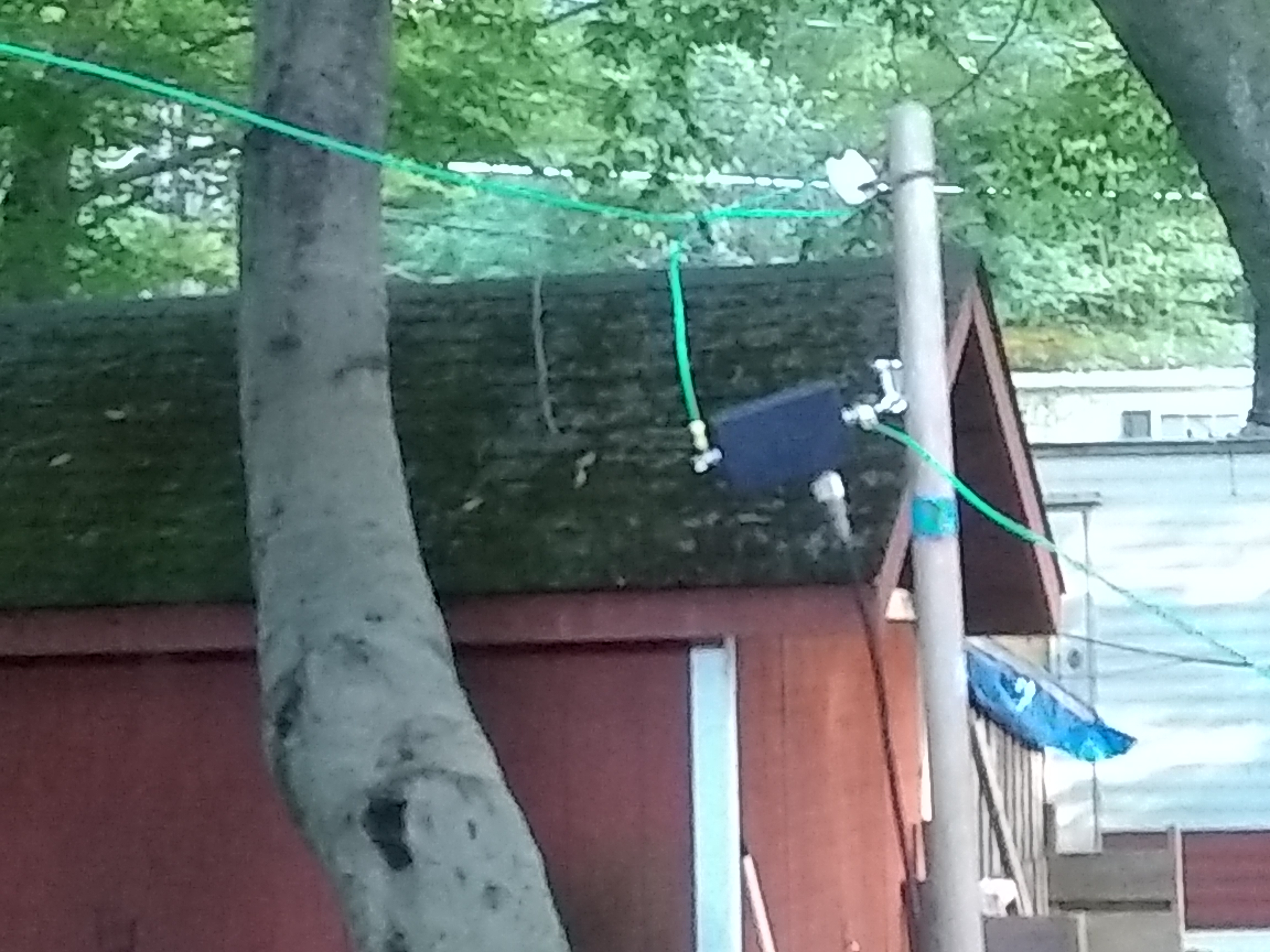

Un-Un was $36 on eb. Wire goes up from this 10' feedpoint up to about 27' about 25' away to the left up a tree, then makes a left for another 9-10'. to the right is about 16' of counterpoise wire..
I have talked up and down E coast and out to IL on regular basis from 20-80m bands. Furthest contact so far was West Coast on a 40m 'net'. W7AJP in Oregon..
On occasion I can hear the HI beacon in the early morning hours and have heard Japan or China stations.
I like my end fed.. easy to hide up here in HOA type mobile home park..
