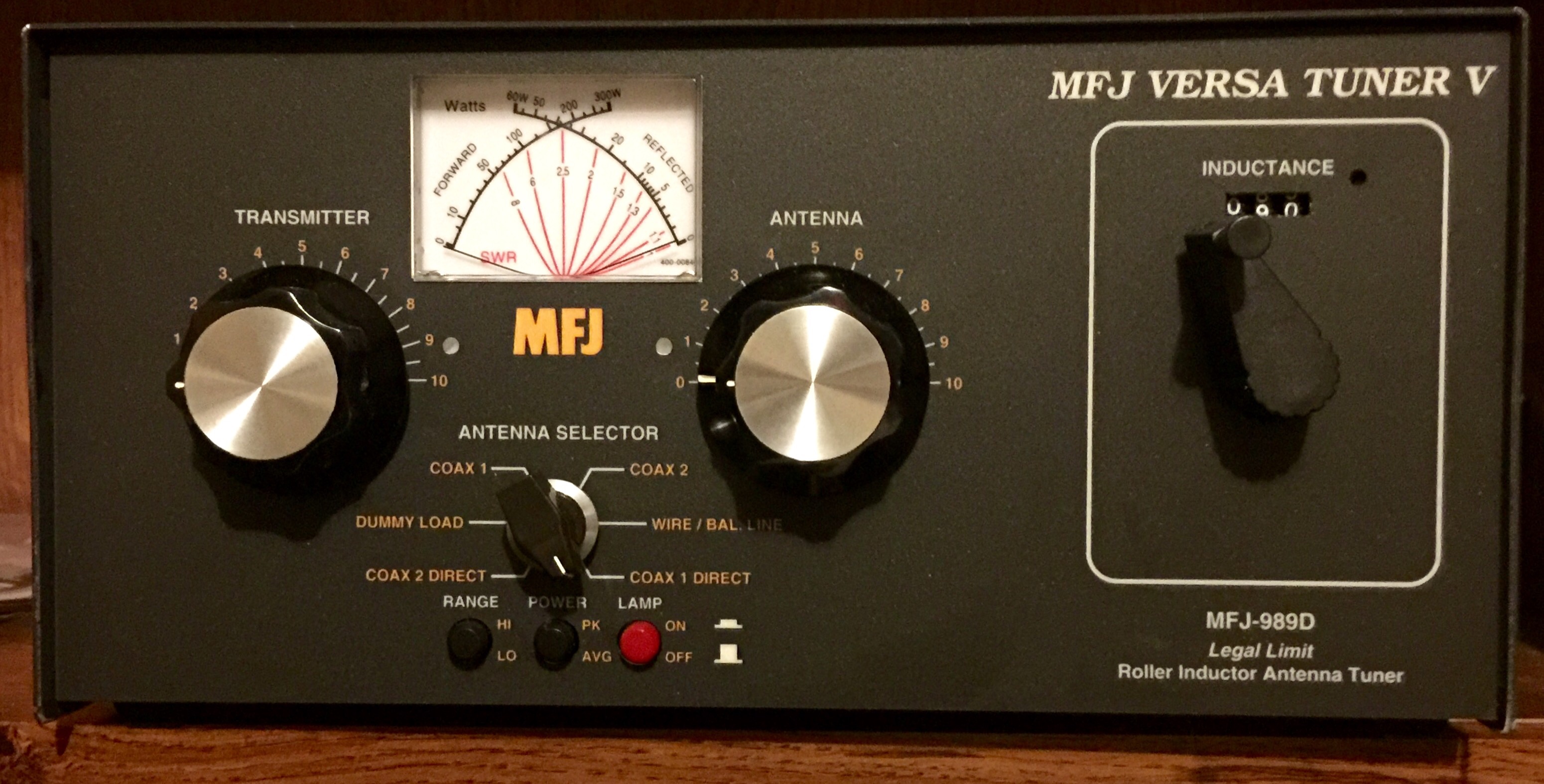

And that is the thing that goes along with what I said about reactance voltages. High SWR can cause really high reactance voltages to appear on your tuner even with only a few hundred watts. Power ratings are made assuming the impedance is such that the voltage ratings of the components is not exceeded. As for throwing a switch wbile transmitting....well you don't throw your tansmission into reverse with stopping first so why would you throw a bandswitch before you stopped transmitting?

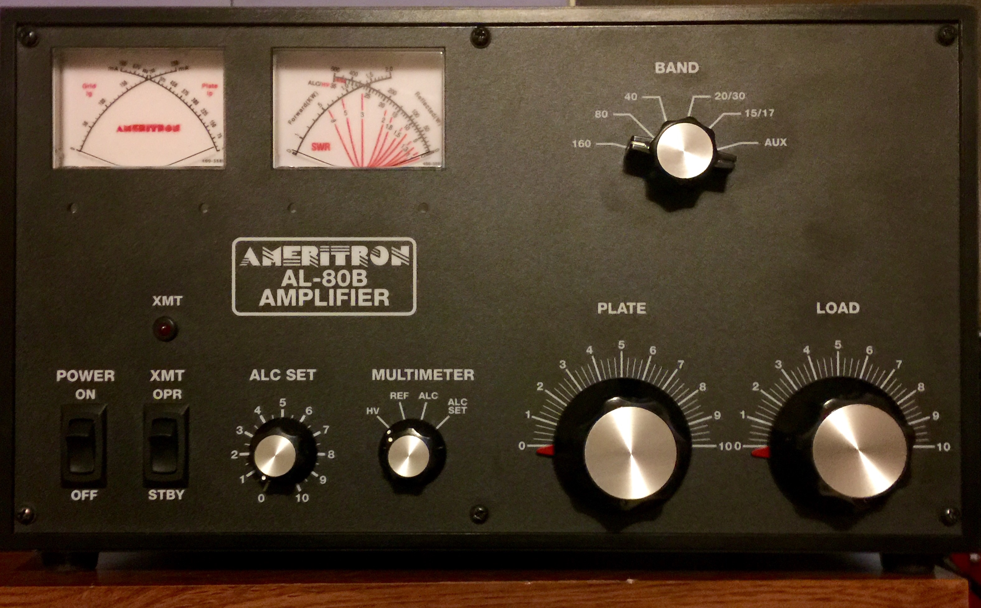

For price I narrowed it to 3 then to the 986 and 989D as far as fussier to tune got to learn sometime but I went with the 989D seems to be good enough for upto 1500watts and so handling a beginner amp and here is were a lot will debate on it but let's call it a starter amp AL-80B series before moving to a AL-82 series.
Then maybe look as a Palstar's 4-5k
