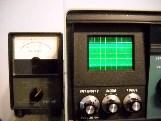

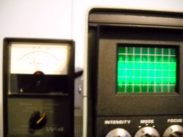

Scope VS Wattmeter
Here are some pictures I took today, showing output on my 590 with compressor on. 100W CW with wattmeter and scope, then 100w SSB. Wattmeter reads about 35 watts, but you see full deflection on the scope. Last picture is close up, showing complex waveform of the speech. Wattmeter read about 35 watts, when speaking the word, "four". Sorry for the fuzzy pictures, best I could do with Nikon Coolpix L20.
