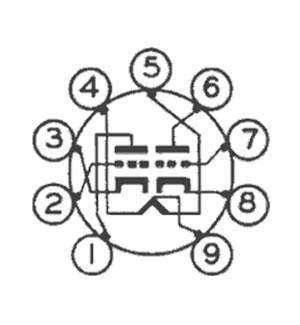

One of my tubes read at 100% , but it says it has a short on 4 pins (I think it was 2, 3, 7 & 8 if I remember right) ... the tube is a 12AT7 . I tried looking up any information I could find about vacuum tubes with shorted pins , but I had absolutely no luck at all . So I thought I'd ask here , is this tube still usable , what (if any) issues could come from continuing to use a shorted tube ? I mean , I don't think any good could come from using it . I'm just trying to find out more information about shorted pins when we find them on vacuum tubes while we're testing them . And no , I'm not still using that tube ... I replaced it . Again , I don't think any good could come from using it ... lol

The 12AT7 is a dual tube. You should see a short on pins 4,5, and 9 which is a centre tapped filament. Also you should see a short on pins 2 and 7 which is the grid. There should be no other shorts.
