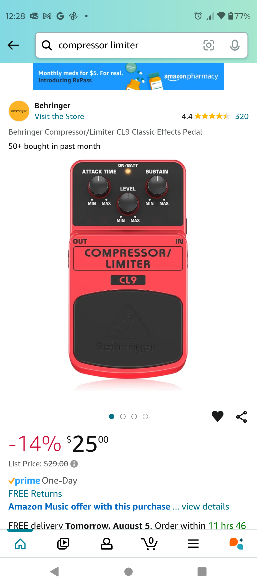

Maybe I could use a pair of guitar pedals? I wonder if the line level from the tv would be enough to drive computer speakers anyway. Might need a preamp. Not quite a simple solution, might as well buy a bookshelf stereo at that point.
That's exactly what I was looking at before I found the Behringer at the same price and brand new in the box. Line level output is appropriate for driving an amplified computer speaker. You would only need a preamp if you were trying to feed it with a microphone level.
