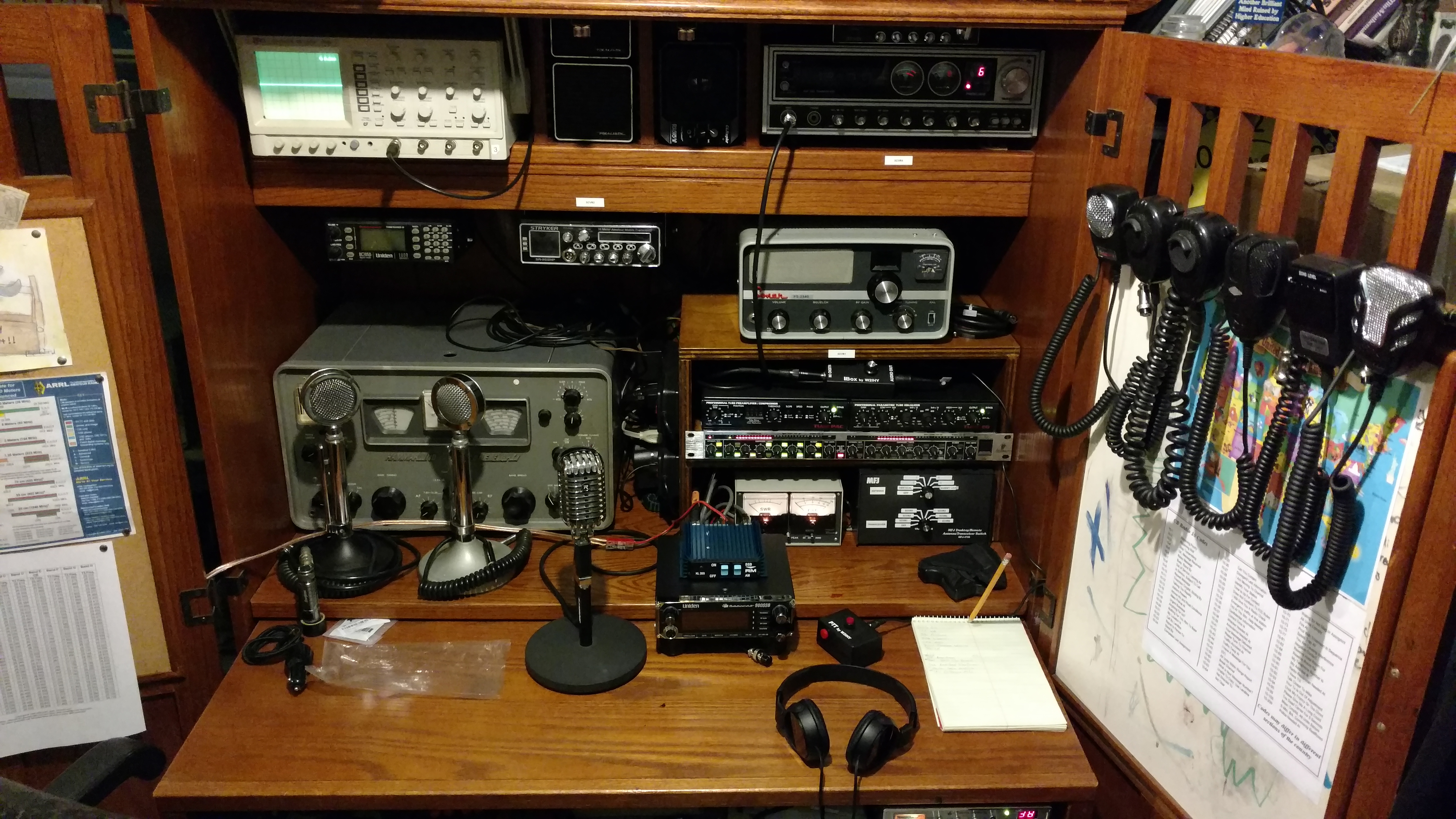

I bought this big switch from MFJ. It can do 6 radios and 6 antennas. They also make a 4 and 4. I know it's expensive but it fits so well in my setup. I can turn all my radios on and turn the knob to compare the receive on each one. I could do the same thing with antennas except I only have one and a dummy load. If I key up, I turn the others off. Even though it grounds the unused inputs it still pegs the meters. I have an extra cable for radios that make a guest appearance like the 980 with the 203 on top.
https://www.mfjenterprises.com/Product.php?productid=MFJ-4726
