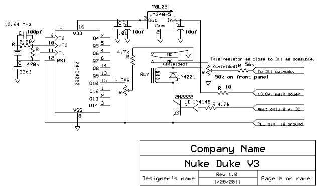

Nope. A circuit board with a 10.24 MHz crystal, a divider chip that takes it down to 10 kHz, and relay that feeds a 10 kHz square wave into the PLL's varactor diode.
And a relay to shut it off while receiving. You don't want to HEAR all 40 at once, really.
Just got 20 of the pc boards, thinking about selling it as a kit. Still contemplating a product name. The locals call it "The World Of Sound". Original project name was "Nuke Duke". After seeing what it does on a SDR waterfall display, thought about "Clone Army".
You need to add a small circuit to the radio, earlier thread on this subject (scroll down just over half way for the schematic of the added board):

So here's the schematic of the 'clone army' pc board.

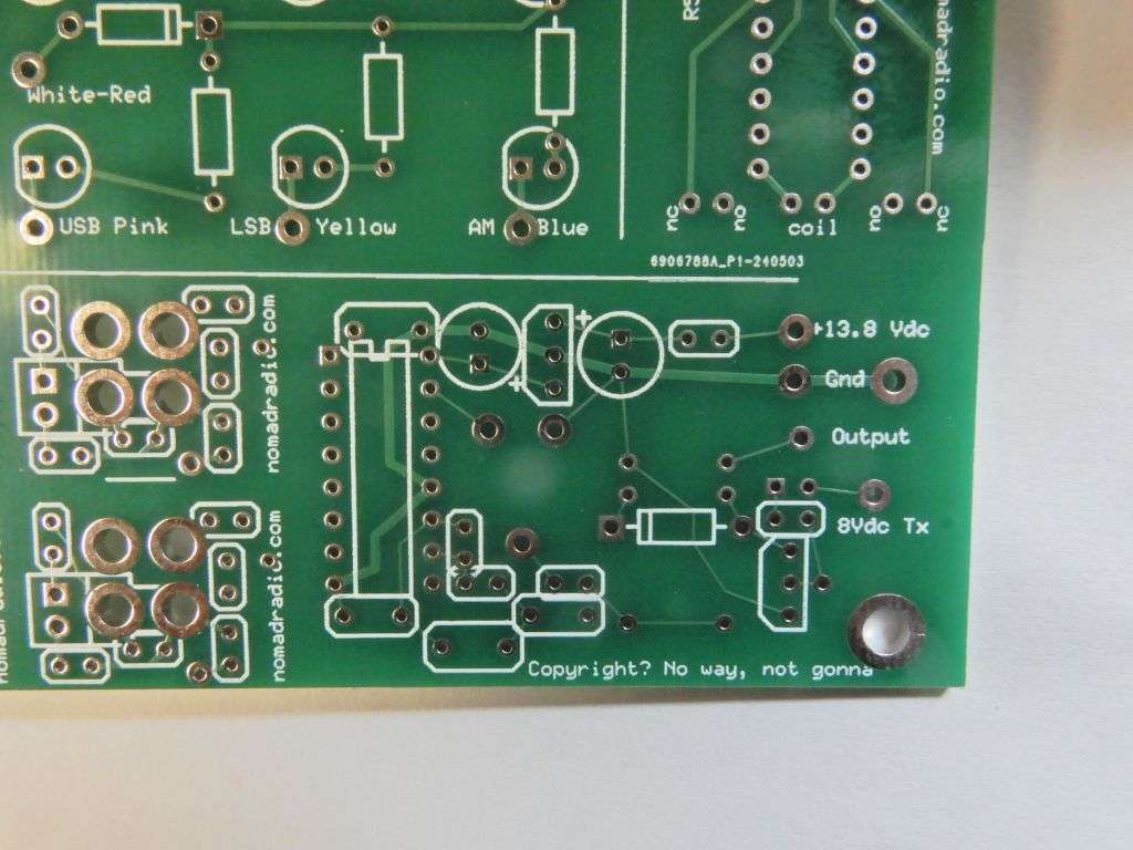

And here is the pc board for it. Hasn't been sheared off of the panel it shares with several other tiny pc boards.
No deadline for taking it any further. Got other commitments to meet for now. Never underestimate the labor needed to pull parts, pack only the right ones for each kit, lay out a step-by-step and pack them up ready to ship.
Makes building the board look easier than packing up kits.
