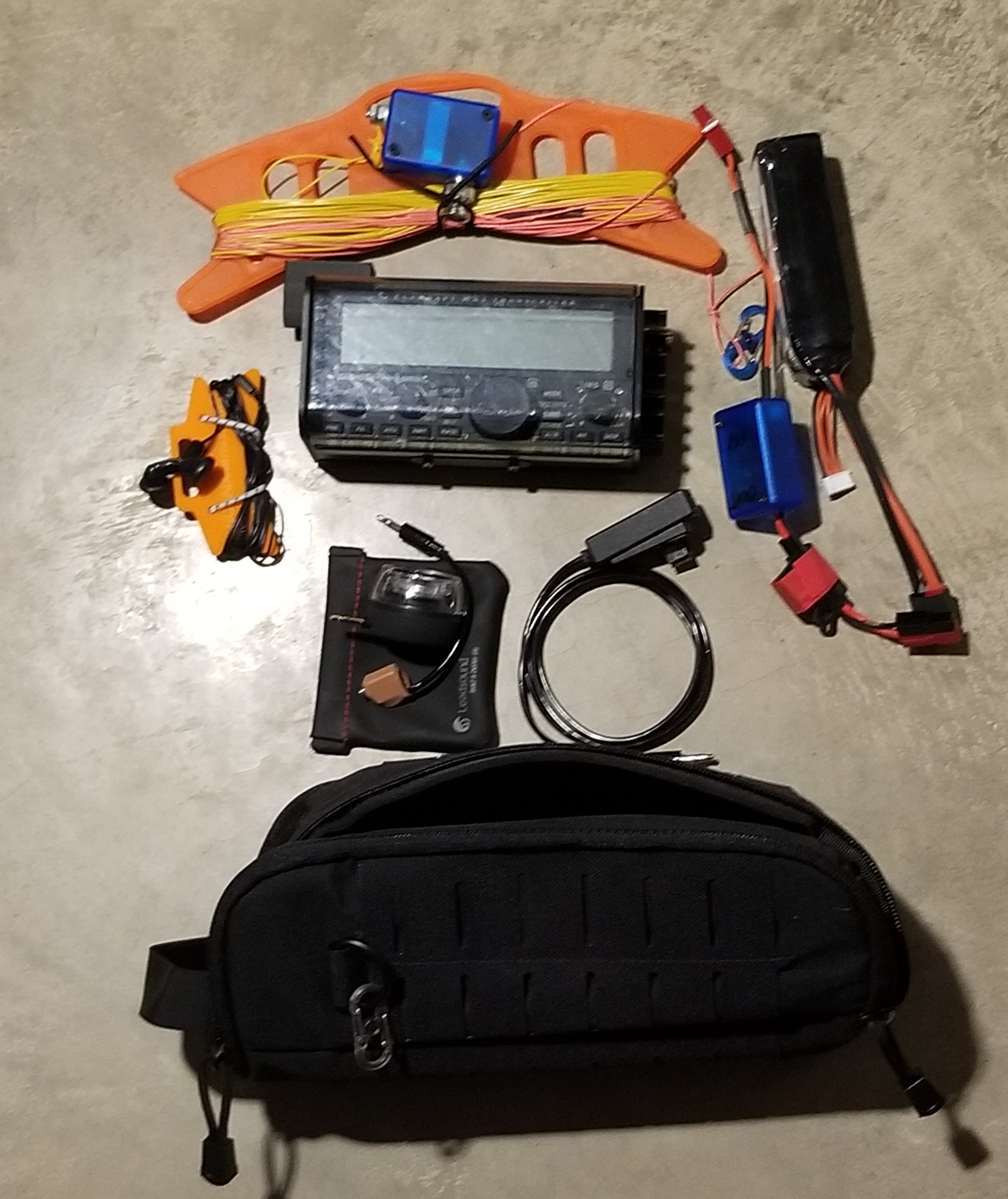

Mostly use trees for antenna support, when needed a 7.2 mr fishing pole shortened to about 6 metres. Only fix need out of close to 300 activations was a cracked Anderson powerpole connector after I kneeled on it, otherwise a multi-tool always on my pack.
