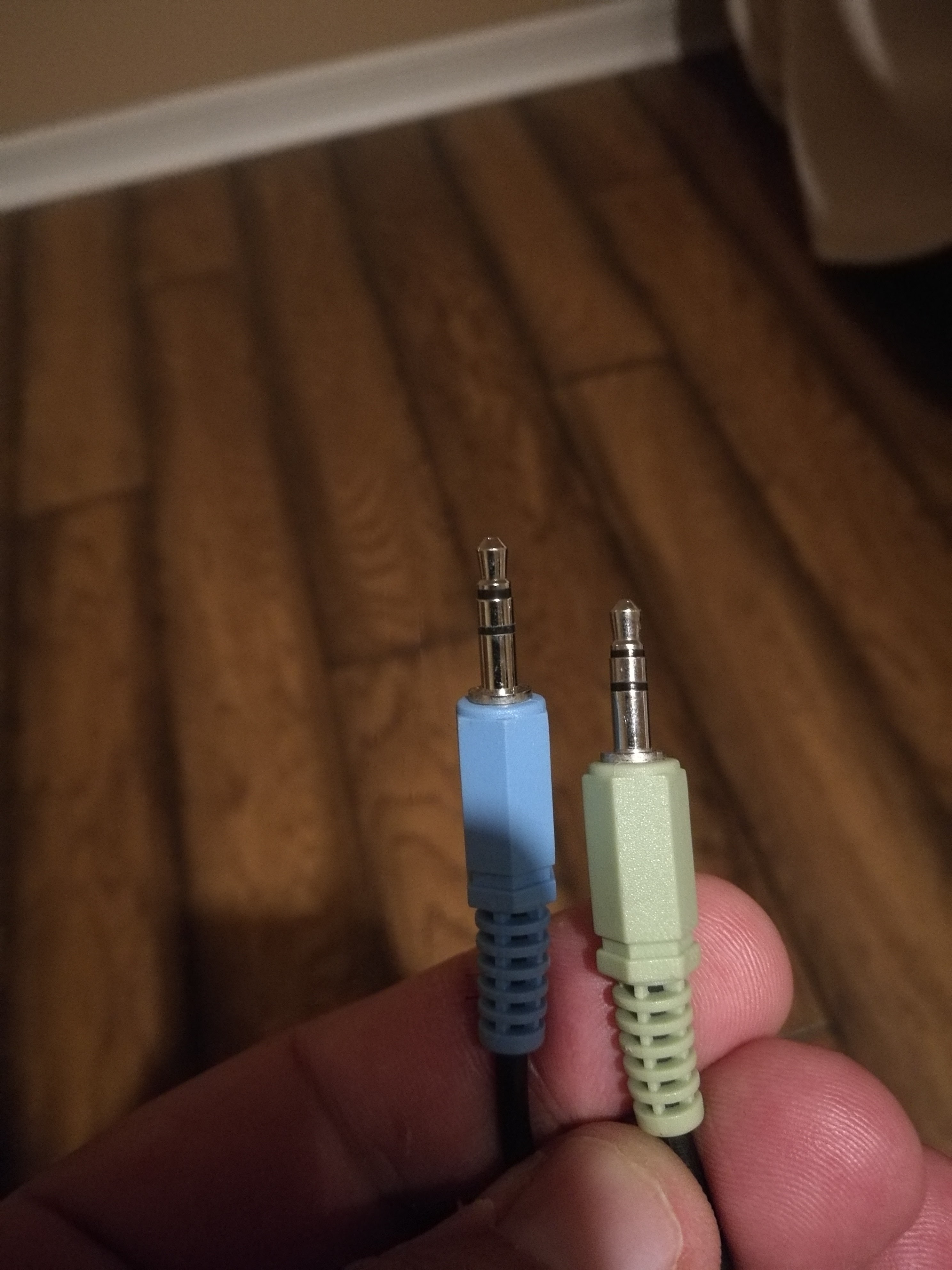

The 3.5" jack extension cable that came with the Soundock is stereo, I was refering to the actual wire that connects the speaker to radio, currently its of the stereo variant, need to get the mono version of the cable.
OK I was thinking that there was a jack on the Bose and not a cable out of it. In that case you need a stereo to mono adapter. The female end that goes on the end of the Bose cable needs to be stereo and the male end that goes into the radio needs to be mono.
Both ends of the 3.5mm jack are male and stereo variant, I just took a piccy. I think I just need same cable , mono version.
