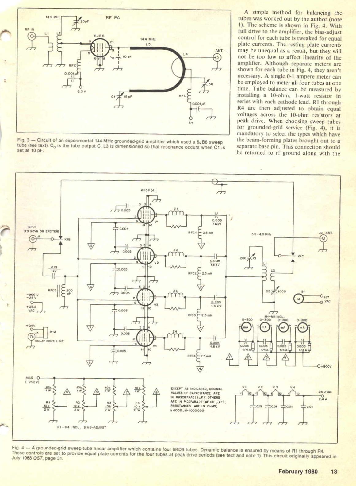

In doing some reading/searching around the interwebs tonight, i came across an old article by Doug Demaw about how to balance the bias current when you can't get a set of matched tubes to use in an old sweep tube amplifier.
I thought this was a cool idea, and might incorporate it into my next project that will be using 6LF6 tubes (well, 6LB6 unless i can find someLF6's).
here is the portion of the article in question:

notice the part in the QRO article in the schematic where it looks like a negative 25.2 volts is being sent to a remote control.
can anyone tell me what that is being used for?
looks like its for external keying, but why is the voltage negative?
in the article about balancing the bias current, it shows them using negative 25.2 volts on the control grids of the tubes.
i am hoping someone here can clue me in to why a certain voltage level is used for tube biasing?
it seems to me that they went with a 25 volt secondary on the filament transformer because that's four filaments in series, so do we just run whatever we have in the filament transformer, rectified to negative DC?
any advice or insight into this type of design is much appreciated.

The power supply schemo will presumably show the heater voltage being rectified to obtain negative 25 Volts DC.
The tubes will typically need 8 or 10 Volts of negative bias. The 10k pot for each grid is fed from a 10k fixed resistor. Makes the max voltage from the pot half the negative 25-Volt source.
Using the same negative voltage to power the antenna relay just simplifies the thing.
What it really needs is a way to cut off the tubes' anode current while receiving. Typical way to do that would be to break the ground connection to RFC5 through a third normally-open circuit of the antenna relay.
And maybe the power supply diagram shows a relay that shuts off the 900 Volts in receive mode. That's another way to shut the tubes down in receive. You don't want them drawing idle current all the time. Wears out the tubes prematurely, and makes the amplifier efficient at only one thing, heating the room. Keying the "high" side of the power supply puts more stress on the relay contacts as a rule. Keying the 'ground' side of the tube circuit puts a lower voltage across the contact points when they open up, and reduces the size of the arc in a big way.
The input is feeding the cathodes of the four tubes in parallel directly, with no impedance-matching network. This will result in a high SWR between the radio and amplifier when it is keyed and amplifying.
The original article's date of 1968 is a clue. No ham transceivers with a solid-state final yet in 1968. In the era a tube-type radios this was no big deal. A tweak of the radio's Tune and Load controls would take care of this. A solid-state radio won't be so happy about this. A pi-network to match a 50-ohm transmitter to the four tubes is not a big deal. But it's not shown, either. Wasn't needed 52 years ago.

my real question though, is where the figure of negative 8 to 10 volts DC bias for each tube comes from?
that's the type of knowledge i seem to be having trouble finding.
LC
Ahh, 'rule of thumb', pretty much.
D&A puts 8 Volts of negative bias on the control grids of the final tubes in a Maverick or Phantom. We routinely add this to the driver tubes. Factory left it off of them. Go figure.
Can't remember ever attempting to do the math to calculate this parameter.
Never needed to.
