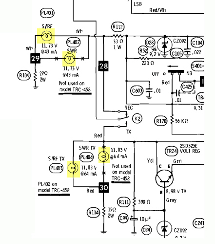

I thank all for your participation in my curiosity of the section of board that is silk-screened but lacking components on the 457 board. There is no transmit indicator light on the 457 but there are bulbs located in each of the two meter housings.
I have attached the SAMS schematic for the incandescent bulbs that are used for the two meters in the 457.
Reactions: brandon7861
