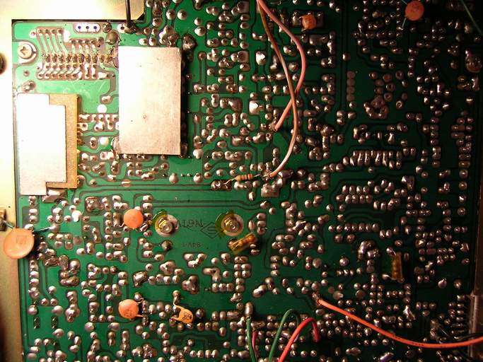

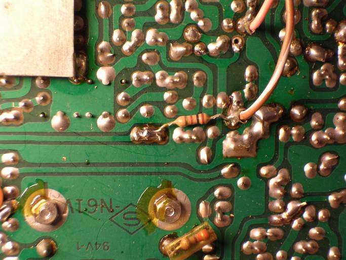

The conversion to "lock" the clarifier's receive frequency to the transmit frequency is pretty simple on that radio. One diode gets removed. One resistor gets pulled from the top side of the circuit board and lap-soldered across two foil traces on the solder side.
This has the advantage that when you tune in a station, he'll hear you on the exact same frequency.
Got pics here somewhere..
Found it! Image Shack has lost a lot of our old pics over the years. Not quite sure how they do that. But here they are.
First step is to remove D30 and R119.
R119 gets soldered to the foil traces seen here. First, a wide view to show where the closeup detail is found.
And a close view showing detail.
About as simple as it gets to lock the clarifier to transmit and receive.

Found it! Image Shack has lost a lot of our old pics over the years. Not quite sure how they do that. But here they are. First step is to remove D30 and R119 ... R119 gets soldered to the foil traces seen here. About as simple as it gets to lock the clarifier to transmit and receive.

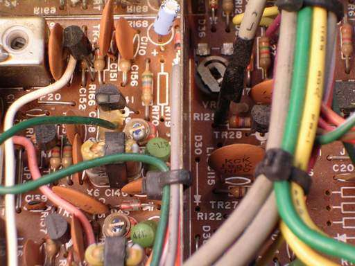

I hope the OP of this thread doesn't mind the side tracks that have been taken but here's another; expanding out on the view that Nomad has provided on the oscillator section with D30 and R119, I noticed just to the right is a small foot print where components are silk screened but not installed. Components used by another manufacturer for another radio? Anyone have some insight on this?
I have never tried to trace out what those parts would do. Was it a feature left out? Or a feature that didn't work out as intended? Somebody ought to draw up what those missing parts connect to. Sometimes my lack of curiosity can be apalling.
