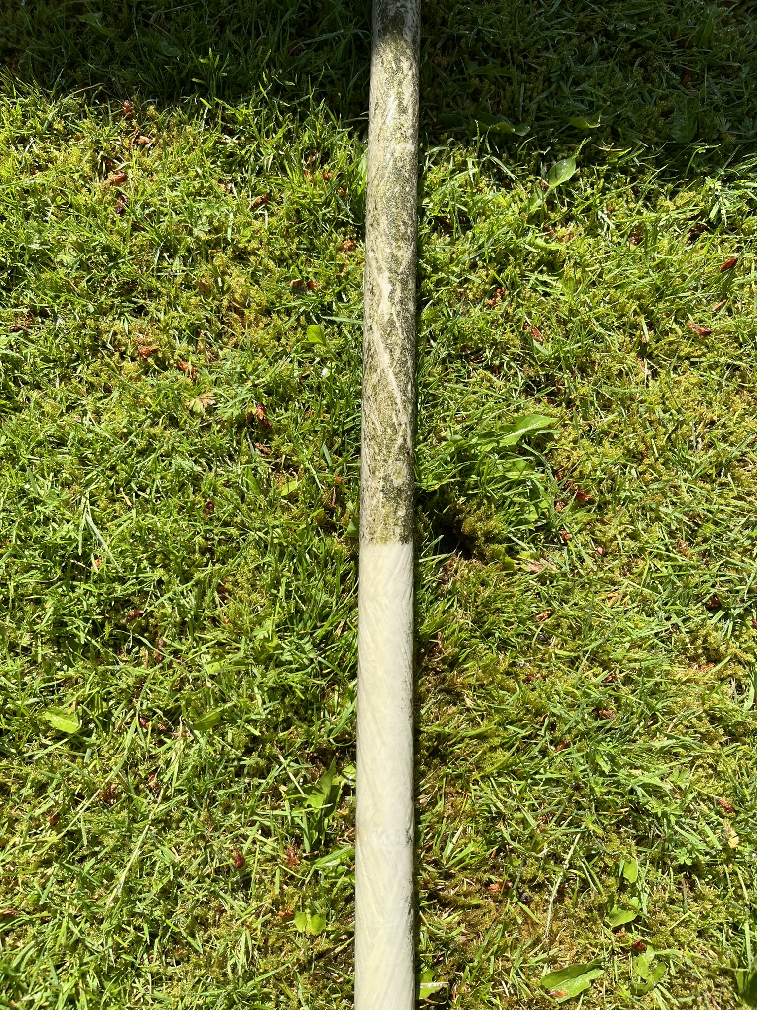

will most definitely be painting the spreaders before this thing flies. I'm anticipating yearly or so repaints.
Look into marine grade fiberglass paint. It should last longer than most other paint.
I have a Lightning Bolt 5 band quad. I just took it down for a few repairs after 15 years or so. It has fiberglass spreaders and they have a pretty rough finish. They were just really dirty so I used a pressure washer to clean them up and they look almost like new now. They were never painted. There are a few fiberglass threads that have popped up here and there on them but it was kinda like that when new anyway. Looks like they will be good for many more years. All the other parts are still good.
Here is a picture of a spreader half cleaned. It all came off easily. The pressure washer is about 1600 PSI, about the same as at a self car wash.

Thanks much for that info, much appreciated. Hope to be here long enough for them to need replacing.
