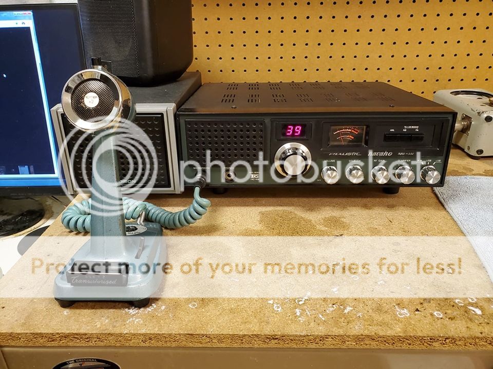

This is my latest project. Bought this radio plus the mic for less than a C note. Did a full recap on the radio with a couple minor cap changes to open up the audio bandwidth a bit. I was chatting to a buddy and had a guy in DX holler at me, said I had FM broadcaster quality audio. Apparently, he had an SDR setup, and was running an Icom 7300 (is that right? Icom did make a 7300?) and he said my radio sounded amazing... didn't believe I was on a CB until I sent him a video of our conversation. It's been a great radio.

Did you also replace C179? (before it detonated?)

Yep, I replaced C179, it was still original and intact, amazingly enough. I also removed the input/output wires going to/from the little NB board, and replaced them with shielded wiring, and my noise level went down about another half an "S" unit. Super quiet RX until I get actual RX audio.
The Turner +2 is THE mic for me... it matches up to my voice extremely well. I want to get a couple more down the road for other radios. For now, though, my modified D104's do a pretty good job of matching up with my voice until I can get more +2's.
