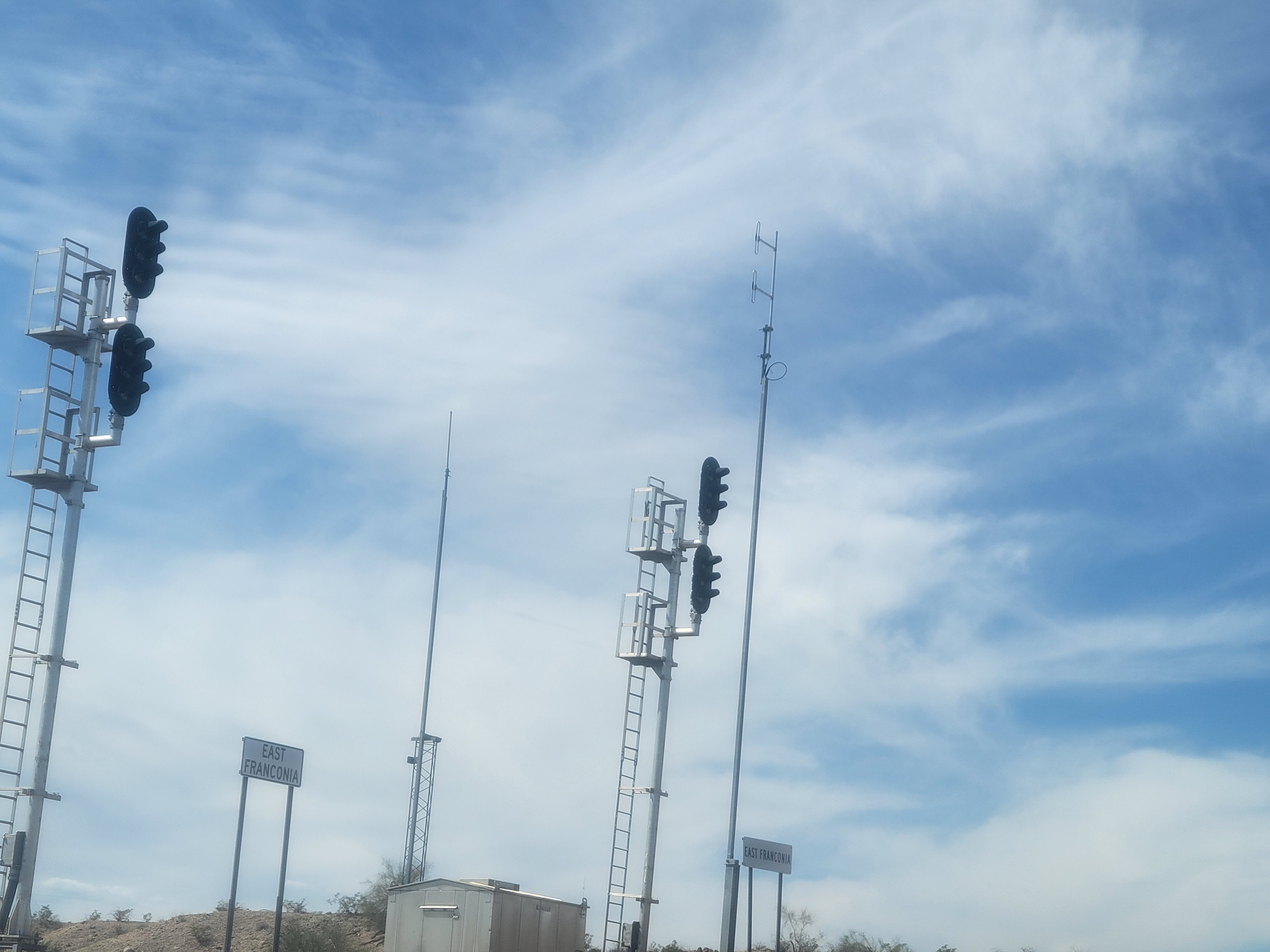

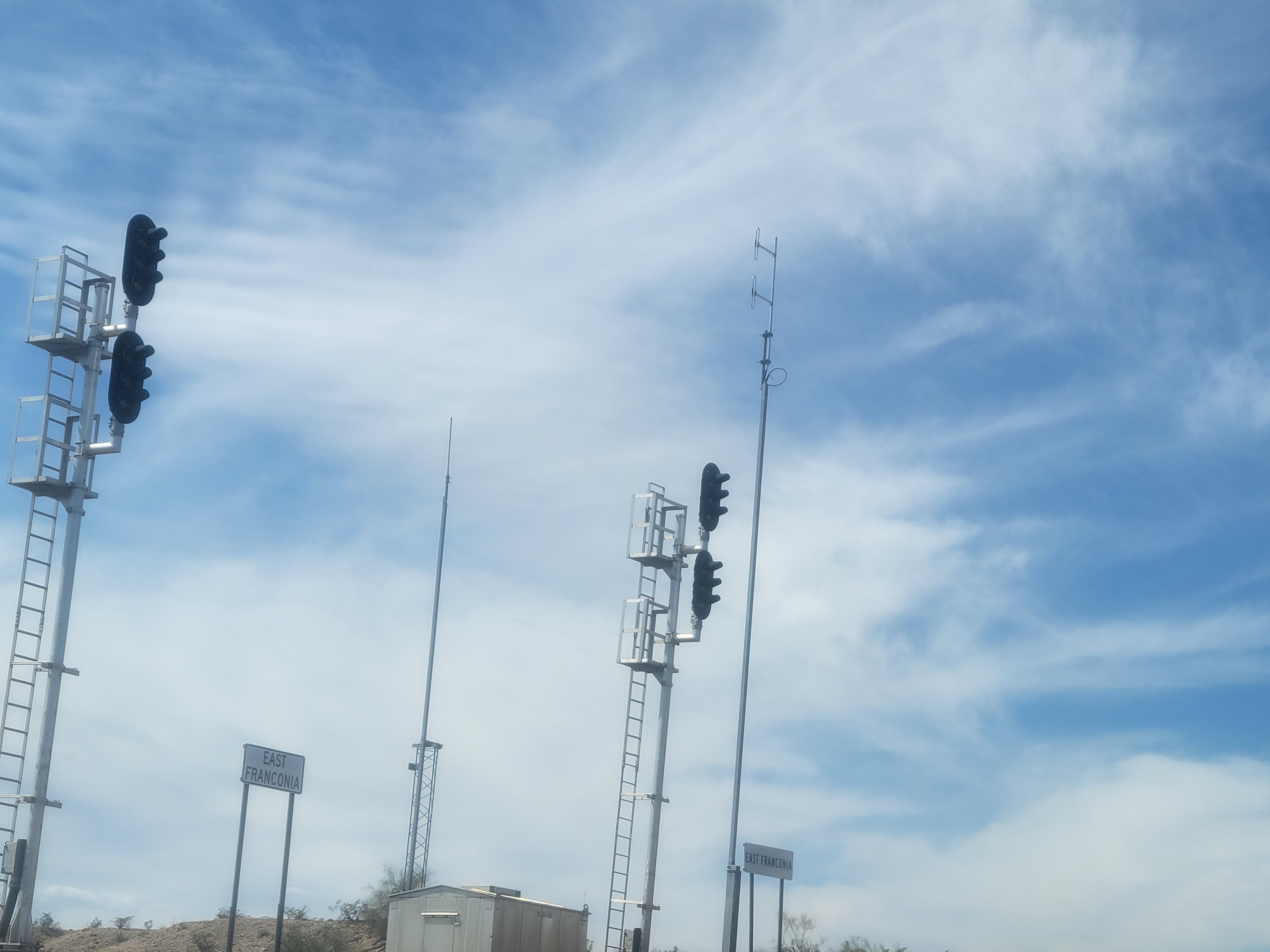

Hello! I am a avid train enthusiast. And I see these loop style antennas up and down the B.N.S.F line
I am wondering if they are for voice or Data transmissions? Also what frequency range are they??

Railroad frequencies in North America are pretty much all in the 160 to 161.5 range. They have a channelized system that is standard everywhere. I have seen the list online that gives you the frequencies they use and the equivalent channel numbers.
They use a lot of analog voice for dispatch work, and train to train chat, and there are also automatic trouble detectors trackside that radio the engineer as the train passes them and use a computerized voice to detail any problems with the train cars.
They likely use data bursts as well, either before or after each voice transmission.. That's the brrrrrrrt sound you here. All of this is very easily monitored on even the cheapest of handheld scanners, as none of it is digital or scrambled.
Hearing what's happening on the railroads radios adds a whole new dimension to railfanning !
