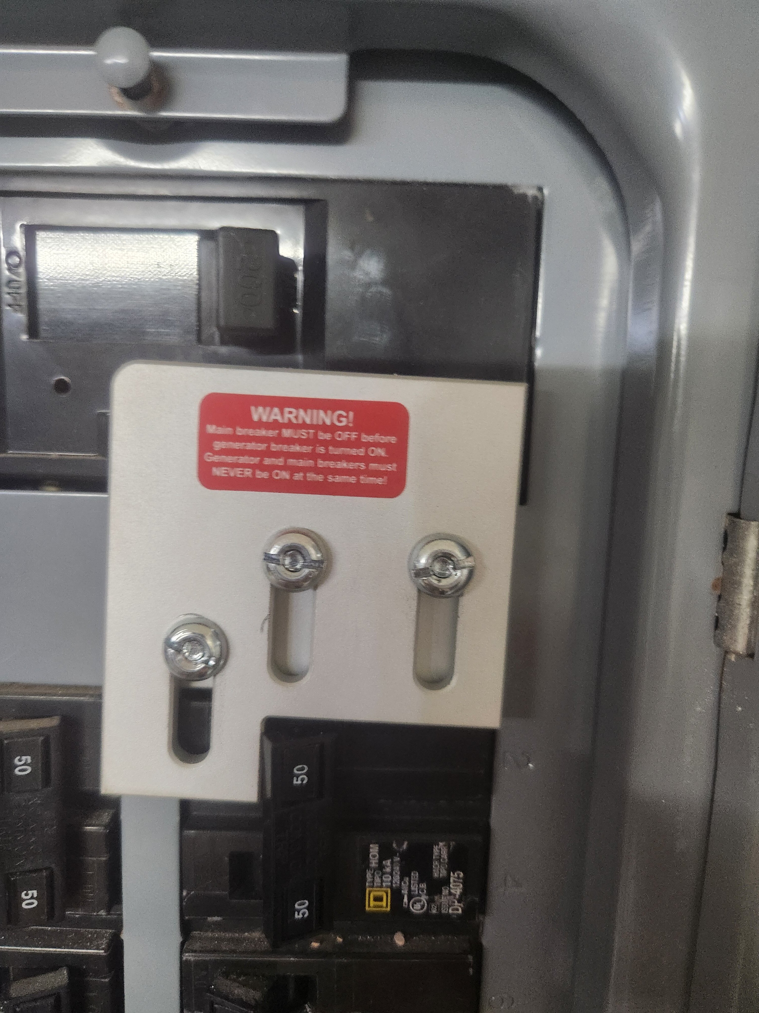

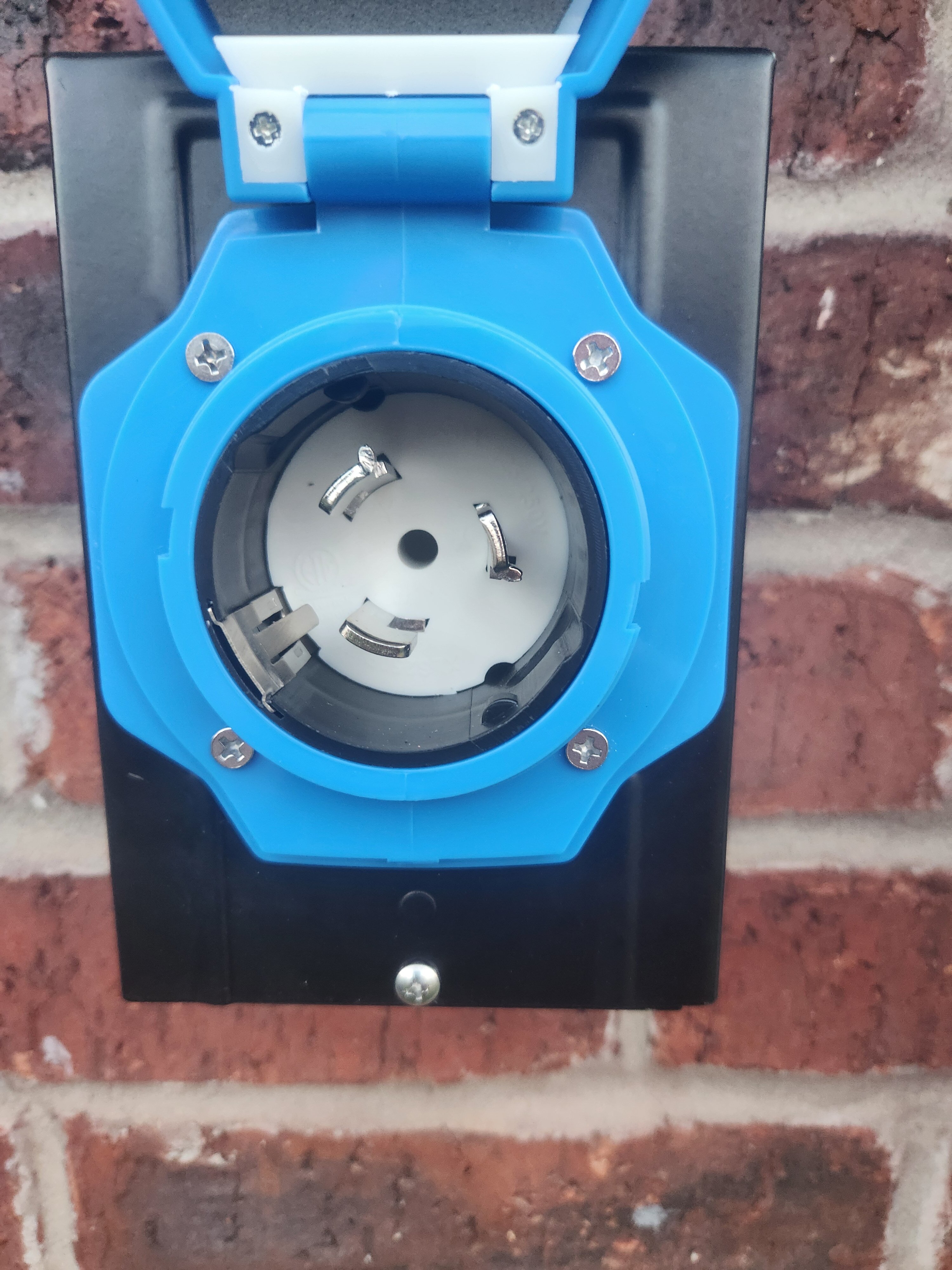

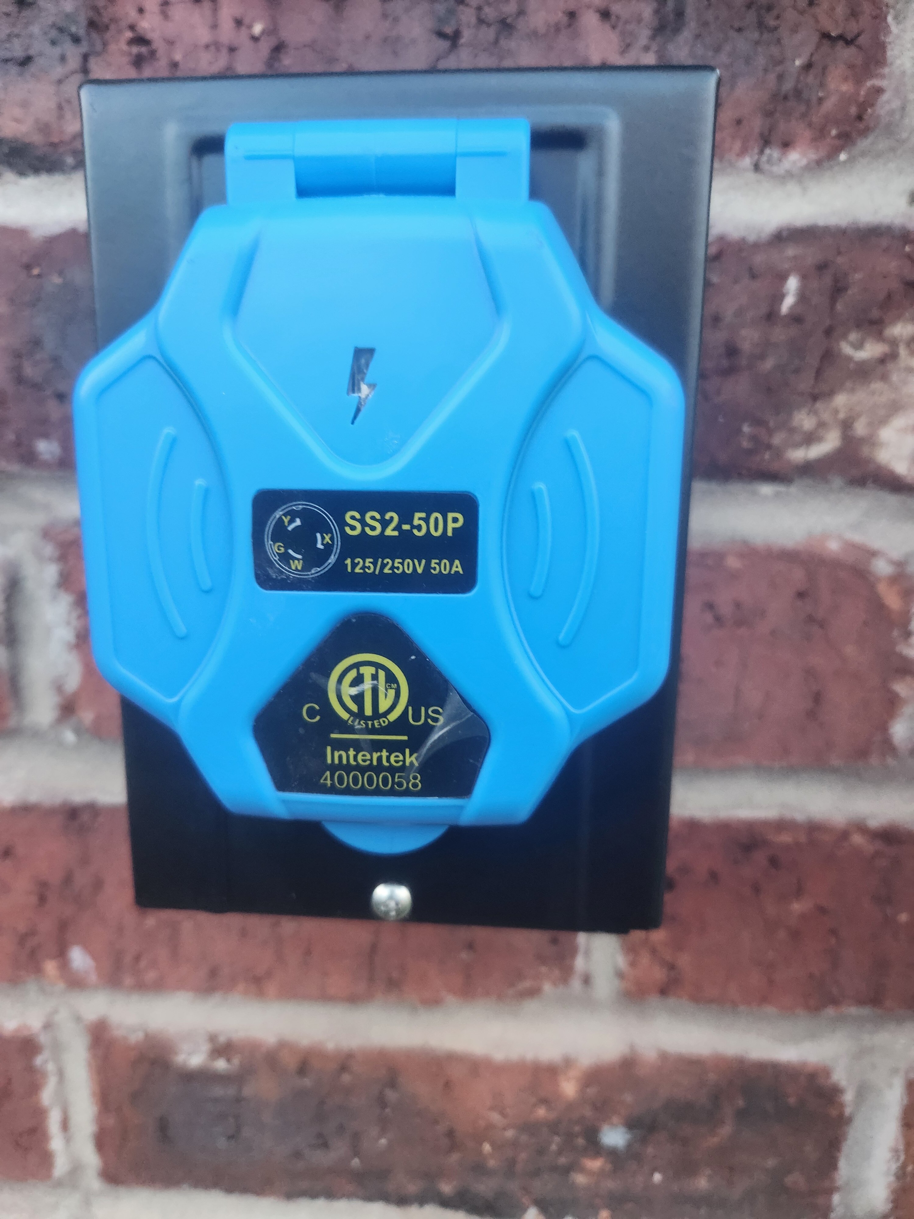

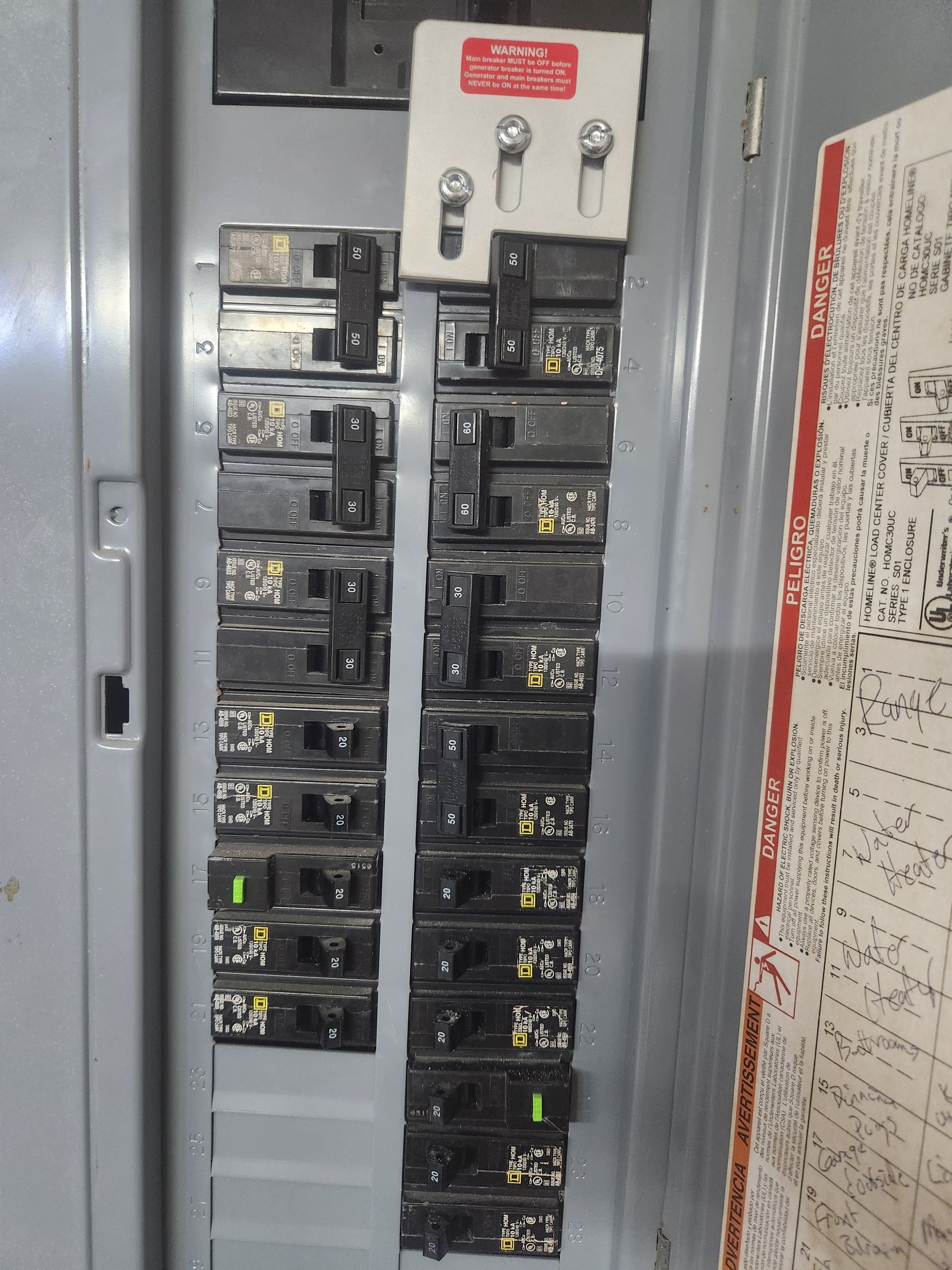

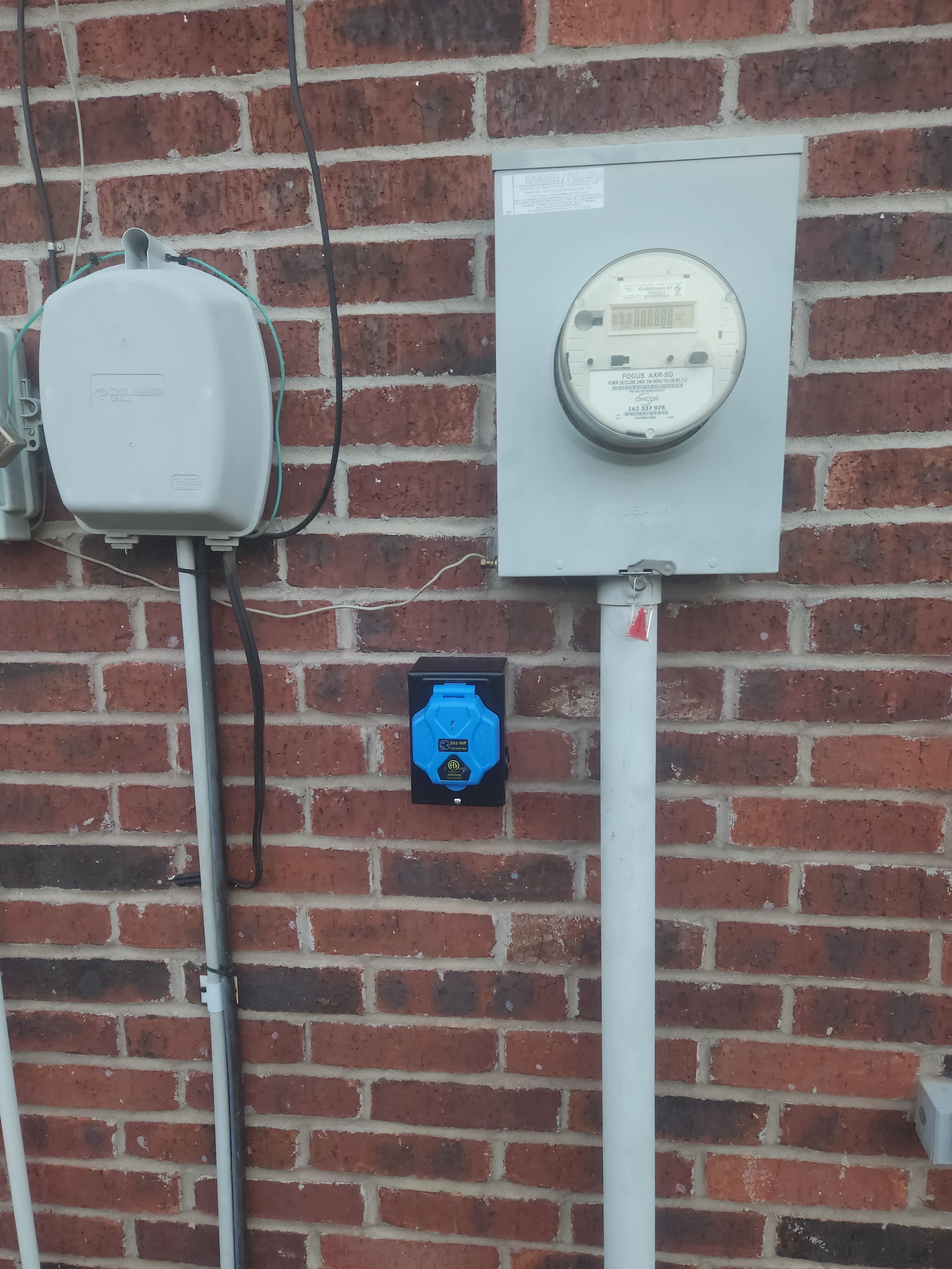

As the favorite question in this forum goes. Today I installed 50 amp generator inlet box and interlock kit to my panel and verify I say unto you with my two dual fuel parallel kit if needed 4600 watt each generators I shall have power throughout all of my lands (sans 220 because these generators I also use for power on pop up camper trips are 110 capable only) but I have wired with being future proof in mind vs cheaping out on a 30 amp box and wire should I choose to get a godzilla generator that does do 220 at a later time.

I do not have a main breaker box, but a branch circuit breaker box outside.
I just pull out some breakers and wire up some jumper wires here and there.
I have a cable with stranded AWG 10 to plug into the generators'
240 VAC at 20 amps output.
I can run the 240 VAC window AC unit in my living room. all
my 120 VAC lights, refrigerator. keep the beer cold!!

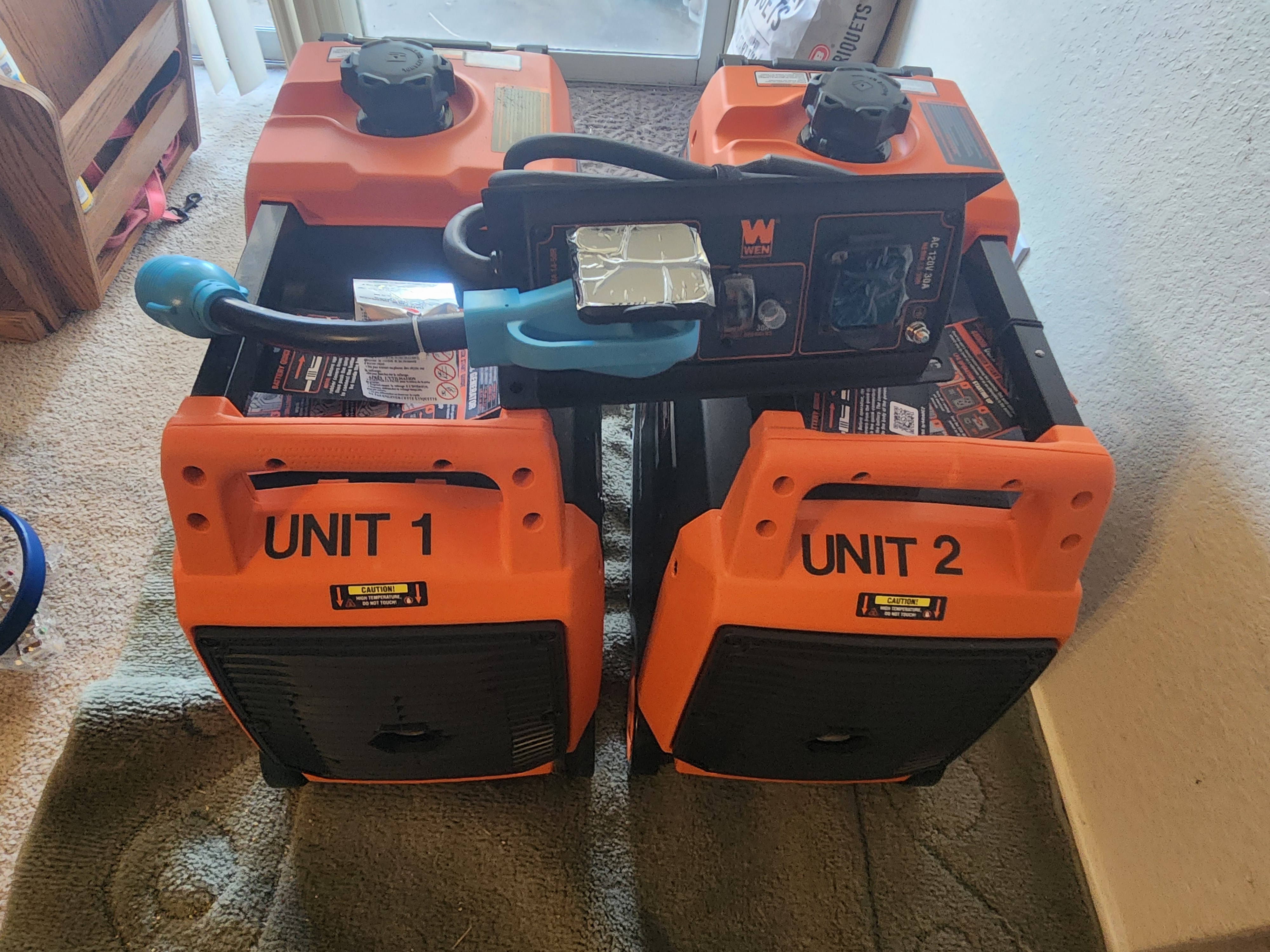

Hey we do whatever works right? I just got tired of 30amp rv cord to multiple extension cords and unplugging and replugging stuff so decided not this year lol my wires I used were 6ga. Talk about a pain to route lol!

As the favorite question in this forum goes. Today I installed 50 amp generator inlet box and interlock kit to my panel and verify I say unto you with my two dual fuel parallel kit if needed 4600 watt each generators I shall have power throughout all of my lands (sans 220 because these generators I also use for power on pop up camper trips are 110 capable only) but I have wired with being future proof in mind vs cheaping out on a 30 amp box and wire should I choose to get a godzilla generator that does do 220 at a later time.View attachment 71041View attachment 71042View attachment 71043View attachment 71044View attachment 71045View attachment 71046
I learned something new here. I never knew they made a metal plate to prevent both circuit breakers from being on simultaneously. Thanks for the information.
Glad Ive finally contributed. Usually its you lot bailing me out lol. It is required by code here for this type of simple DIY setup, naturally transfer switches etc handle that if youre spending big money. It's called an interlock kit and which kit depends on what type of breaker box you have as to what design you need but they all provide the same function. To not allow power to accidentally backfeed into the lines and potentially harm line workers not mention your own home if you flipped the wrong thing concurrently.

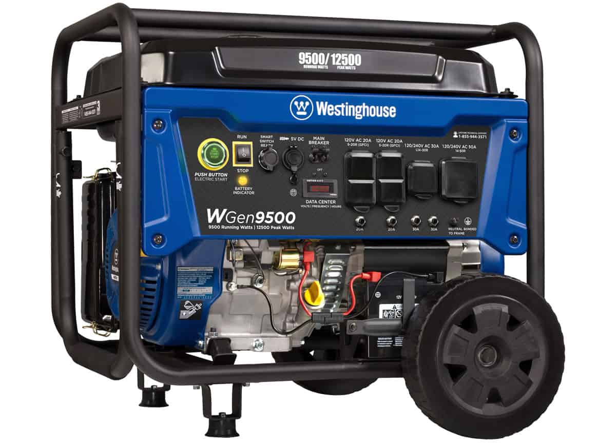

This was delivered last week and is replacing the Generac generator that has saved our ass on multiple occasions. The worst was the winter storm in February 4 years ago. Temperatures hovering around zero degrees fahrenheit and the grid was down for 3 days. That generator ran for three days straight with the exception of refueling.
The Generac was 14 years old and needed more love than I had time to give, so I gave it to a mechanic friend of mine. I keep things like this to myself with the exception of a friend or two and some local family members. They all know I'm prepared to a certain extent. Food, water, power, plus a multitude of other necessary items.
That is a Dandy & should GET-ER-DONE and looks like electric start like mine. But it will be a heavy sucker so find it a permanent home. ENJOY
