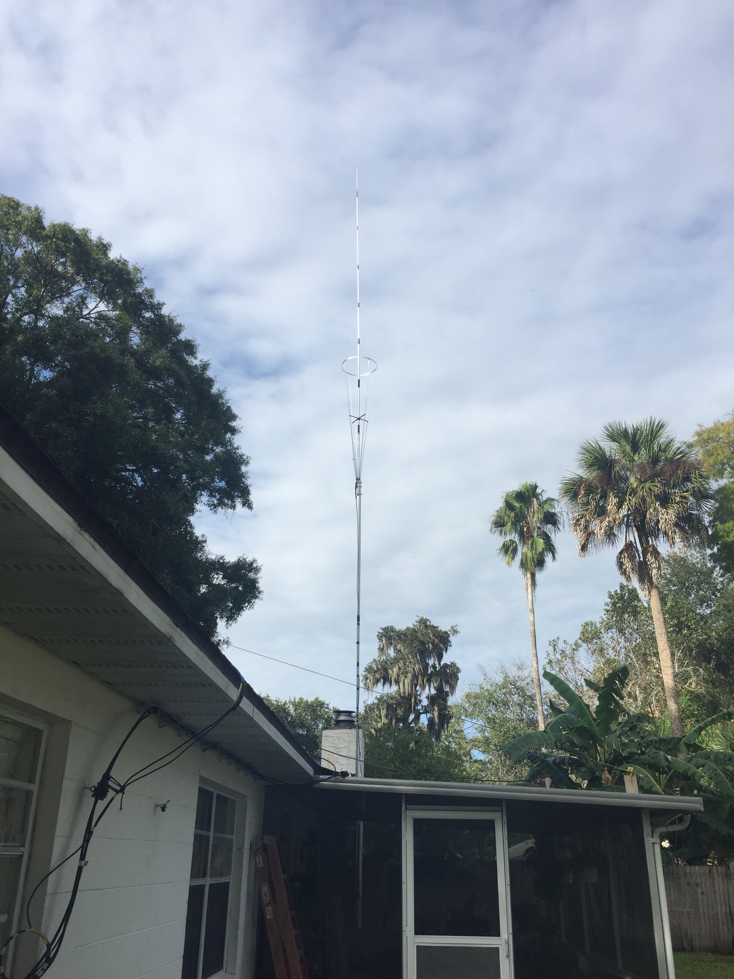

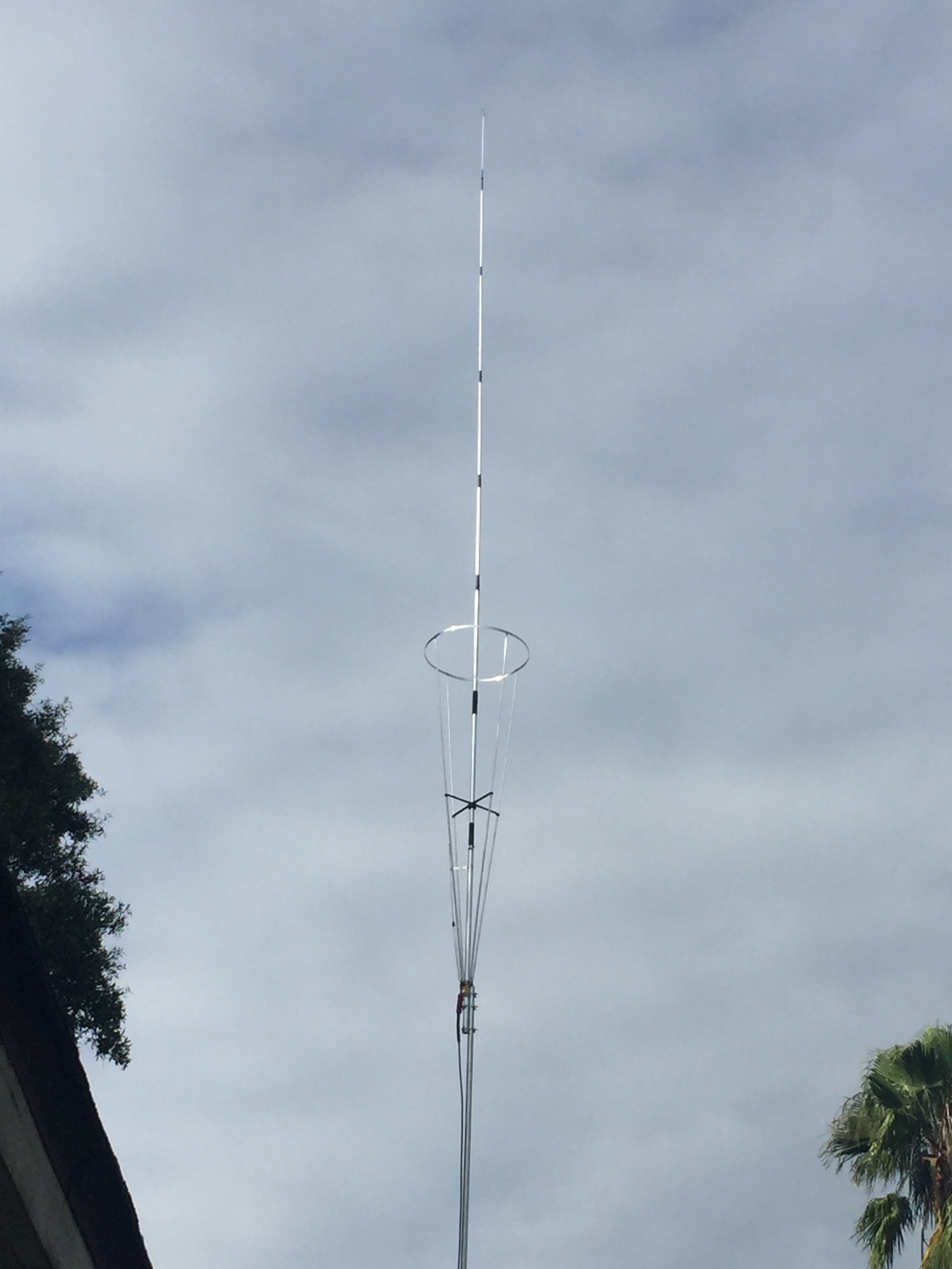

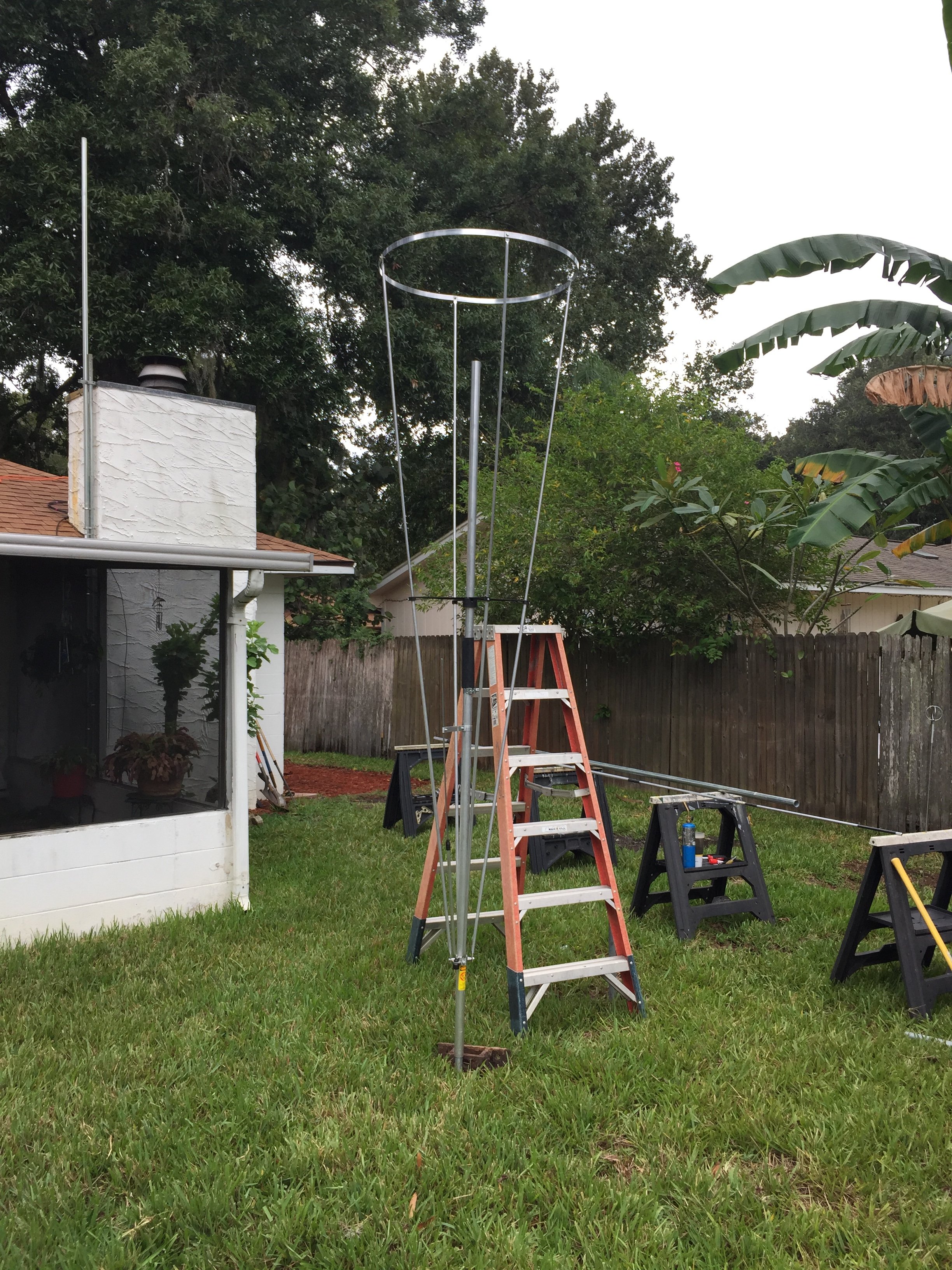

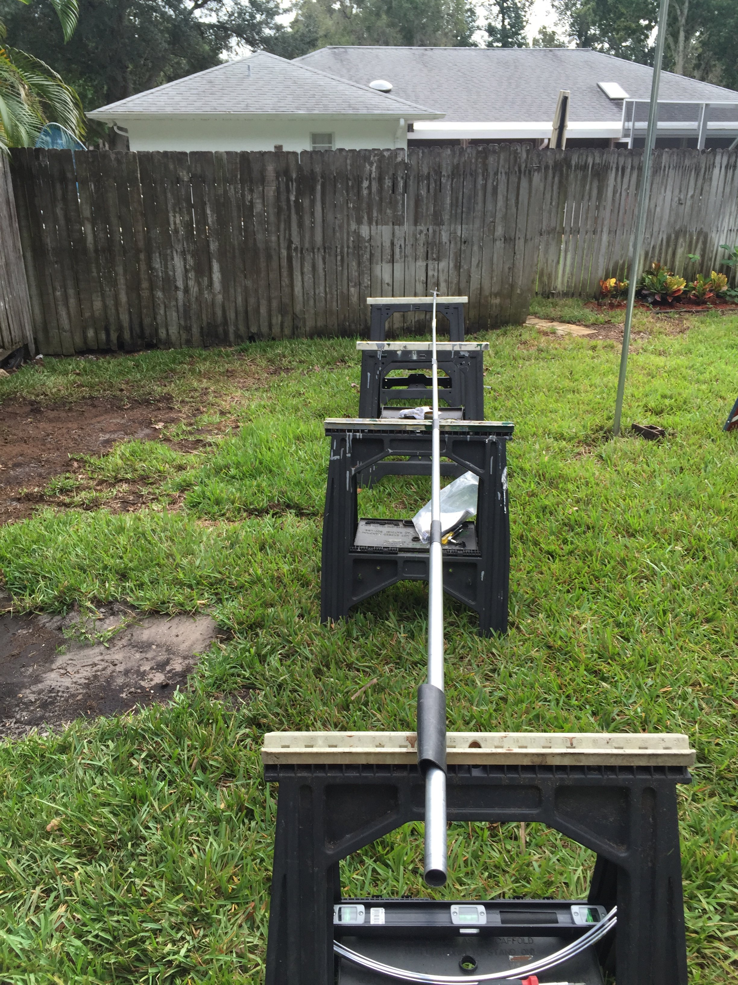

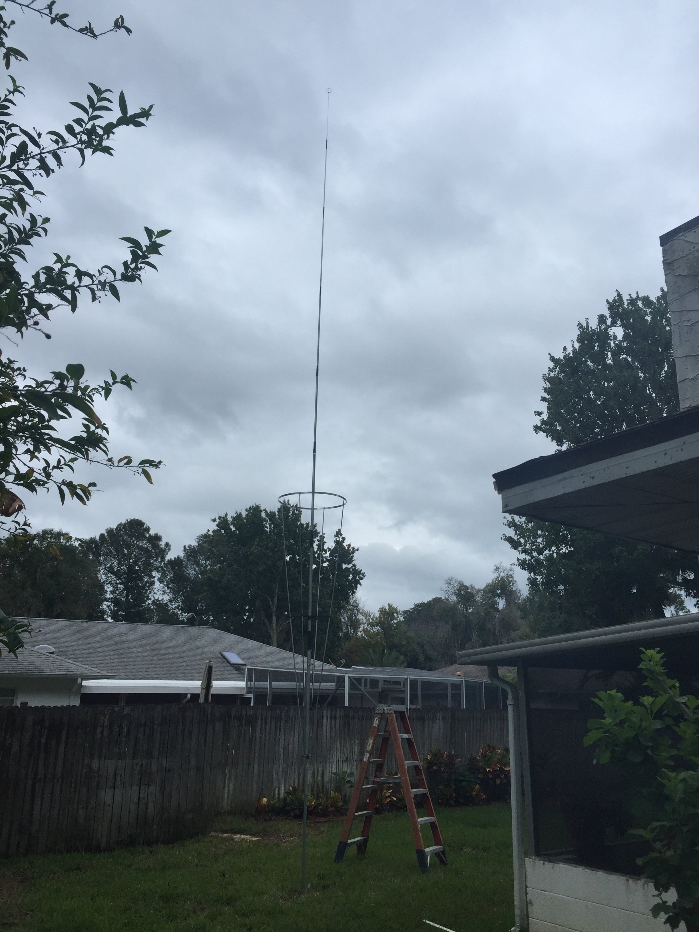

Okay the vector 4000 is up. Need to get analyzer on it and re adjust the gamma match a bit. It shows at the moment on channel 1, 1.1:1, and 40 is 1.2:1. I know, I know it's good, but I want it best it can be and I know it's got to be adjusted for where I talk more which is upper part of 11 meters. Anyway here are a few pics. Heat shrink used on all connections as well as no-ox. Antenna went together easily. Adjusting it is a bit harder without analyzer LOL. But it is up at near 30ft to feed point. Here are some pics.

222, your install looks great.
If the analyzer also shows similar SWR results to the frequency readings you reported above and the values for resistance is close to 50 ohms and reactance is modestly close to 0 ohms at or near resonance...then I wouldn't touch a thing.
If I felt I had to have the frequency show resonance a bit higher...I would make the top element a bit shorter, and not mess with the gamma.
But again, I don't think you need to adjust anything.
Reactions: 222DBFL
I did adjust top whip once. Vswr is good across 40 channel CB but I like to venture above 40 and the vswr starts creeping up fast over 27.425. I need the analyzer and I'll have it set perfect. I have gotten great reports so far. S9+ locally and S9 to Arizona just now as well. The antenna is def working!! Floor noise is down from before by 2-4 s-units on AM. From S7-S9 to S3-S5. I am a happy camper and was told by 2 locals not to touch it LOL. Thx for the compliment. It took me all of one day to build and install this antenna. Minus the mast. But it's done and done right.
