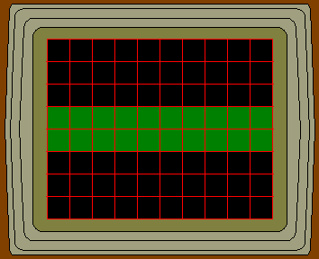

Top Gun Tech shows similar scope patterns with the CP-1 compressor and MD-1 modulator modules "on" - right pic.
Are these circuits accomplishing the same thing by different means?
Picture on the left is compression/modulator "off' .
Comment CBDoctor?
I don't see ANYTHING that is being done that will inhance the signal. The best that I can see, there is no positive peak inhancement. It is apparant that the negative peak is somewhat compressed due to it's brightness but it does no good to compress the negative peak while still limiting the positive peak and that is what the pattern seems to show.

Rob, that looks like classic 100% modulation where the peak voltage is twice that of the unmodulated carrier.
Look at this site about 1/2 way down, starting figure 6
http://www.icycolors.com/nu9n/scope_your_audio.html
I'm still waiting for the pudding. We'll see if the proof is there. I'll be surprised if the key measurements are even shown, much less set up correctly.
OK, Rob. Maybe you copied the wrong image.

Inorder for this type of modification to provide a performance increase, it is necessary to compress/clip/limit the NEGATIVE MODULATION PEAKS, not the carrier. Positive peaks should be between 120 - 130 %, and negative peaks should be limited to about 95 %, or supressed to just about the level of the carrier. This is the classis AM Broadcast station setup that produces increases loudness without generating harmonics and splatter.
