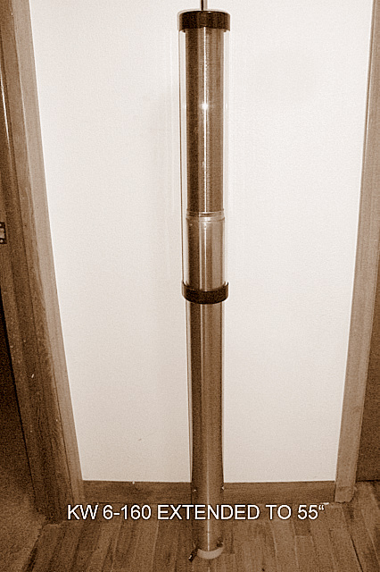

Binrat: Here's the one I am using on my ZR2/S10/Chevy....Most likely moving to full size Ext. Cab very soon....this antenna has been excellent...very pleased!....mounted on the tool box behind the cab....
I had an amp for months now...never installed...100watts is all I've needed even on 75m...
Larry's antenna will be on the new truck also...(y)

PS: Check out the "Shorty" BIG coil version

That Shorty looks interesting and won't overly make the truck look like crap (XYL) I wonder if it works that well.
I sent an inquiry from their site. Got an e-mail not too long after with suggestions for installing the shorty.
It's typical for any screwdriver type antenna to get 'pickier' the more 'compact' they are. Meaning that finding the 'resonant' point will be a bit more difficult, you have to be 'quicker on the trigger' with that up/down switch.
As far as how well will any particular antenna work, that's a matter of how much care you put into mounting the thing, where, and all the same old thingys you have to deal with in any antenna set up. And then you're back to another 'same old thing', just how 'short' is the thing compared to the 'full sized' antenna? The shorter ones just can't be as 'good' as the longer ones at HF.
The bug-catcher and screw driver antennas are more efficient than other types of HF mobile antennas because they are 'larger' (longer, larger coils, etc.). The lower in frequency you go the bigger that 'larger' has to be to be efficient. At the lower end, on 80 meters, you are looking at an efficiency of maybe 3 to 5%. Doesn't sound like it's worth the effort, but it's typical and lots of people find it works just dandy. (Same efficiency with higher power, just more power being radiated.)
