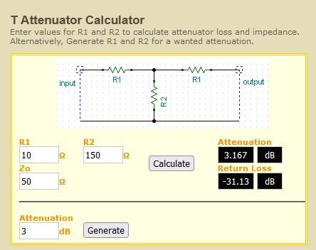

Only 3 non inductive resistors.
Isn't 5w a bit extreme? I'm all for over-rating parts, but....
Edit: And I know my math is right, because when I add up those wattages, it equals half of what was put in, 3dB :) Also edited photo to smaller size. 28MB was nuts. Sorry.
