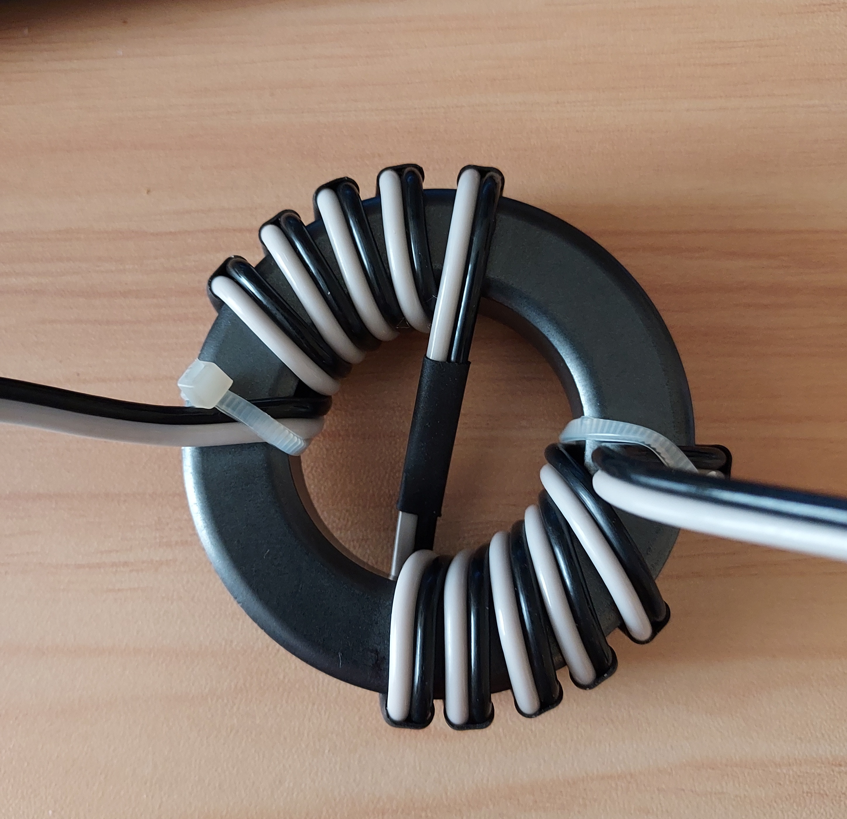

Several folks here say that it's overkill but I made a 1:1 choke for my 10m Inverted V. I was seeing symptoms of Common Mode and it cleared it up completely as far as I can ascertain.
I also did it because I wanted to learn how to do it. Was not difficult at all.
That's a Fair-Rite FT-240-43 Mix. The wire is 14 awg Romex I had laying around.

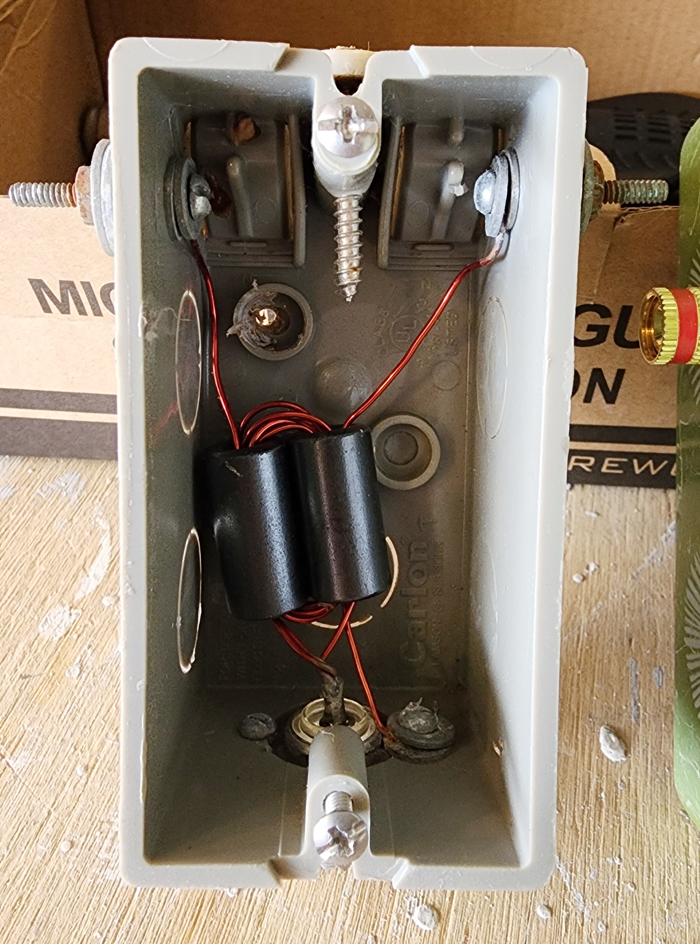

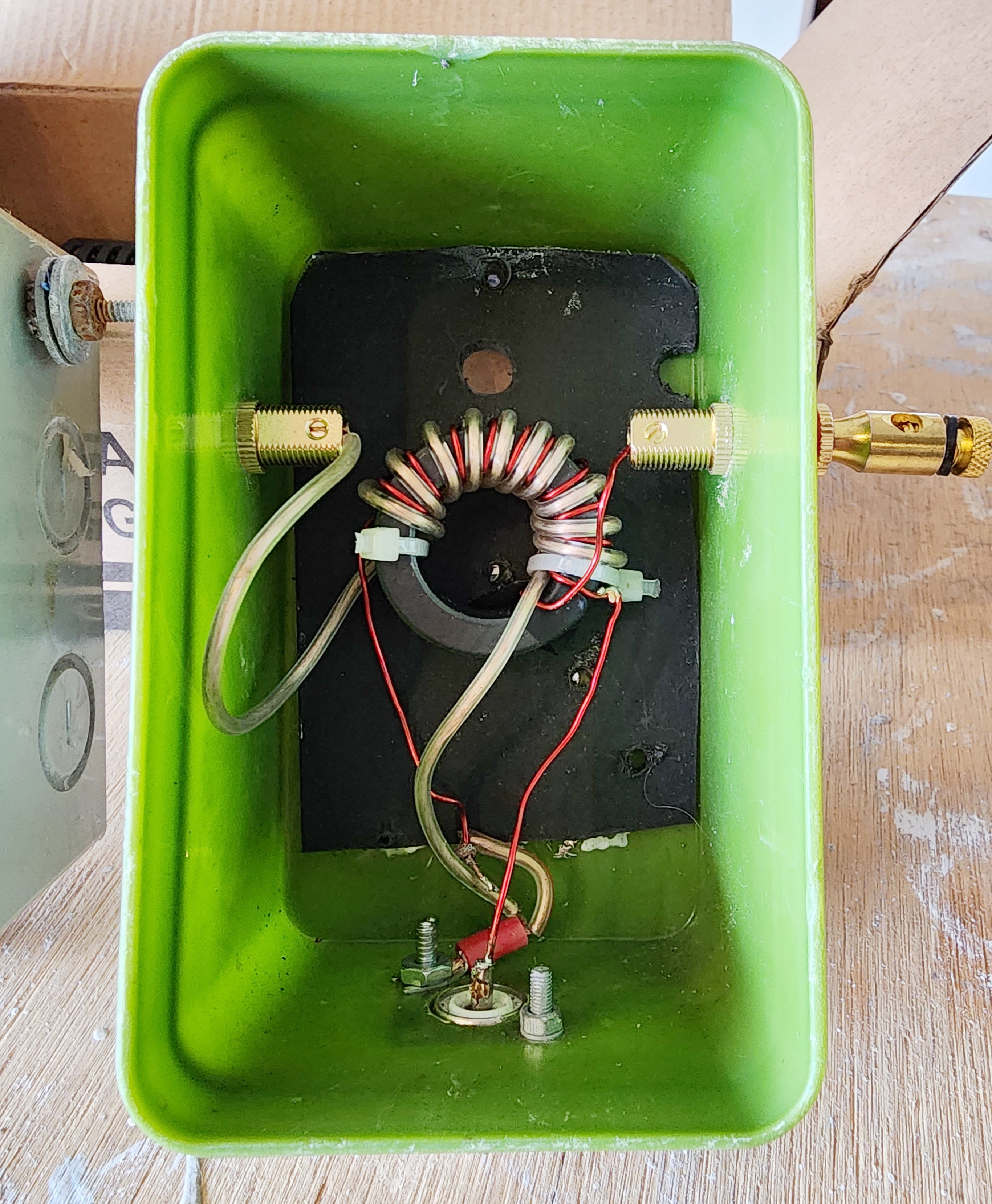

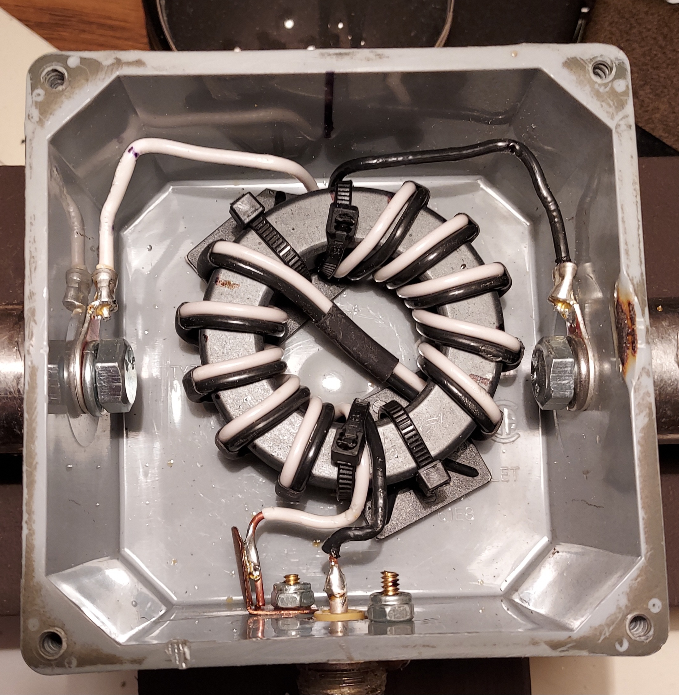

In the attached photos you'll see two different styled baluns, both 4:1 transformers.
I do not recall the mix of the two sleeved toroids; I built it 3 or 4 years ago to use for a low band 5:1 (it worked out being a 4:1) as the feedpoint transformer for a loop on the ground receive antenna. Conditions were bad and the experiment never got off the ground... pun intended. What I do know is it is actually a really good 4:1 starting with 20m going up through 6m.
The typical donut toroid is an FT140-61 4:1. It does a great job on 160 through 30m, but really quit transforming almost any at all to none above that range.
