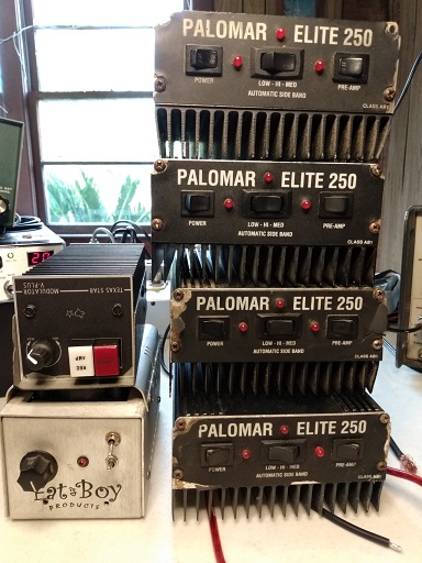

here is a stack of amplifiers I took to "repair"
I got two working after figuring out what the last guy did
to screwed them up even worse. I don't need this!!
Then gave the rest of them back.
