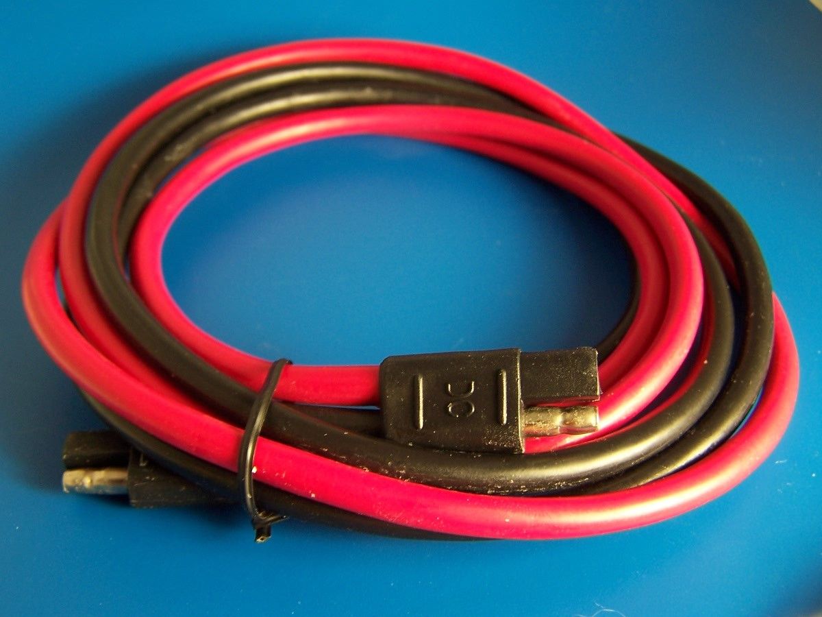

And stay away from these things: ( generic picture)
I have run across a lot of these that have 10 gauge leads on them, they heat up under even a moderate load and will start to melt.
I cut one apart, and the wire lead was simply inserted into the metal connector, and the plastic molded around it, not soldered, not crimped.
They will not carry what a 10 gauge wire will
Jeff

Audioshockwave I have that type of connector on my 257HP stock and now I'm wondering, Is it O.K.? I only run the stock power cable with no extension to a 36amp power supply. Should I cut this connector off and just go straight to the power supply with no connector? It does have a fuse in line on both Positive and negative and radio chassis and antenna are both grounded to a 6' copper ground rod.
