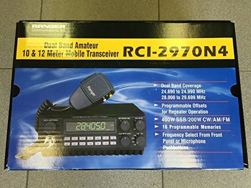

This is probably as pricey as it gets for a mass produced export.
https://images-na.ssl-images-amazon.com/images/I/517rWsNo1jL._SY400_.jpg
I have one of these done by Harddrive and it is everything I ever wanted in a radio. I get nothing but compliments on how great and clear I sound and yes it was expensive.

It is never a good idea to have an amp built into the bottom of your radio. This is especially true when the quality control and build quality of the radio does not match the price tag. Add in blacked out DEI bjt transistors and out of the bock 3rd order harmonics etc......If the amp goes out your out a radio and an amp while waiting for it to be repaired and if the radio goes again you are out two pieces of gear.
Can you say heat soaking parts? Heat is the enemy of electronics it is not like they are using 105C or 125C caps in those.
They would have to shrink the chassis and add a host of features you typically find in amateur radios.I would want name brand transistors or a move to rf specific MOSFETs or LDMOS. They would have to address that terribly noisy dual opamp front end they are so proud of.
Most shops want just under $800 for the RCI2970N4 and they are simply are not $800 worth of radio.
Having only seen the LC 998v on youtube I have no experience with it. That said what I have seen on yutube does not inspire me with confidence.$1299.00. I would love to see how long those last with an output power of 900watts! LOL If you watch enough of his video's you see that the rms versus pep numbers seldom work out right mathematically. You also see the 4:1 ratio broken constantly!

A good tech can fix that noisy dual opamp front end with a 2sc2999 and a few other parts. It's kind of fun using a radio that is commonly looked upon as being a turd that's had several of its inherent limitations overcome.

I do not have an issue with the RCI2950 or 2950DX I do have many issues with any radio that is a marginal black box that has had a marginal 4 transistor bjt amp built into to with substandard parts. If the parts are so shitty that you have to black out the OEM's name it is a worthless venture and you are tossing good money after bad!
Who looks down on the RCI2950 other than Amateur radio operators? The problems with that radio are all related to cheap parts being used.If the quality of the parts was at least as good as they where in 1990 ( no not perfect then either) the radio would be 3X times the radio that it is today. At the price they want for a 2970N4 they should be using parts at least as good as what was used in the early Uniden uPd858 chassis's. Let's face it Ranger/RCI has continued to take money out of the radio's it builds every place they can! The problem is that it has gotten to the point that the radio's are being drastically affected.
