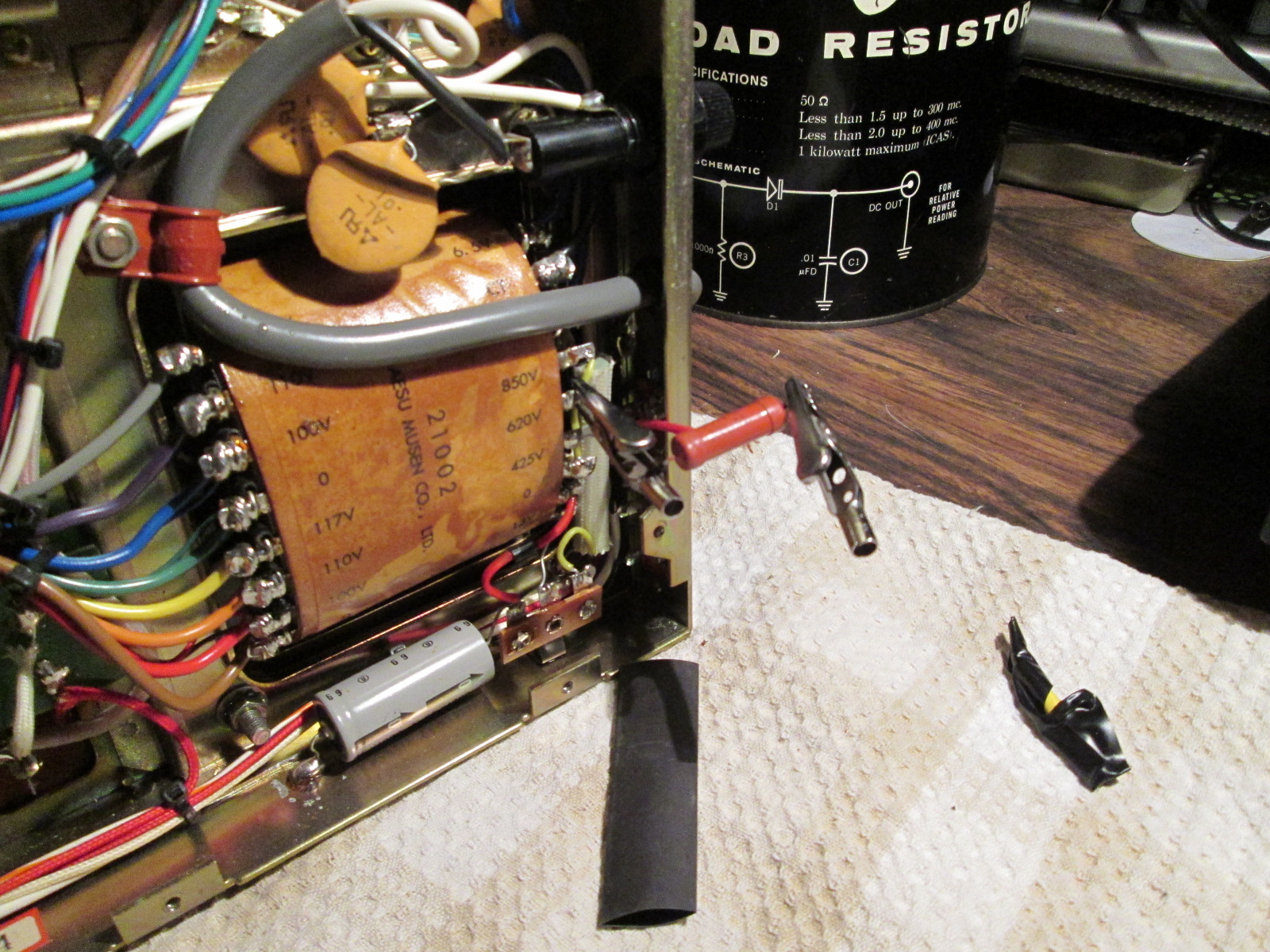

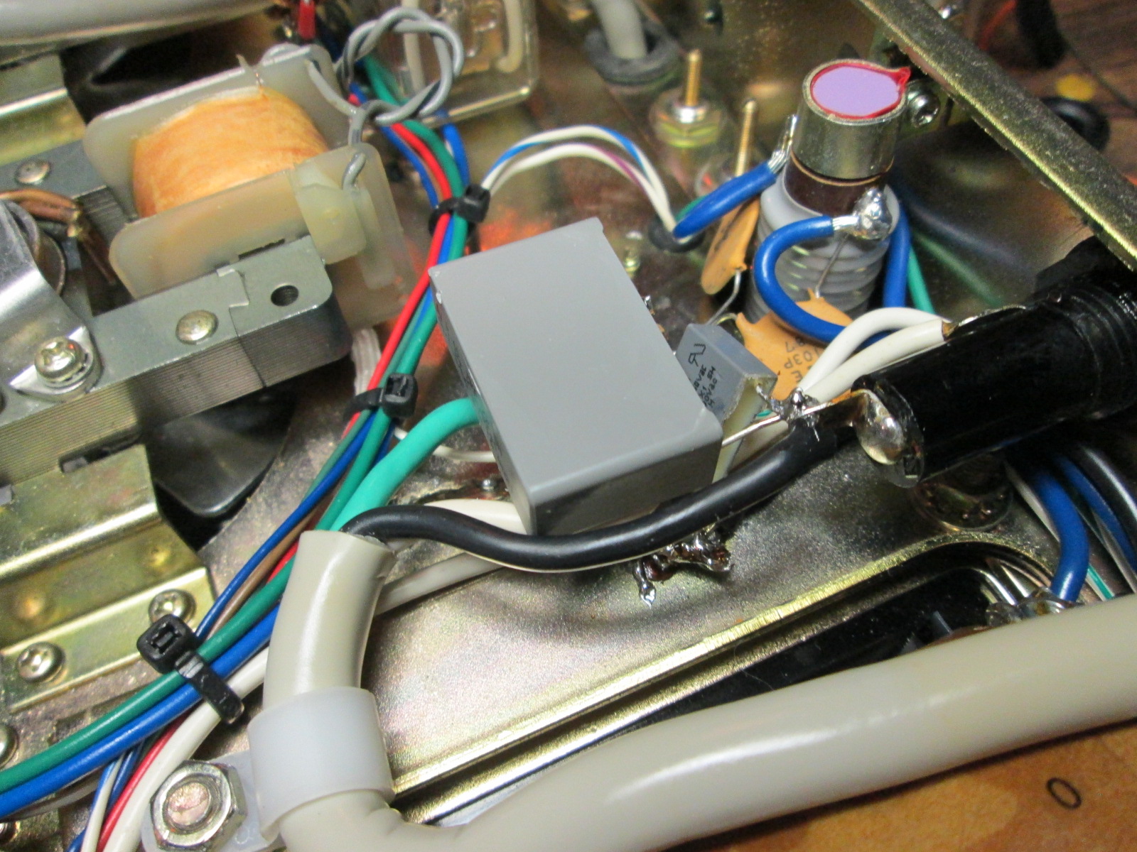

yes. I did on mine.
I put some new line filters too. THE FIRST 2 IMAGES SHOW THE OLD CORD
There was enough meat on the transformer bolt to add the strain relief and a 2nd nut
