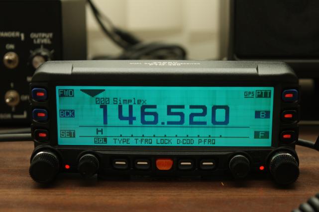

Yes you can; it's a setting in the Display Setup menu. Here's an example showing a single band displayed, and it works the same way if you're showing both bands:
Hi, I can't seem to find the setting in the Display Menu to make this change. Do you remember what it's called?
Thanks
That is the Enhanced Mode. Turn radio off, Press and hold the button to the left of the power button while turning the radio on. It is on page 13 of the FTM-350 operating manual.
I have set the enhanced mode "8 BAND SCOPE" to "SPECIAL", thats no problem, but how do I enable "Single-band" or "Mono-band" operation for the display? I cant find anything about that in the Operating Manual?
Single Band
I'm not at my radio, but I believe you hold down the BCK at mid-left in the frequency display screen.
