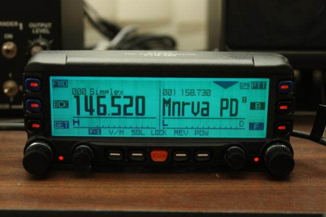

I wondered if it is possible for the display to show the frequency in the large font and the alpha tag in the smaller font above it?
One more follow up on this question. The setting to display either the alpha tag or the frequency as the main display is set uniquely for each VFO. In this example, I set the left side to display the frequency, but the right side to display the alpha tag. I thought some might like to see this.
