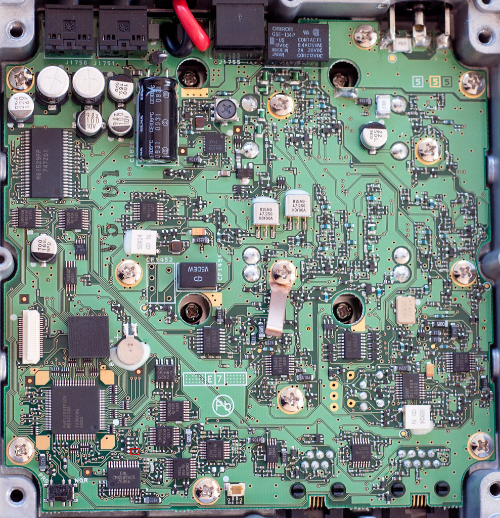

Hey @Moleculo and all - thanks for the info! I received my radio yesterday and did this quick mod first thing and it worked like a charm.
I took a before photo to share as some of my components have different part numbers, but essentially everything is the same it seems. No after pic as it's not too exciting of a difference :)
Hope this is possibly useful for someone! Click the photo to go to it's Flickr page, where you can find a higher res version if you want more detail (1580x1636px)
