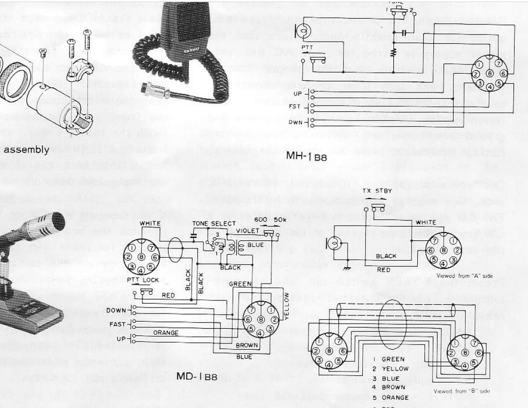

I have a Yaesu MD-100A8X Desktop Mic , I'd like to use it on my Yaesu FT-757GX II ? I bought a cord on ebay that was suppose to be able to match the mic to the radio , there's keyup but no audio . Has anyone else ever put an MD-100A8X on a FT-757GX II , how difficult would it be for me to get them to match up and work right together ?

You will need to supply power to the MD-100 externally.

I understand that , but doesn't the radio have a pin in it that should be already supplying power to the MD-100 , like they do with the stock mics ... and shouldn't the cord I bought already be wired properly between the radio and the mic so that they match up and work together ?

I believe you can open it up and apply +5v to pin 2 for those mics.

No. The older Yaesu HF radios used a dynamic mic, that does not require power. The MD-100 has a preamp/EQ that requires 5 VDC on pin 2, that is not provided by that radio.

Yaesu did a write up in the 90's, when the MD-100 came out, that would offer owners of radios that did not have 5V on pin 2. It was a dirty work around, but it works. I have not seen that write up in decades, but it was geared towards owners of FT-890, 990, 1000 etc. I modified my 990, to supply 5V on pin 2. You could easily bring pin 2 out of the mic plug to a 5V supply.
I ran that mic on my RCI 2950 years ago.
I got 12 volt positive and negative off the main board ran out the PA jack with small wires. Hooked up a 7805 voltage regulator in line for +5V. Made custom mic cord wired for all functions , even the channel/frequency up/down switch worked.
