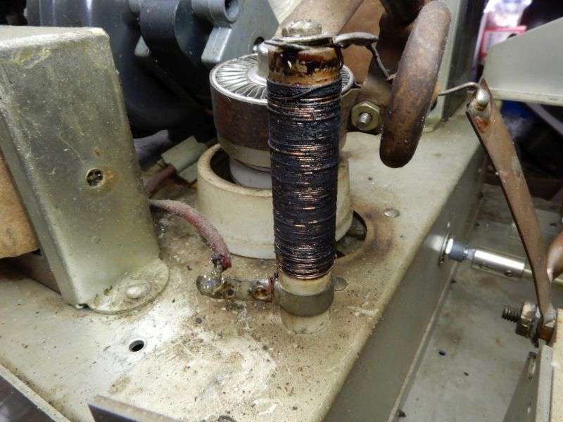

The relay board is dated 1977 in pencil.
It's kinda dirty, but that's to be expected. The burned plate choke is not so rare, but there's no bypass capacitor where the HV wire feeds into it at the bottom of the winding.
Makes me wonder if the missing cap has anything to do with the burned winding? Not a dumb trick I ever tried.

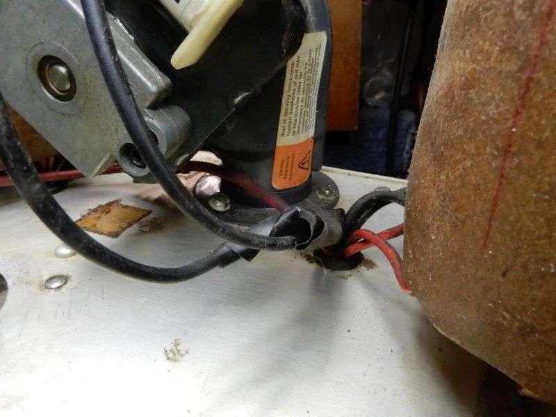

This gap was covered with black electrical tape. I'll need something more permanent to meet my standards.

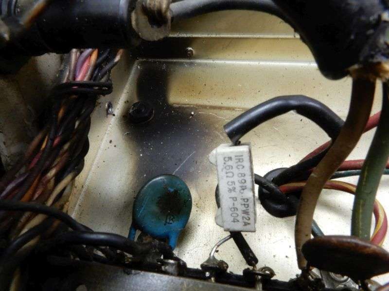

The blue disc cap is not original. It has been replaced, probably after the factory cap became a black smudge on the chassis surface. It's all too common for an amplifier to encounter at least one lightning surge from the power line in 48 or 49 years. The ceramic disc bypass cap does serve as a sort of demented surge limiter.

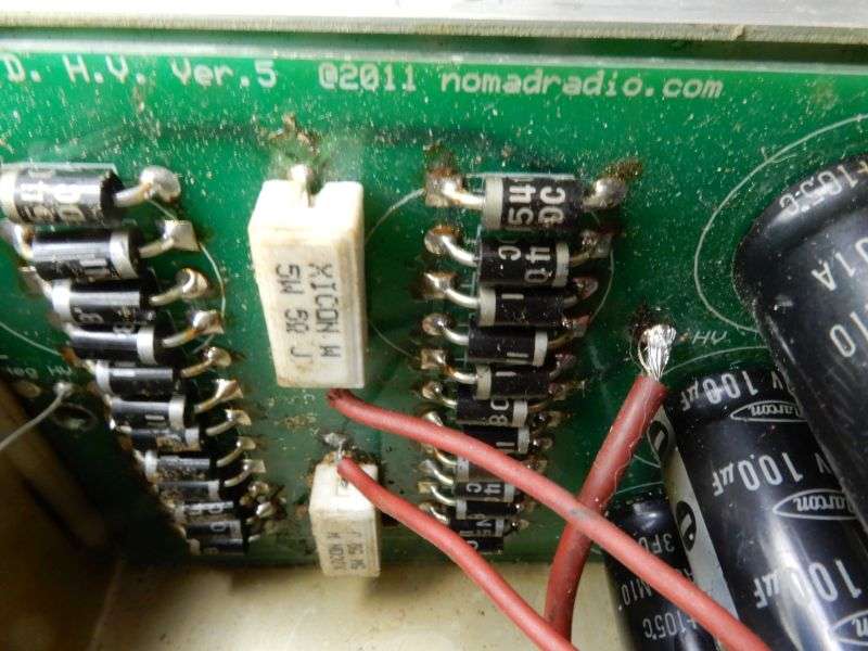

The white ceramic resistor is the one we used as a fuse to protect the small transformer decades ago.

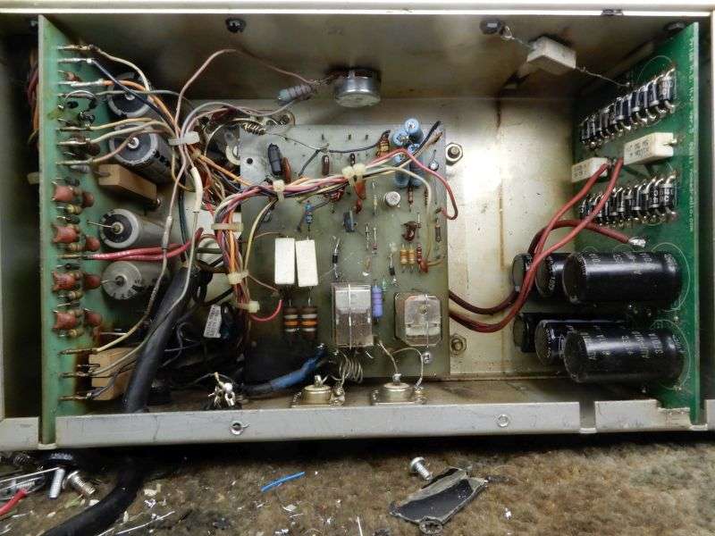

Sure enough, we rehabbed this amplifier about 15 years ago. Has our parts on the relay board, and our high-voltage board.
Must have been a low-mileage specimen in 2011, since the low-voltage power supply board is still original. And now the worse for wear. It will get upgraded this visit.

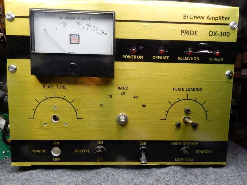

The center "band" knob on the front had already been converted to a "rollback" or carrier-control knob. Turning the control-grid bias below cutoff lets you reduce the carrier to a safe level even if your radio doesn't have that knob on it. Even a small radio drives this tube pretty hard, so you don't lose modulated peak power, just the carrier. One less detail on the list.
It's gonna need some cosmetic attention. Lucky for me I know a guy who produces new face decals.

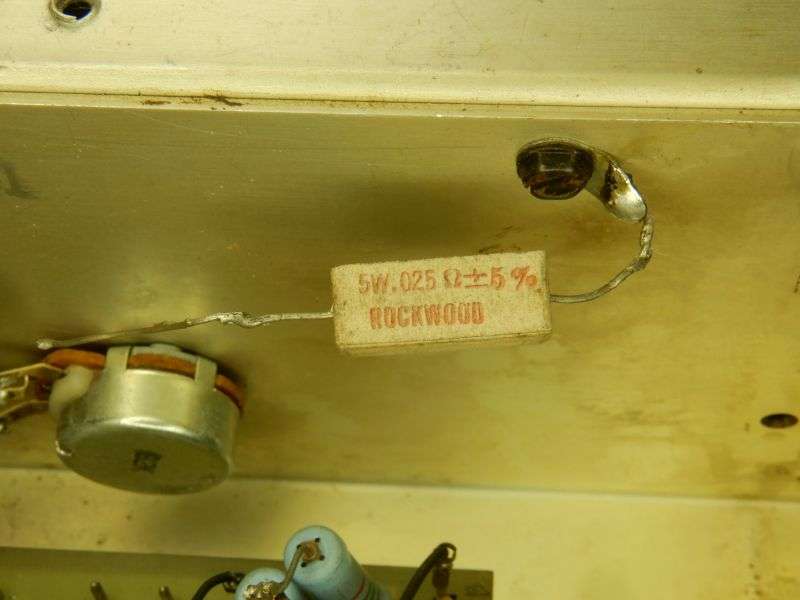

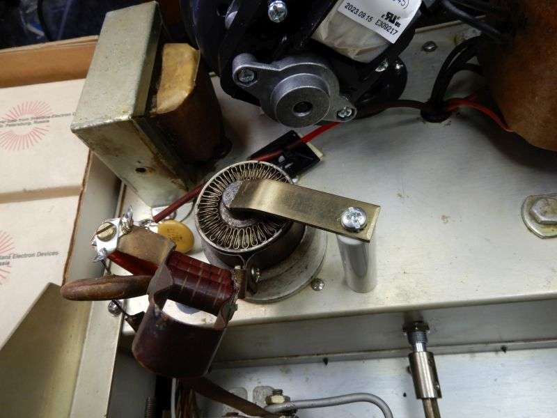

Definitely had someone using a radio that was too big sometime since 2011. This resistor is 5 ohms when we install it. Found that it will open up like a fuse if you drive it with a Saturn, a 2517 or similar two-final radio. This zero-point zero two five ohm part should serve as a "no-blow" fuse.
Got in the habit of calling the 5-ohm 5-Watt resistor the "Saturn fuse". Typically blows before the tube. Not always, just usually.

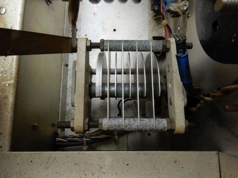

There's some crustiness on the plate tune capacitor, but that's cureable with air-conditioner coil cleaner. Really shines up non-ferrous metal surfaces.
This one cleaned up just fine.

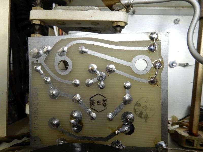

The circuit board behind the meter is AWOL. The coaxes that feed into and back out are just solder-spliced together. Turns out RF Parts had that board to sell me, so I won't need to build one.

The rebuild continues. Whoever installed the new blower wasn't too slick getting it hooked up.
Not a big deal, just another detail.

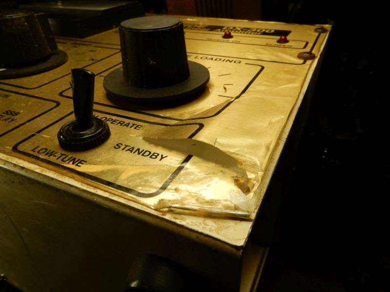

The new face sticker is an improvement, but it serves to prove body work is not my life's calling. I'll try some super glue on the rough spots where it kinked between the preamp and screen LEDs.

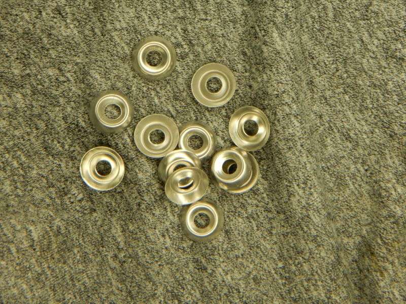

The four screws have trim washers under them. The originals were rusty, but it turns out the local hardware store has them. And in stainless, no less.

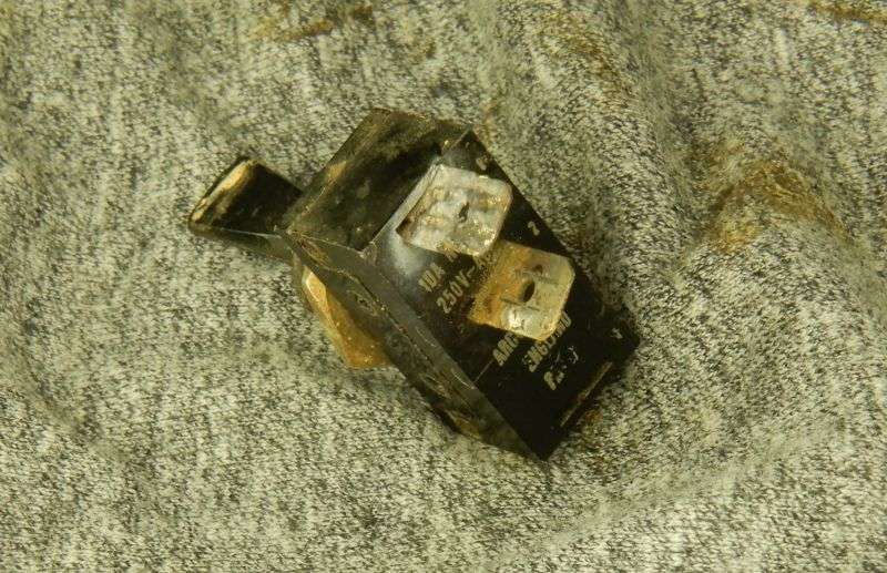

The power switch won't be getting reused.
The replacement has a metal bat handle, not the black plastic paddle. But it's rated at 20 Amps. This one says ten.

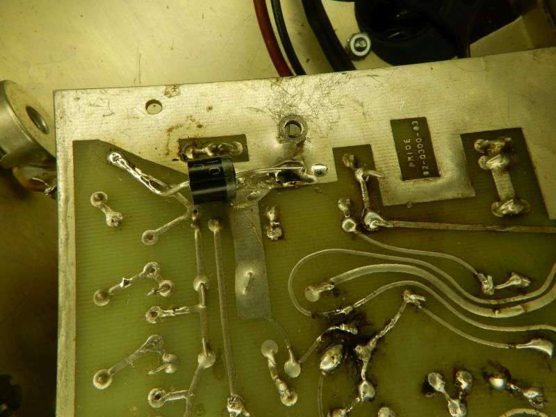

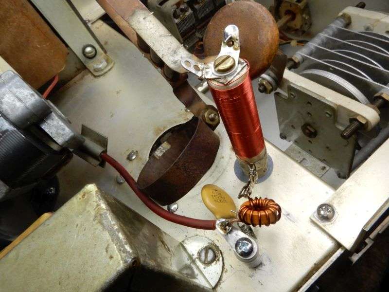

Here's an upgrade we made standard a while back. This is a 6 Amp 1kV rectifier diode. It's wired from the control-grid bias RF choke to ground. Kinda like the reverse-polarity protection diode across the DC power input to a mobile radio. Does nothing so long as the polarity is correct. Acts like a dead short if it's backwards. When a tube arcs over inside, a positive DC voltage comes shooting out of the tube's grid pin into the negative-polarity bias circuit. This diode does nothing until that spike of positive DC comes along. Serves to protect the bias control, L14 and whatnot. The bias pot is a famous point of failure in the original design. It's attached to the foil trace under the front-most end of L14.
I really prefer for the amplifier to survive a tube fault without damage.

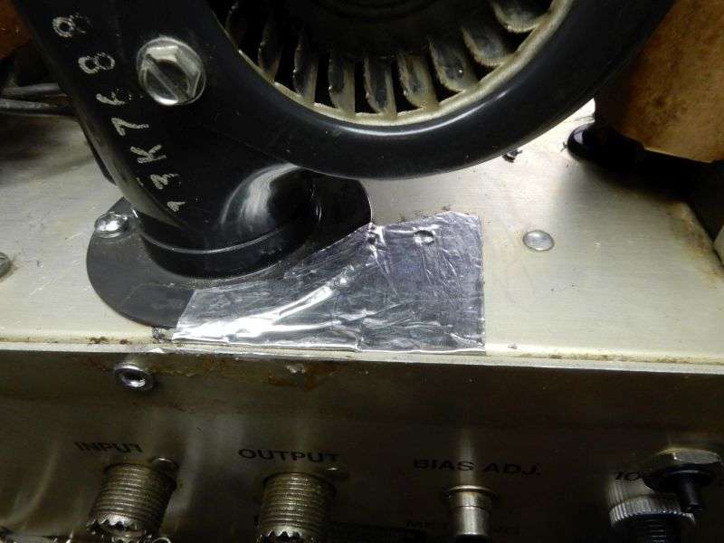

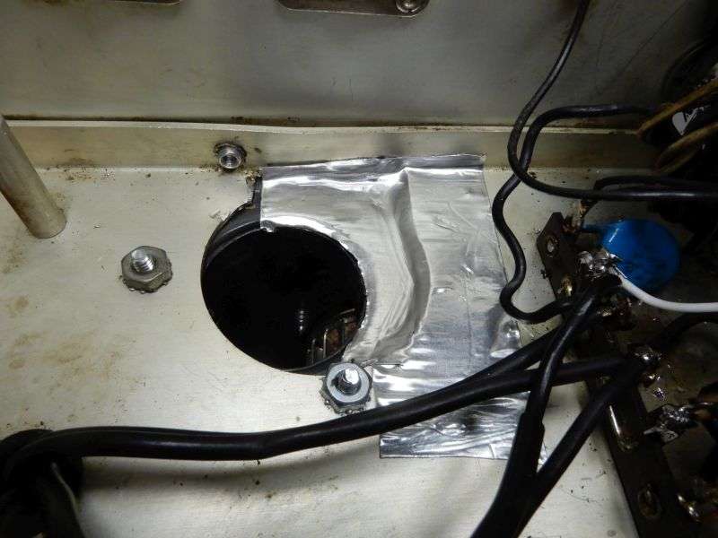

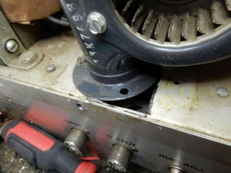

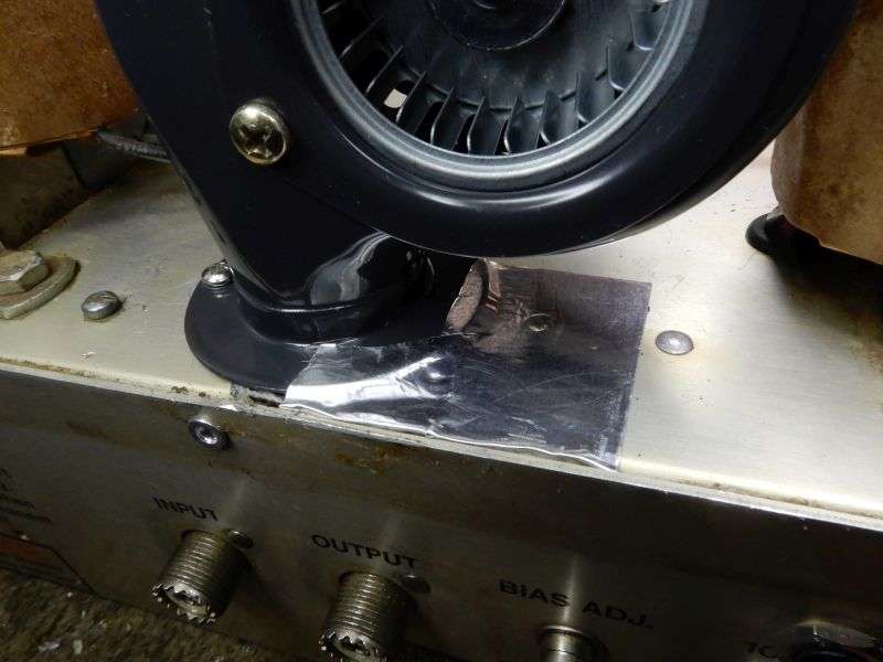

I copped out and skipped fabbing a metal plate to plug the gap around the blower outlet.
This stuff is fairly thick aluminum foil with an aggressive adhesive. Burnish it and it won't come away on its own.
Better than the hunk of black electrical tape I found here.

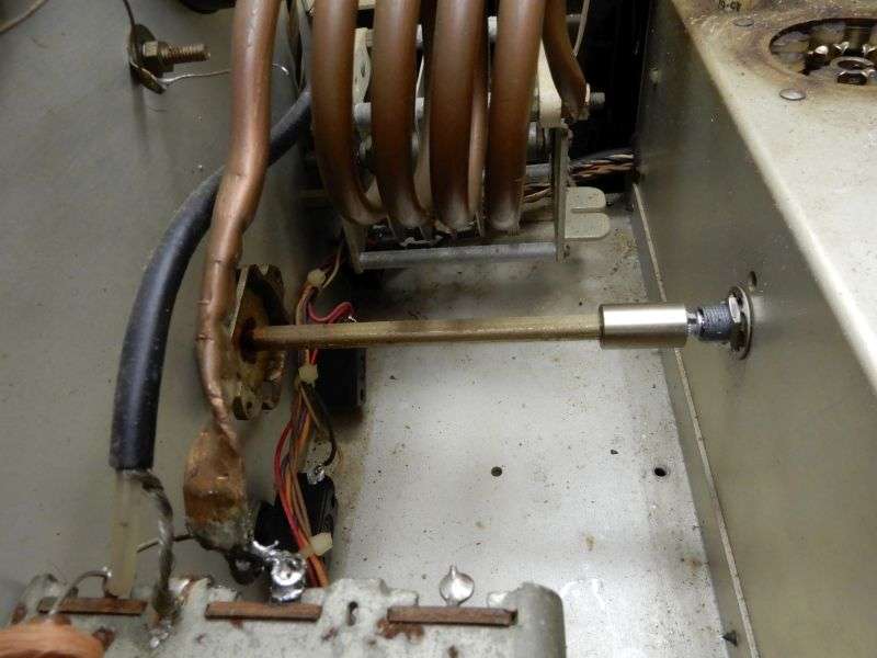

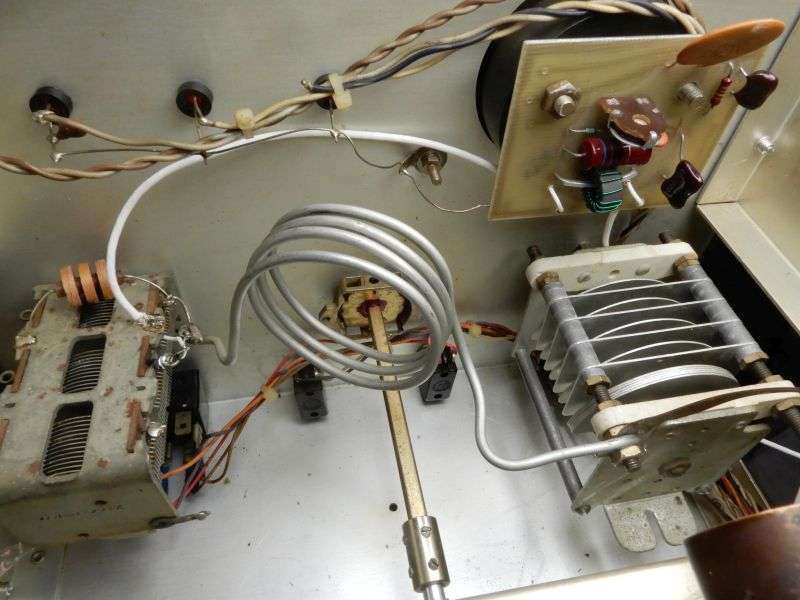

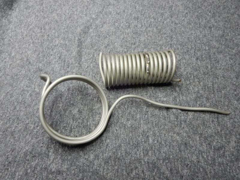

The pi-network tank coil it came with did not appeal to me. I have lots of D&A plated copper tubing. Removing the bogus ham-band coverage and band selector improves reliability in a Phantom or Maverick.
And EET'S ALIYEEEV!

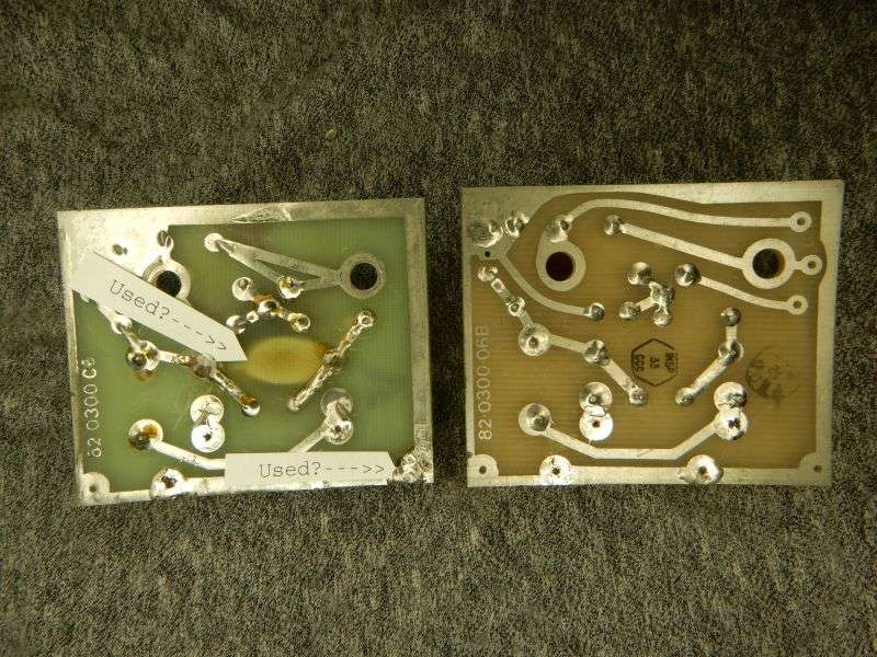

Just one problem. Puts out power, but the front-panel meter is totally dead. Won't budge when it's putting out good power.
Turns out I missed a detail when comparing the two meter boards from RF Parts.
Clearly they're not exactly the same. The one on the left appears to have been removed from an amplifier with mileage. The one on the right is clearly new and unused. But the part number on the left is not exactly the same. Turns out the new one is for a KW-one model. The part number on the left edge of each board has a different suffix letter. The DX300 has only the wattmeter function. The KW-One is switchable between RF power and plate current. Sure enough, I needed a couple of jumper wires to take the place of the RF/Plate current switch.
Hey hey, the meter works, now that it's connected to the wattmeter circuit.

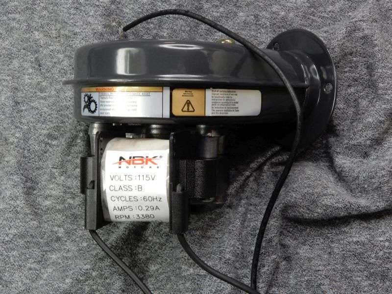

After running for about a half hour, the blower developed a rattle sound. Didn't matter what caused it. I had bought blowers for this project and have them on hand. The new one is quieter.
Came from Amazon.
Copped out and skipped making a metal bracket to cover the gap around the flange. The adhesive foil tape won't come loose.

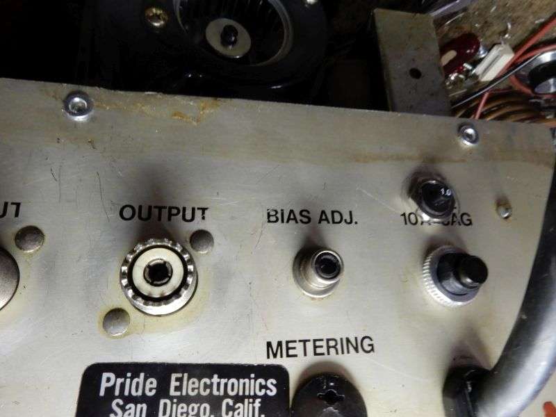

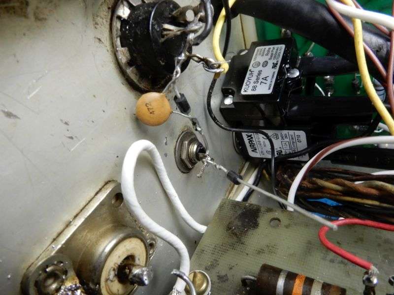

Since the bias control is now located at the "band" knob on the front panel, this hole on the back is available. I'm fond of having a "hard key" jack, like a real ham linear. Anyone who wants to use it on sideband should either get a foot switch or put a relay in the radio to key it with a patch cord. Never cared for the "SSB" switch delay method. Too much relay clatter for me. This also simplifies setting bias for sideband. Gotta key it with no drive to do that.

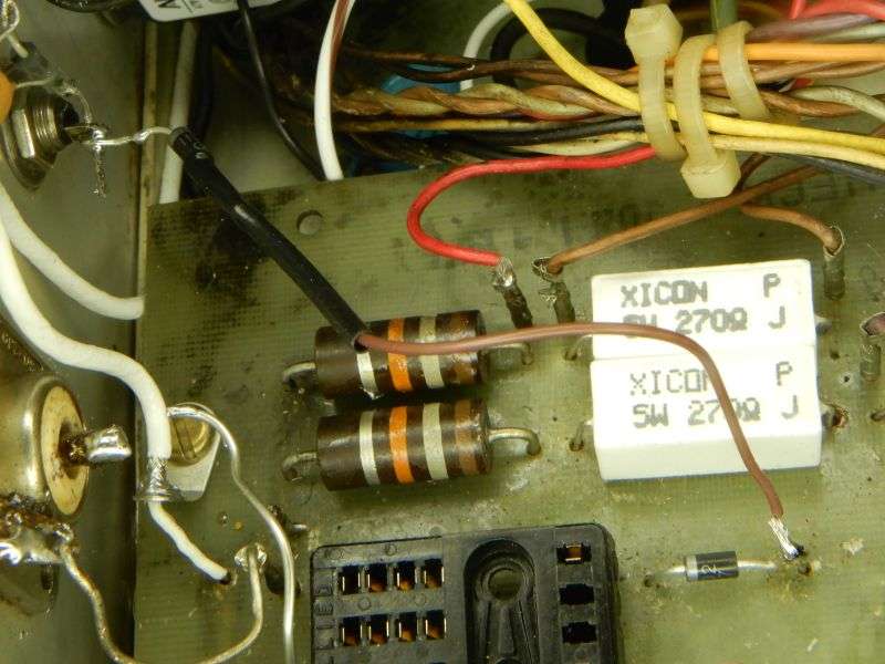

Maybe I'm paranoid, maybe I'm just over cautious. I install two diodes on a hard-key jack. The one with the bypass disc cap is grounded to the meter jack's black wire. It's there for reverse-polarity protection. If the other end of your patch cord was plugged into, say, a Heathkit SB200, you would have negative 100 Volts DC feeding into the 12-Volt keying circuit. Bad juju. Just like the reverse-polarity "protection" diode in a mobile radio, it will conduct if negative DC gets accidentally fed into this jack. And it will key the SB200, if that's what happened. The other diode is there for a positive DC voltage. Anything higher than about 15 Volts will reverse-bias this diode, and block any unwanted current flow into the Pride's relay circuit. Like would happen if the far end of the patch cable was plugged into a Heathkit SB220. Better safe than sorry. Cheap insurance. Might not be visually clear, but the banded end of both diodes go to the center pin of the keying jack.

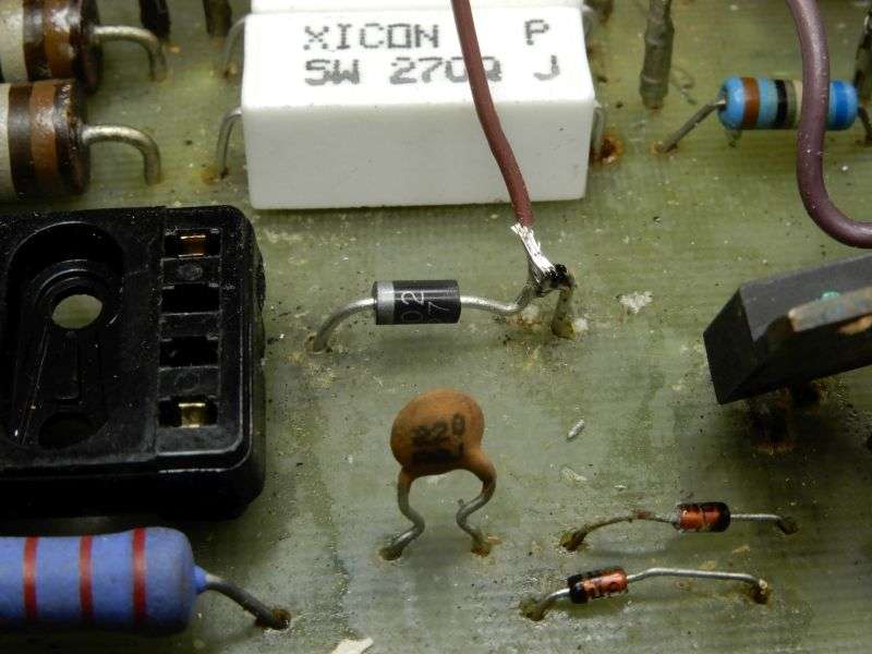

The brown wire lap-soldered to the anode (front) end of the relay's spike diode D30.

I've found the easiest way to install the new face is. Hold it on the far left and right sides. Shoot for lining up the LED holes. Then the rest should fall in place. There is a little wiggle room on the switch holes. Due to the nuts.
Also a light spray of water from an old Windex bottle will let you move it around a little easier. However I've found it harder to get to bubbles out when sprayed.
Fold the top and bottom of new decal over. Loosen bottom rubber so the edge will go under it slightly. Then with a new razor blade trim the left and right sides.

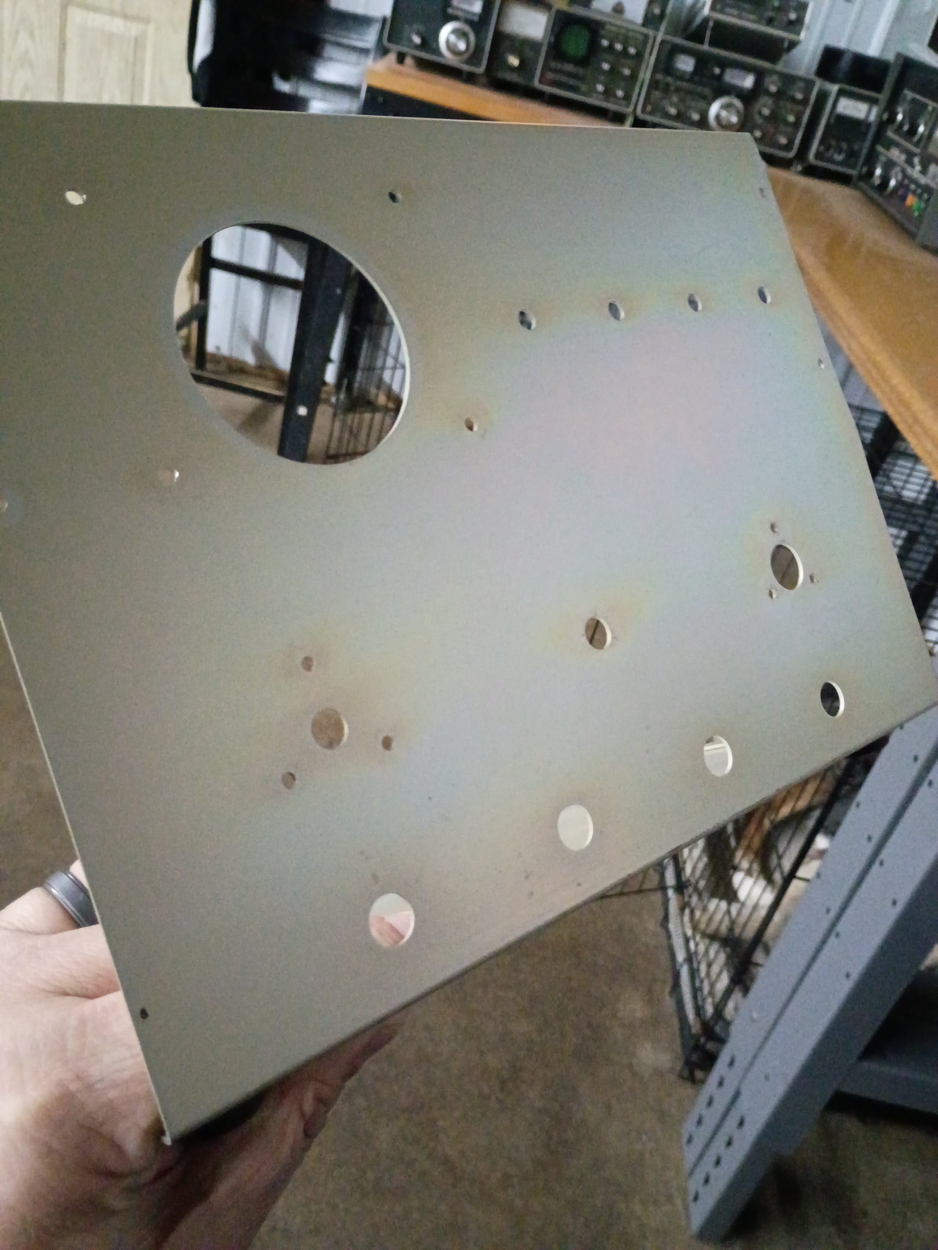

For a dx300 under extension repair it's easier to remove the entire front.

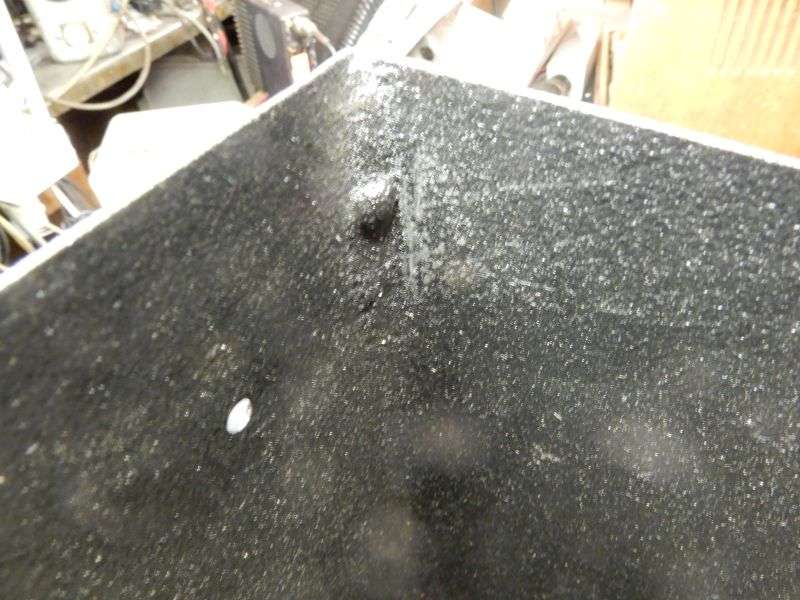

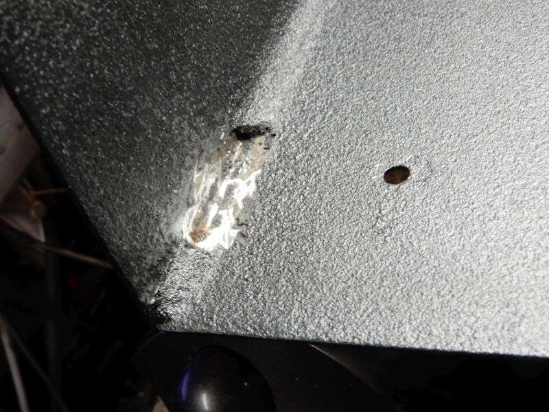

As Roseanne Rosannadanna would say, "It's always somethin'". A friend generously offered to powder coat a DX300 top cover. Seems appropriate for an amplifier with an asking price around a kilobuck. Just one problem The powder softens and sags when heated. It filled the upper right corner. Made the cover ride up over the left side of the front panel. Screw holes would not line up.
Turns out it's hard to get good focus without enough light. Oops.
But scraping it off fixes the problem. Dremel to the rescue. Next time I'll suggest letting it cure right side up. Should make it sag away from the upper corners. This one clearly got cured downside-up.
Now the screw holes line up.

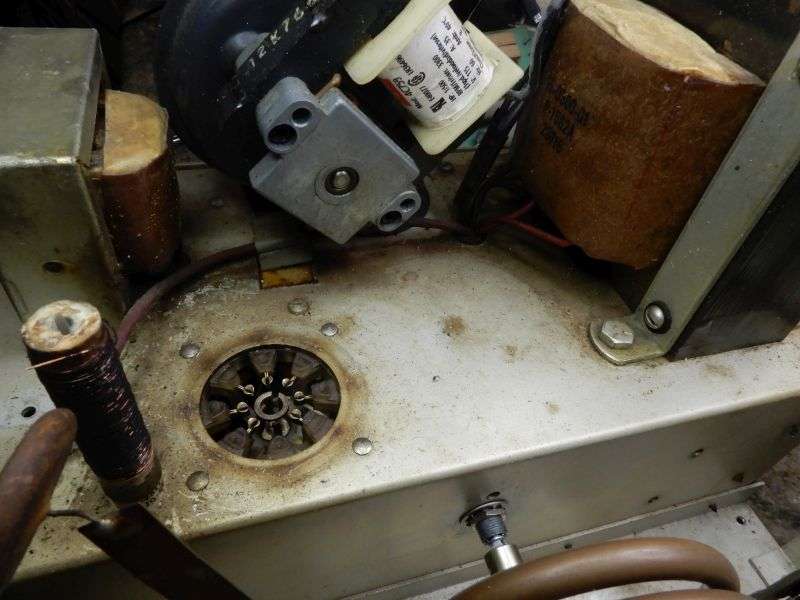

One more detail. More than once a customer got one of these home and reported no output. Turned out the pushing the tube back into the socket was all it needed. The socket has very little retention force, and the tube is kinda top heavy. Wants to rock off center with any jostling at all.
Not this time.
Gonna make this a standard upgrade item the next derelict we restore.
