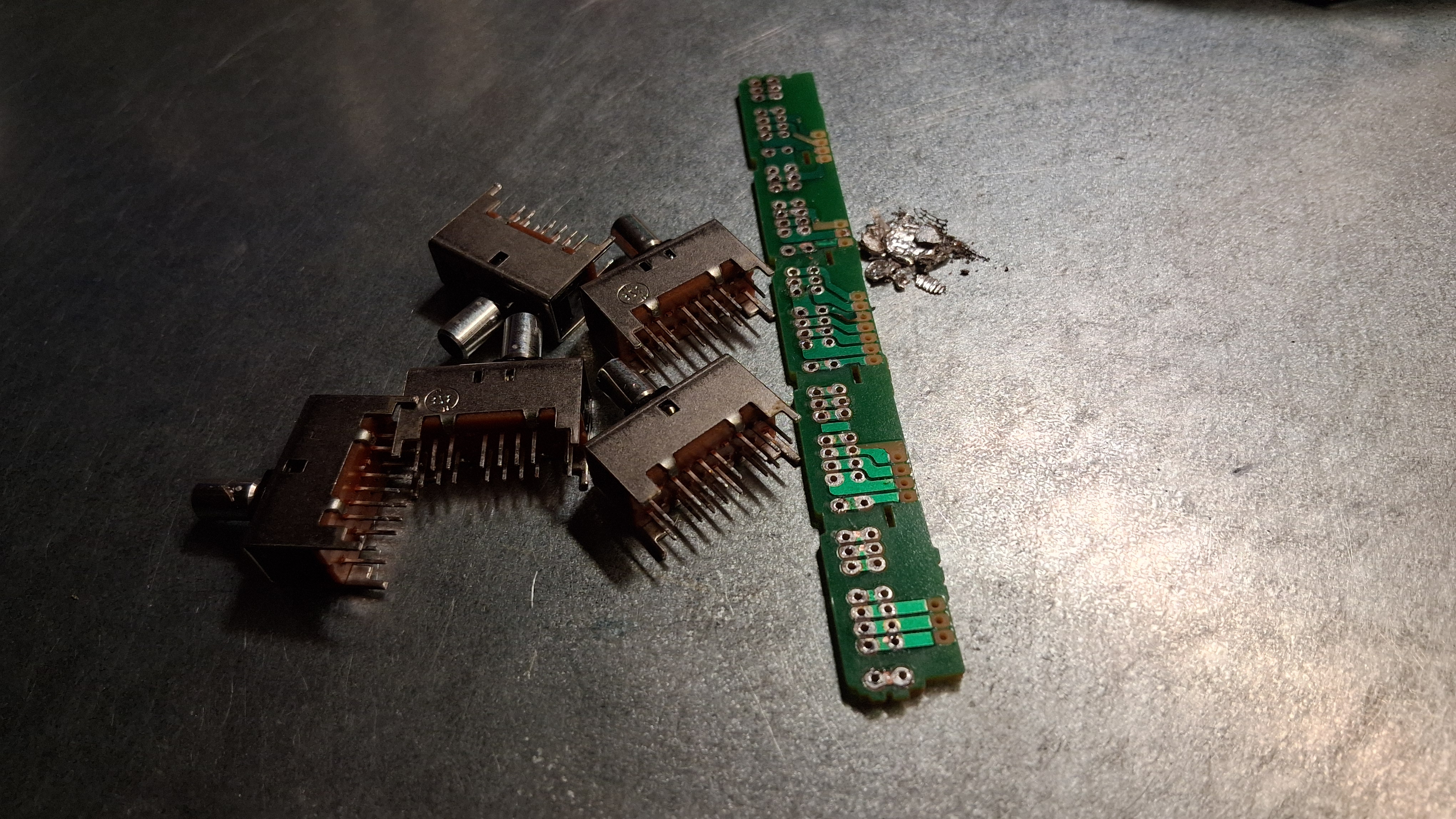

Pulled some galaxy switches that would have normally been thrown away.

Nice job! Don't see a lot of foil-pad damage. We had one of those. Daily use will grind it down faster than a Hakko, but if you only use it on weekends, it should last a fair while if cared for. Kinda like power tools from Horrible Fright. At one-third the price of a Hakko, it can last one-third as long and pay for itself. And if it lasts longer than that, you got a better deal than the more-expensive choice would have been.

Thanks! I don't run a repair shop, its just for hobby stuff and parts salvaging so I really hope it lasts a few years.
