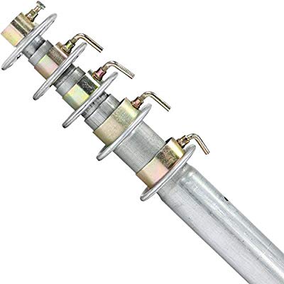

I am curious how you have it attached to the tree. I have a couple BIG Douglas fir trees I have been thinking about using. Just not sure how to go about it.
The push-up pole has eyelets to attach guy wire. I have three short guy wires attached around three large tree trunks of the tree about twenty feet up in the tree. Nothing fancy but it's solid and been up about 20 years. I had bought the push-up pole from radio shack. It's similar to this one, telescoping.
