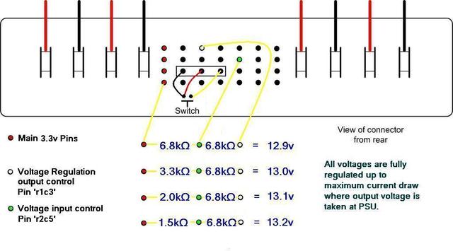

I have the hp 1300w psu and i saw the diagram but im not sure how to wire de resistor to get higher voltage.
Is there someone who has a real pic of the back psu?

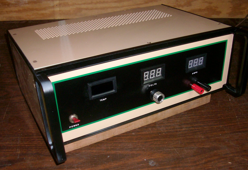

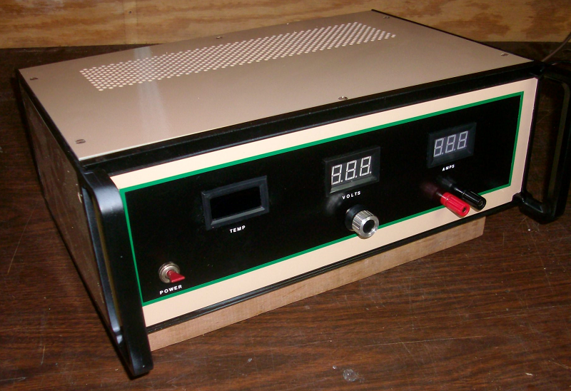

project completed

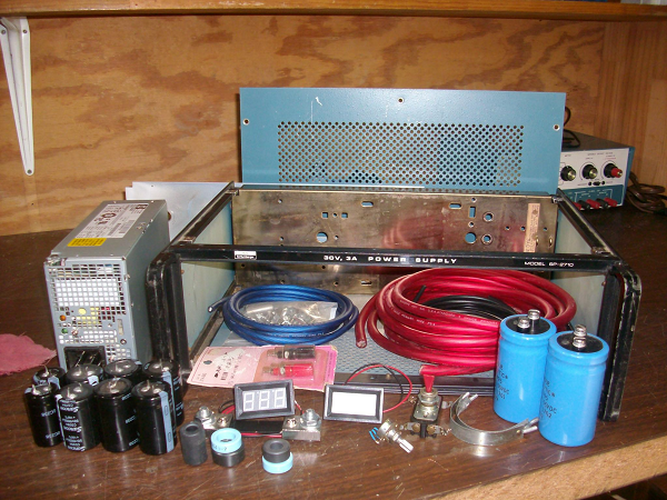

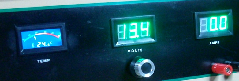

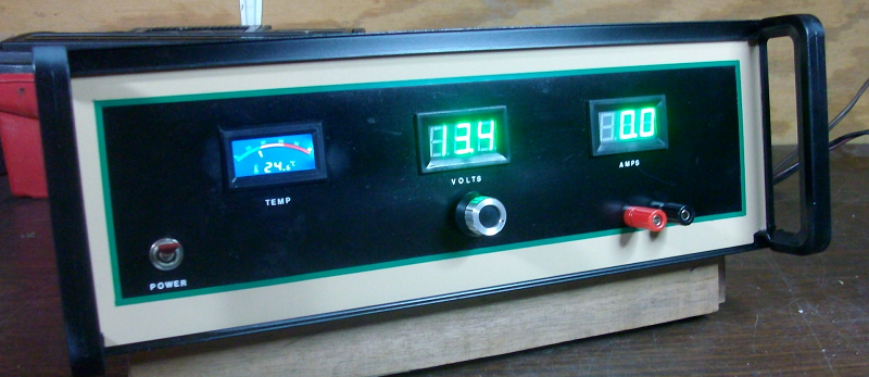

Finished the build on my 100 amp supply last night. Tested it under load (my Kenwood TS430S) and everything works fine. All that is left to do now, is to dress up the wiring to the faceplate and get the 220 vac line cord I ordered from the HP distributor in Medellin. This was a fun project, and the result is that I now have a reliable, high-quality 100+ amp supply for less than $80 USD invested. Admittedly, many of the parts I used were scavenged from stuff I had laying around, but even after factoring this in, the total investment is only $120 or so.
As Robb pointed out, the BIG drawback with the HP supply is the fan noise. There are two 11,000 rpm turbo fans in these units, and when they're running it sounds like you're right under the approach to LA International. Removing them and mounting an external fan won't work because the supply won't power up without them. The only solution I can find is to mount a 10 ohm/2 watt resistor in the power lead to each fan. It's still noisy, but it's acceptable. If I had it to do over, I would use a 120 amp Dell EDGE supply that has output voltage up to 15.4, and external fan speed control.

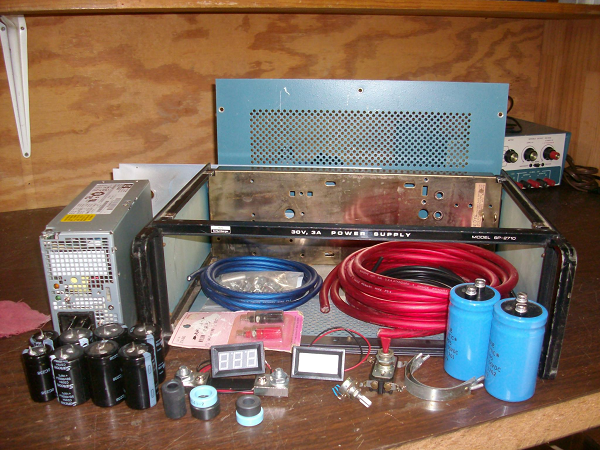

Anyway, I started out with this:
And ... here's the final result:
I will post some pics of the inside as well as a wiring diagram on my user page album later this week. 73s, and thanks to everyone who posted info on this thread.

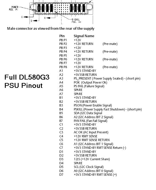

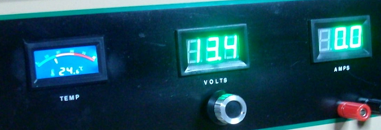

Do you have a wiring diagram of the volt and amp gauges please?
Instead of using pin D3 use D2(ground)? And connect the pot directly to the pins?
For regulating the voltage,is this possible??

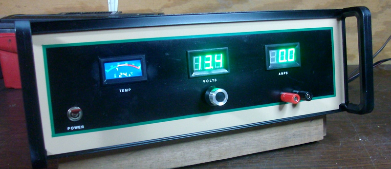

project completed

I took the fan out of the unit I have, and added a rotron "Whisper Fan" inside the cabinet blowing directly into the PSU. Built a separator between the PSU and the cabinet to seal things off and prevent hot are from recirculating inside the cabinet. After I originally published the photos of the competed unit, I used it for quite a while, but got VERY tired of the fan noise. Another drawback was that the current limiting resistors I used to slow down the fans generated a lot of heat. So I tore the supply down, and removed the stock fan assemblies. Built a 360hz oscillator to fool the PSU into thinking the fans were running. I had to relocate almost everything in the cabinet. But now the unit is quiet and cool running. A lot of work, but worth it.
I run a 1 into 4 amp, and get a solid 800 watts peak on SSB in the high position (Almost always run it on Low though.) The supply voltage drops maybe 0.1 volts under full load. Highest ever reading on the temp gauge was 28.6 C. I gave some consideration to getting a Dell PSU, but the HP I have works so well that that I passed on the Dell.
