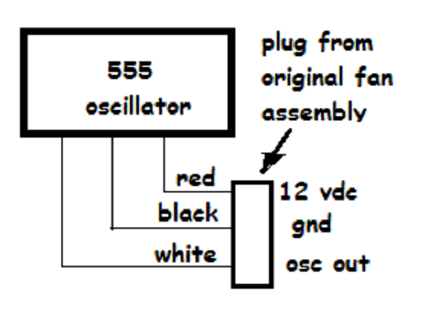

When the supply is used in a mainframe, it runs continuously at full output and needs a lot of cooling. Intermittent use (like powering a radio or linear) requires much less cooling. I removed the original fan assembly, and installed a slower (quieter) one. The supply has a circuit to detect whether the fan is running, so I built a 555 oscillator @ 360 hz and connected it an shown.

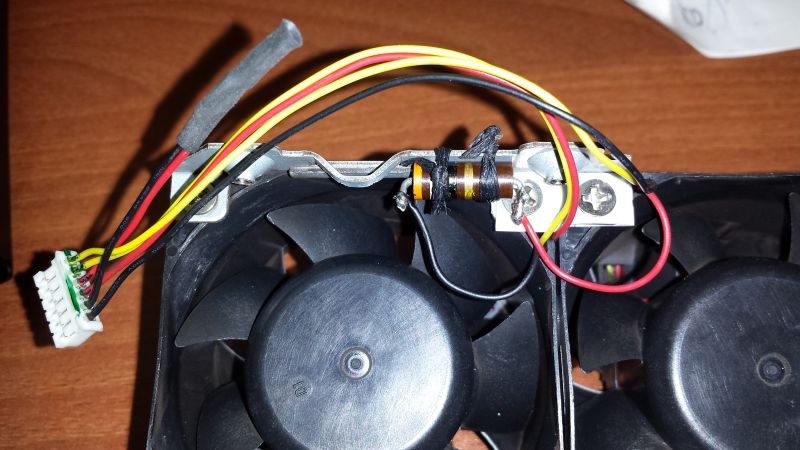

Here's what I'm trying to reduce the fan noise.
Snip the red wire from one fan and the black from the other. Place a 39 ohm 1W resistor between the lines going to the fans and heat shrink the other ends. Do not connect these wires together! They are just covered with the same piece of heat shrink.
Instead of 12V to each fan, they operate at less than half voltage, about 140mA current through each in series. The resistor is in the air flow from one of the fans to ensure it remains well cooled.
There is considerably less noise compared to the original screaming fans!
