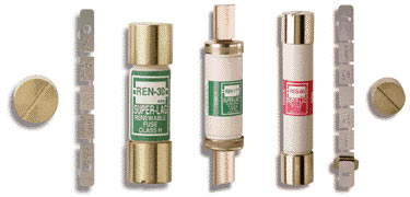

That sucks, I prefer reusable fuses :tongue:
Don't laugh. There are such things as renewable fuses. Having worked in an industry for 22 years where we used renewable fuses a little bit it just comes natural for me to sometimes refer to regular fuses as "one-time fuses" as opposed to "renewable fuses". The renewable type allow you to keep the same cartridge base but replace the fuse element itself.
Cartridge fuses with renewable elements.
