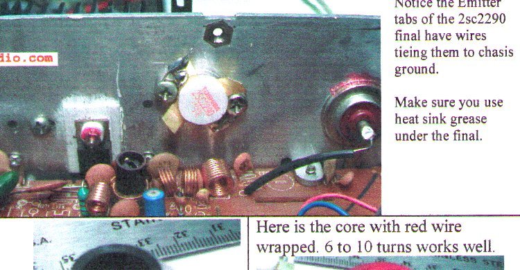

Years back there was a site on the internet that showed how to remove the final on a galaxy/connex and replace it with a 2sc 2290. Did anyone happen to save that info? It does not seem to show up anymore.

Here is all that I came up with was a part of a listing that someone copied and then sold on e bay. You did not have any other pictures of the finished job by any chance?
Low Boy I just finished going through all my saved items and do not have any thing else.since I never really tried this mod since it was so costly I guess I did not even save any more than the one page I had.

Low Boy that was so long ago. I think I only got about 60 watts out of it. was not real crazy with the mod so never tried it again. I was getting about 30 to 35 out of the radio I did it on and not much of an increase. easier just to put a KL203 amp on the radio.
