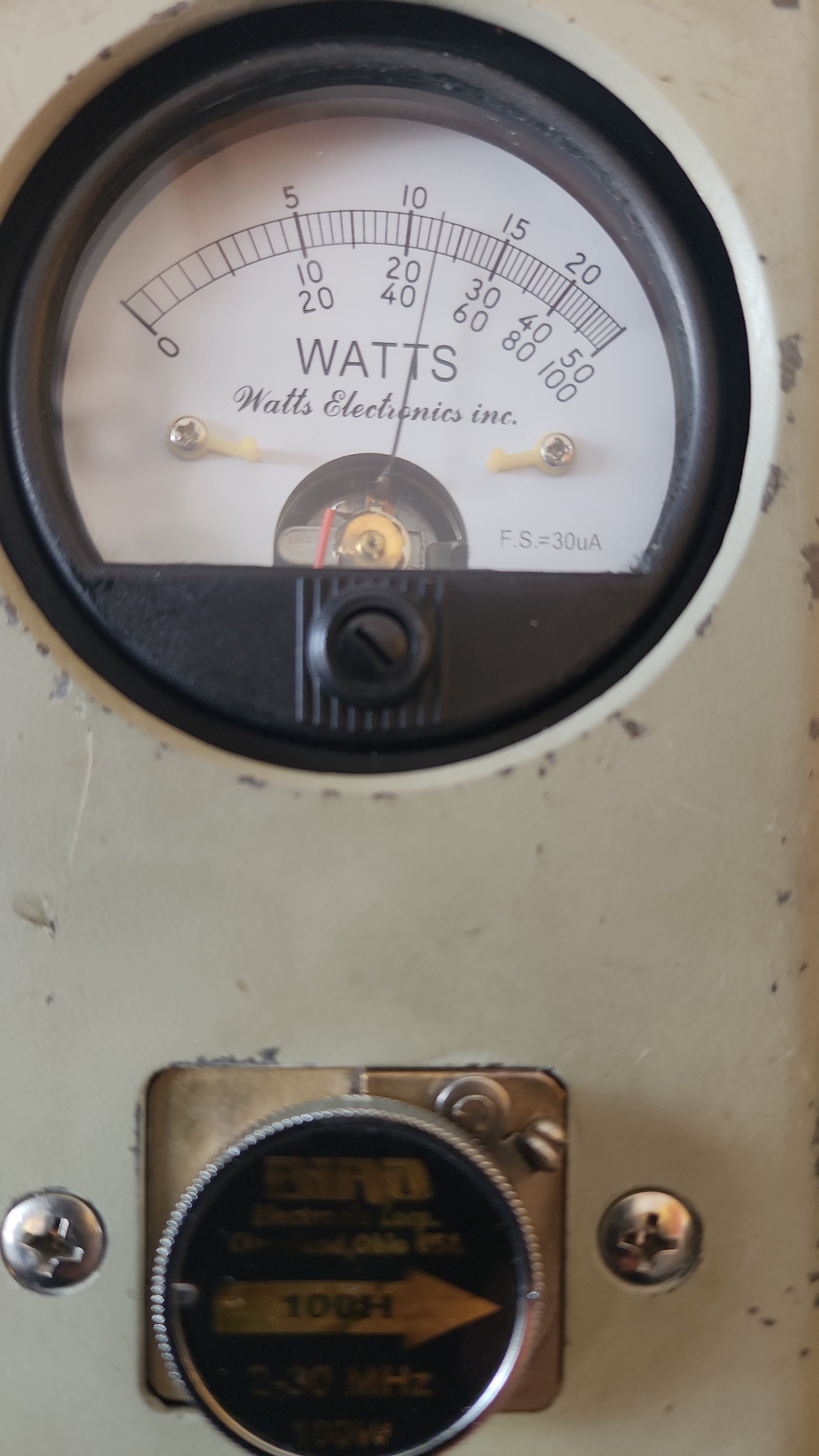

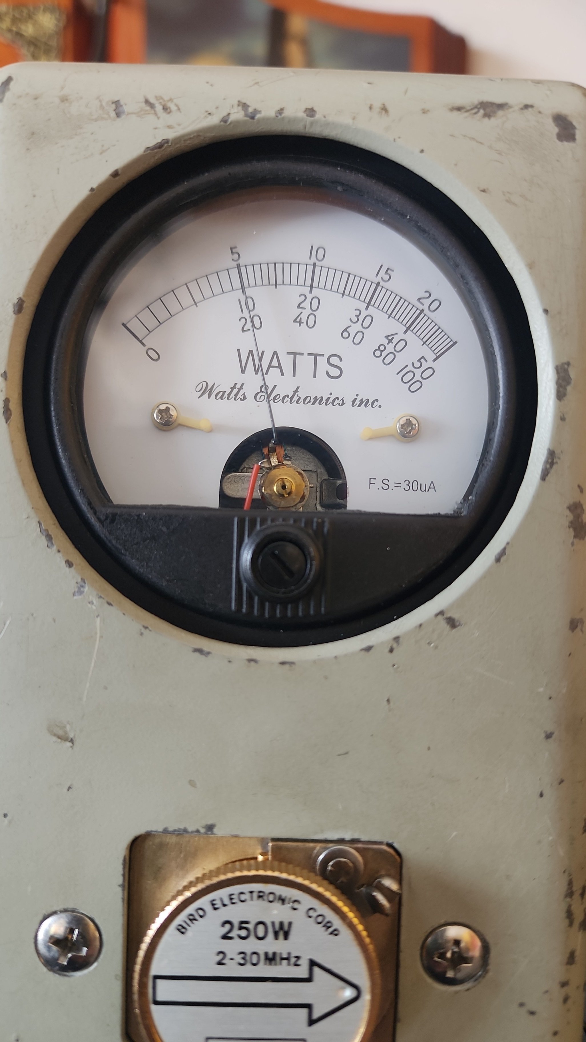

is this where the +5 -5 % comes in? 50 watts on the 250 slug and 46 on the 100 slug

Here is my view on meters. All have a +/- factor to some degree, but some are more accurate than others. The important part is to match the scale as close as you can to the output. Reading 100 watts on a 200 watt scale will be more accurate than 1000 or 2000 watt scale. If you were anticipating 450 watts with an amp but are using a 1000 watt meter, your reading won't be very accurate no matter who made the meter. The closer your wattage is to the top end on the scale, the more accurate it will be. As for your pics I would expect the higher reading to be on the lower scale. But that's just my experience with meters.

The accuracy is based on the full scale reading. If you have a 100 watt slug the meter will read 100 watts at full scale however if the accuracy is +/- 5% then you can expect to see anything from 95 watts to 105 watts when hitting it with exactly 100 watts. If you put that same 100 watts thru a 500 watt slug you can expect to anything from 75 watts to 125 watts. This is why it is always best to have the meter reading as close to full scale as possible.
What Captn Kilowatt said about using full scale readings is true with just about any good meter out there. This is why other type meters like analog needle have different power scales. The most accurate (or close enough) reading should be when the power measuring is at least 3/4 scale or more towards the max of the scale on a true peak reading meter.
